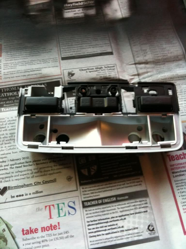

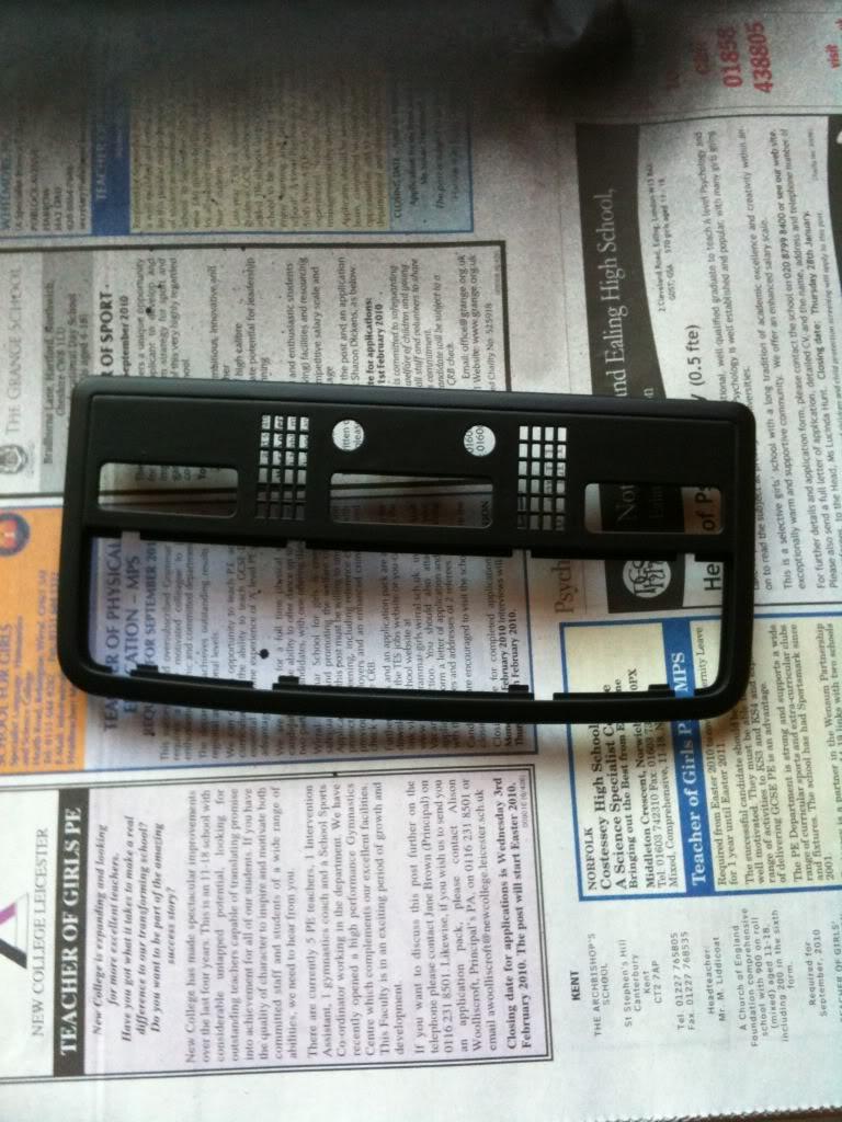

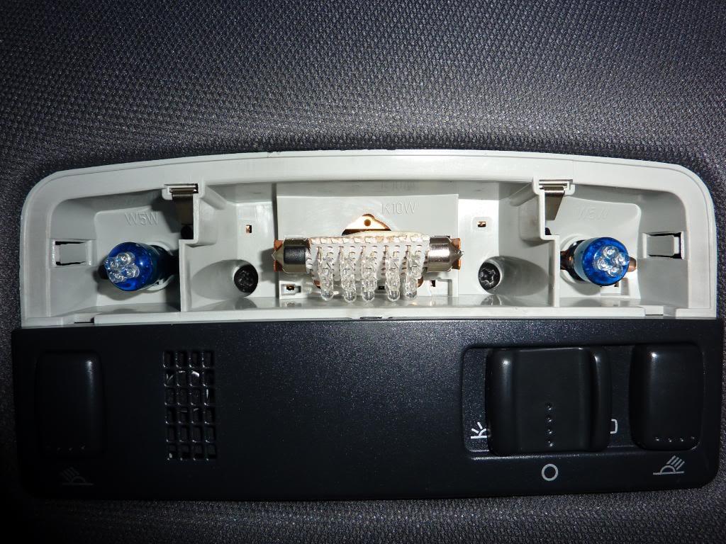

Firstly this is a few pics of the preparation. The light is normally light grey so i used Halfords Matt black spray paint to spray it. I masked up vital bits and put bluetac over the LED's

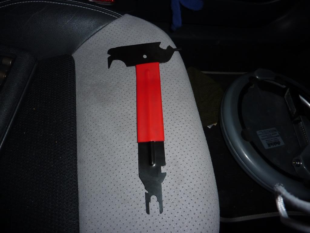

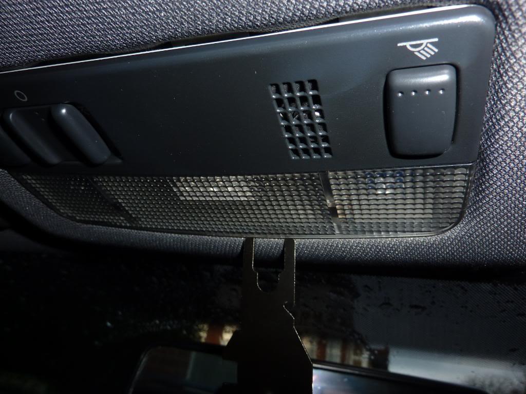

Now this is the trim tool i have which i got from halrauds some time ago iirc cost about £8
Using this tool remove the Plastic Bulb cover
Once inside undo the 2 screws (careful you don't drop them)

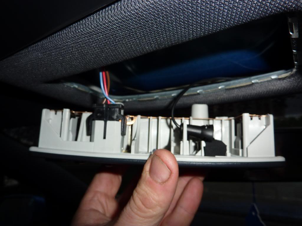

Gently using the trim tool remove the Light unit and undo the electrical connector you can see on the left. The other wire is the Mic for the FISCON kit.

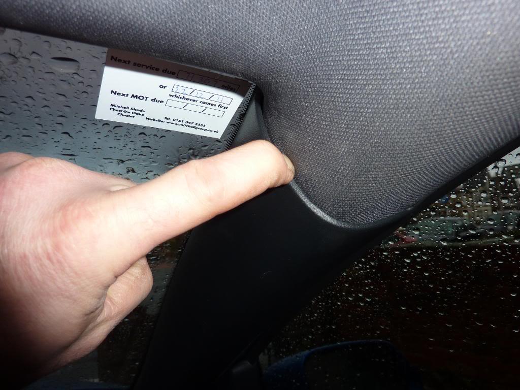

Next remove the Trim from the A Pillar by firmly but slowly pulling it away. Dont yank as its only held in by 4 white plastic lugs.

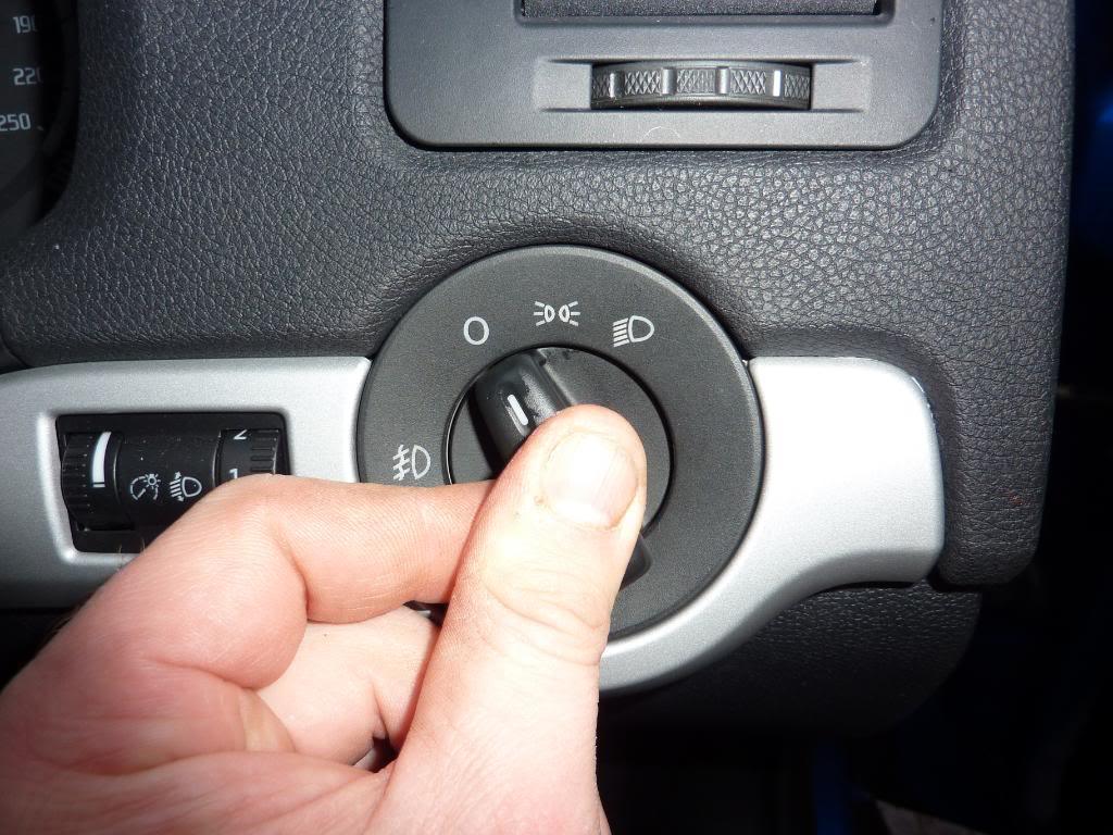

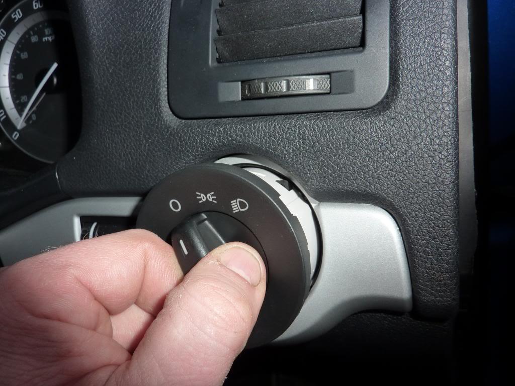

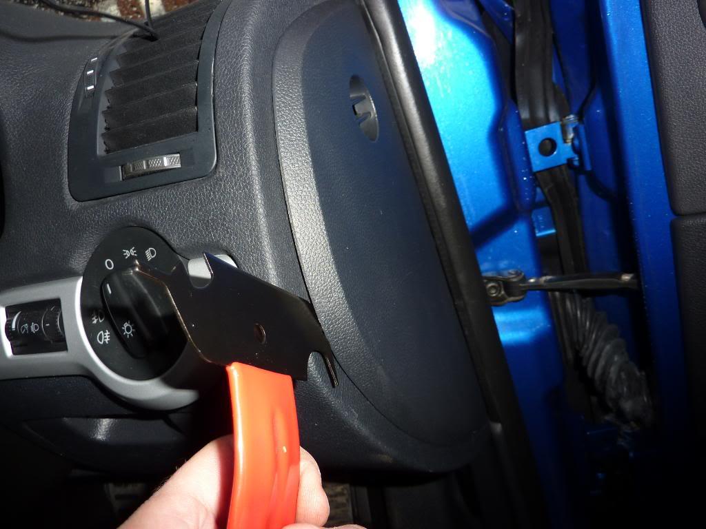

Then remove the light switch by pushing in, turning to the sidelight position and pulling out.

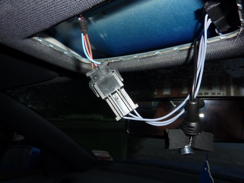

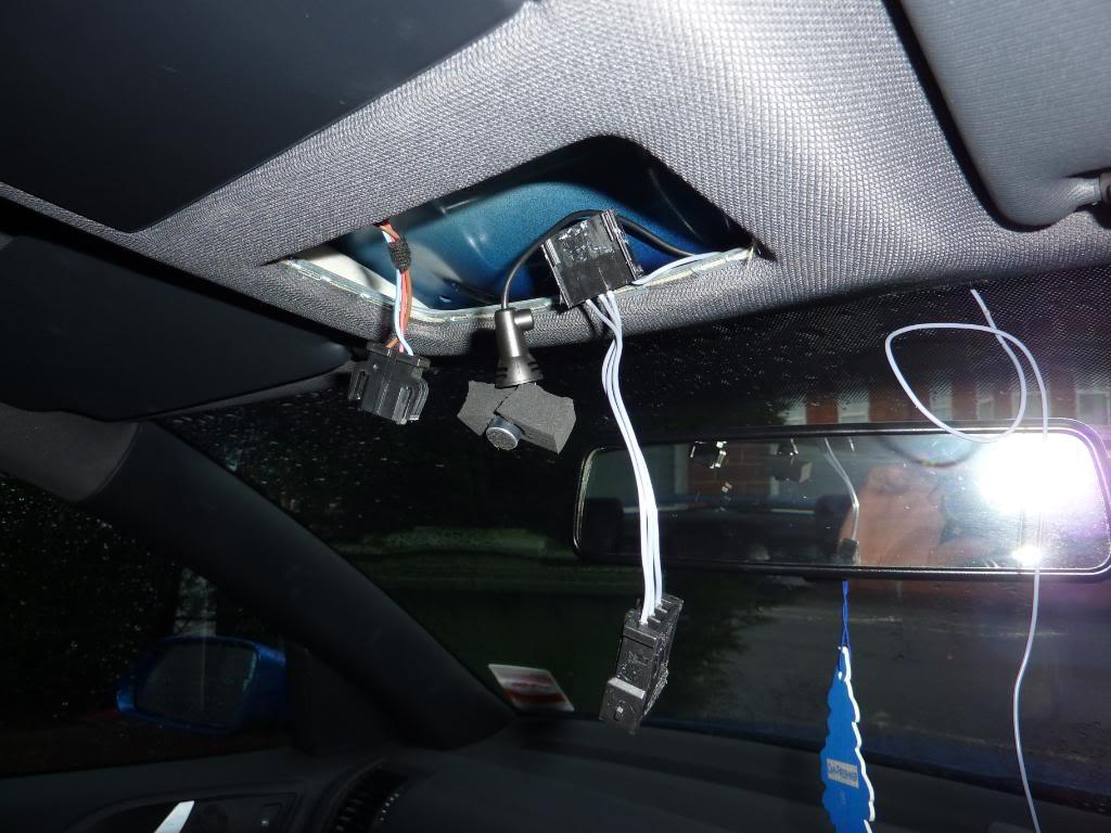

Now connect the wire loom to the original lighting loom.

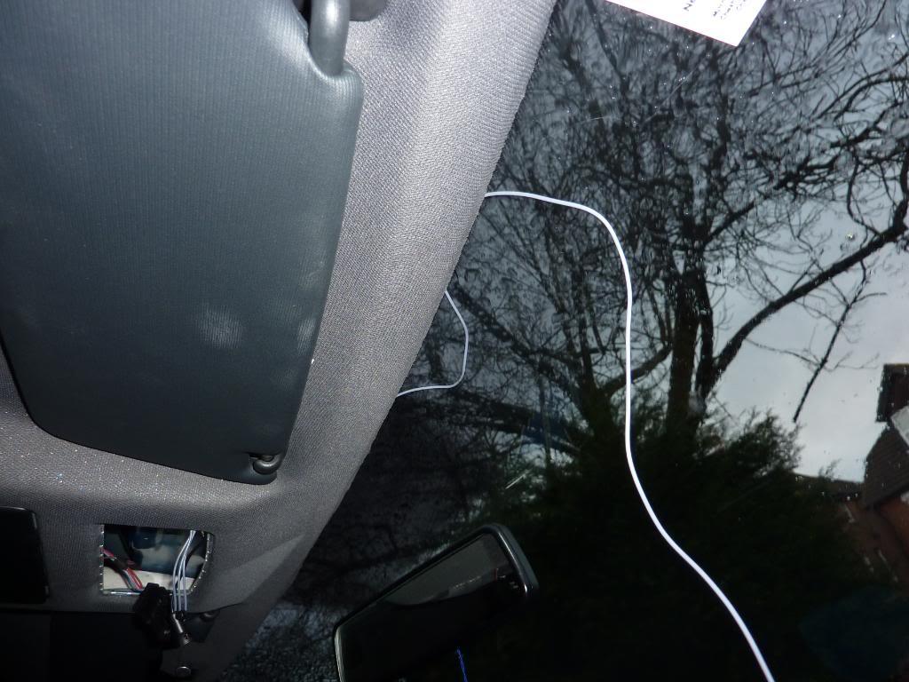

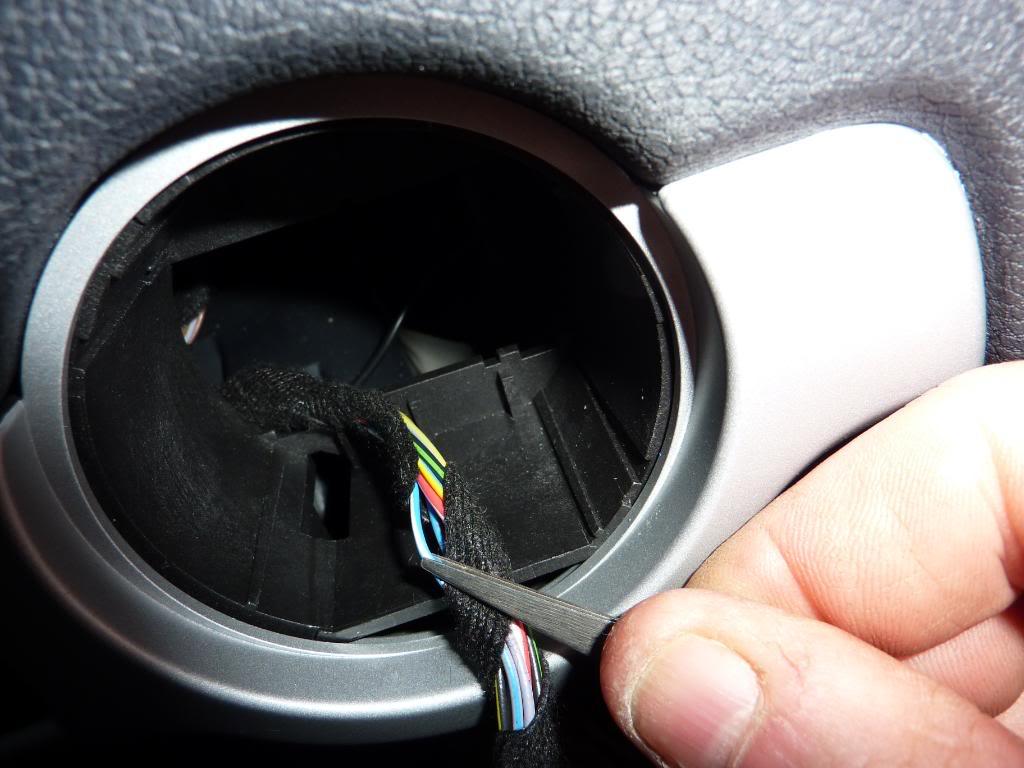

Next run the wire along the top of the windscreen and down A Pillar then behind the fuses until you have the wire poking through the hole which the headlight switch normally sits. Ive left it sticking out for the picture just tuck it in along the headlining

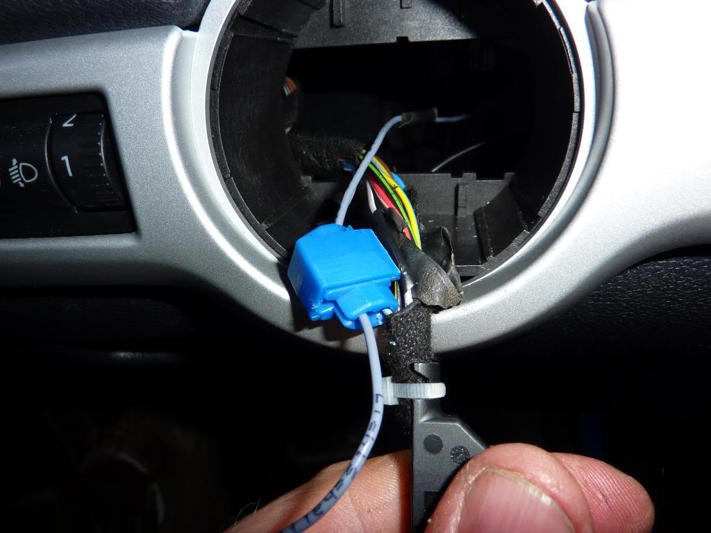

Now you need to find a Permanent live feed (in my case the blue and grey wire) to get the LED's to work
I used a Scotchlock connector to save chopping wires

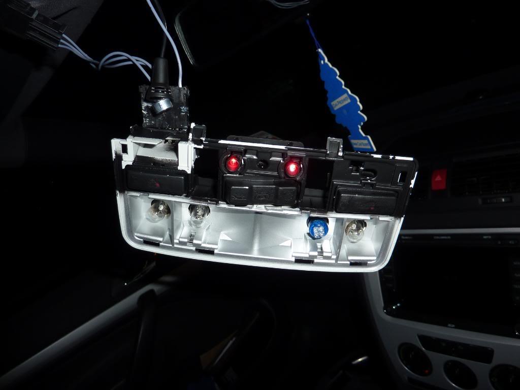

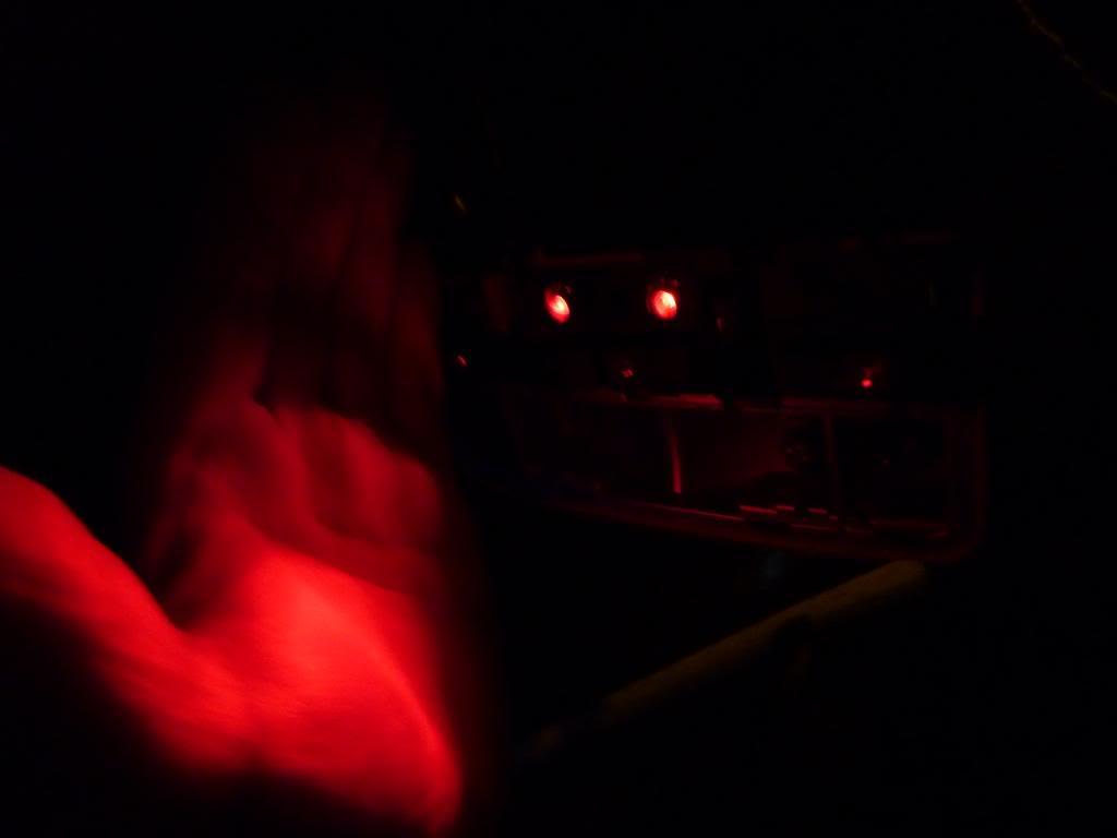

Check all is working

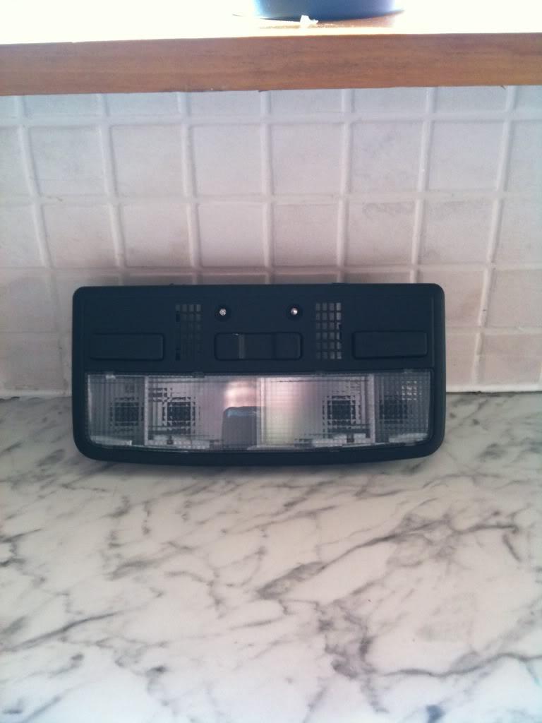

Then put the unit back in the hole in the roof. It will fit and also take note that the screws cant be used as the holes don't marry up. But trust me its a tight fit so it aint gonna fall out.
And fully fitted
