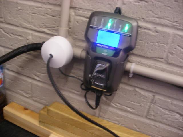

^^^^^ thats right , when i swapped my battery this happened , the one touch windows need resetting too . if you want a brilliant battery charger , oxford maximiser is the one , mk car is connected to it whenever i m not using it , ive put a special socket on the battery so it just plugs in  :happy2:
I have 2 Optimates in the garage, mounted on the wall.  One for the bike, and one for the car.  As CT, mine is plugged in for the majority of the time.
here s mine .....
