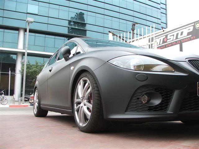

a week and a half later and after the arrival of a shipment from Germany of OEM Lamborghini Nero nemesis Matte black color , this is the result :

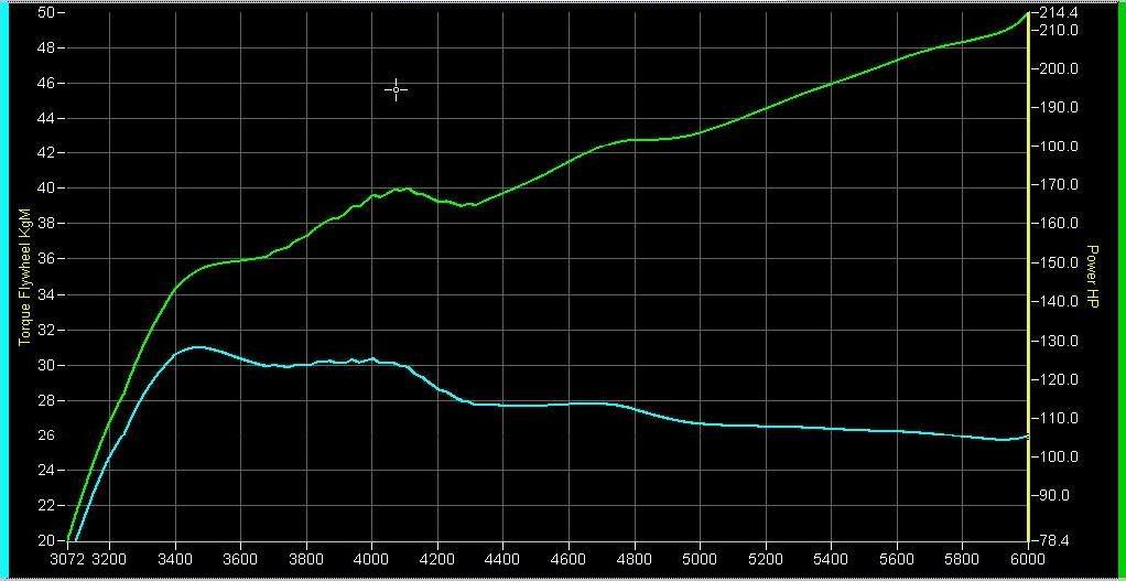

So, the car goes on the dyno and here are the numbers :
Since torque is calculated in KG/M in Israel, in conversion to LB/FT  it comes to 224 LB/FT.
So around 210 WHP and 224  LB/FT at the flywheel is exactly what the manufacturer prescribed , and estimated drive train loss here is around 12% which also sounds about right.

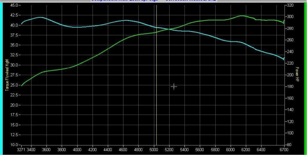

Ok, now moving on to the APR stage1 Dyno :
We did 6 dyno pulls on this since the numbers are unbelievable.
300.1 WHP and 304 LB/FT of torque
That comes to over 90 WHP and 80 Lb/FT of gain on just software.
completely stock car with just 500 miles on the clock.
Truly unbelievable numbers, and that's on a Dynapack , not some MAHA or a DynoJet.
