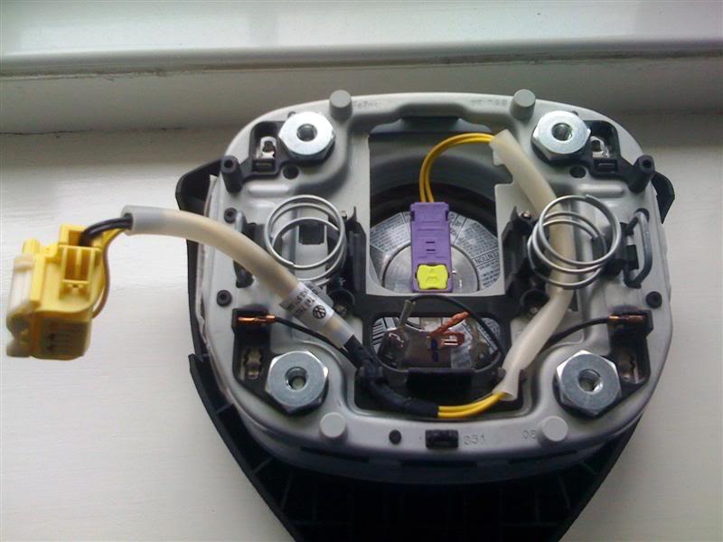

So cant find a fitting instruction, so a quick explanation!
First thing to do is to park the car with the steering wheel at a right angle, so the bottom spoke is parallel to the ground (this will minimise the amount of dry steering required) then disconnect the negative battery terminal, this will allow you to isolate the air bag, and also prevent any error codes being logged.
Then release the steering column adjuster so that you can move the steering wheel as far away form the dash as possible.
Remove the trim below the dials with the leatherette that links to the steering column, this should just pull gently forwards, this will then allow you to remove the top plastic cowling from the steering column, this is held in place by 4 metal trim clips, I did this by inserting a trim removal tool into the gap between the upper and lower trim on the front face (the area normally hidden by the steering wheel) this gave enough purchase to pull the trim off by hand, in an upwards direction.
Once you have this out the way you will then have space to get a screw-driver behind the steering wheel, this is the point where you might need a small mirror, as you are looking to insert the screw driver into the oval slot with what looks like a large phillips screw driver head, the air bag is attached to one of these on either side via a metal loop, you use the screw driver to un-hook the loop. you can see the holes and clips in the picture below.
and the hooks in this picture of the back of the airbag
Once off, you need to insert the key to release the steering lock and turn the wheel through 180 degrees while being careful not to pop the airbag back on to the clip youve just removed.
This time make sure your supporting the airbag when you un clip the hook, as the wiring will be the only thing holding it in place, once released undo the yellow air bag wiring harness and place the airbag to one-side.
