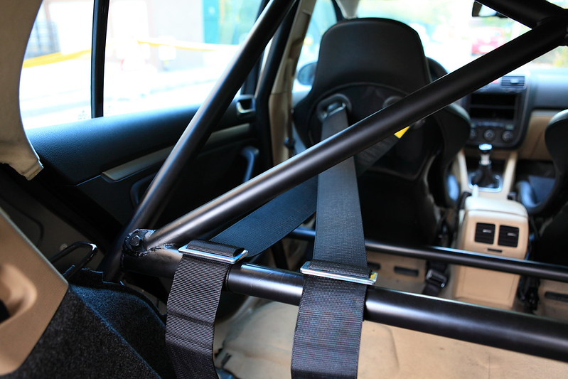

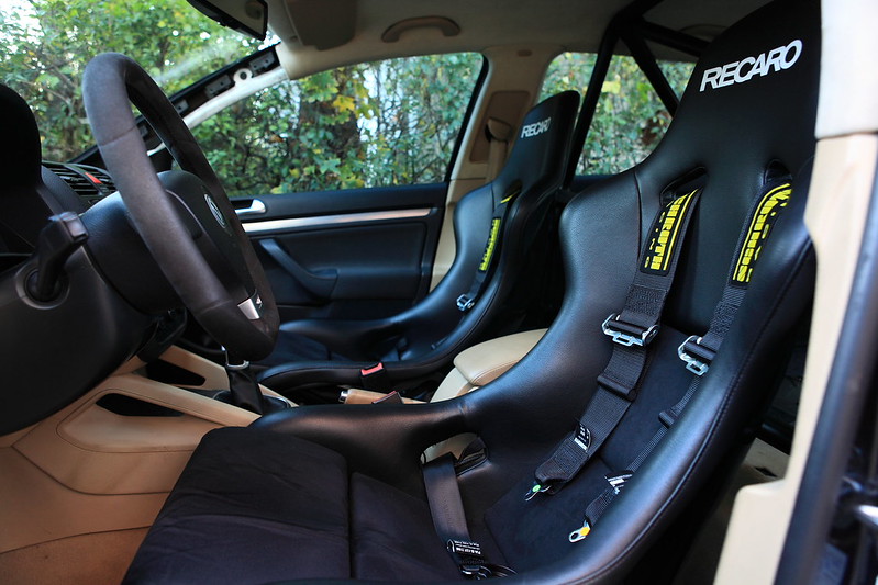

Finished installing the Wiechers roll-cage and Schroth racing belts. The roll-cage has been welded everywhere as I didn't find the bolt style to add enough stiffness to the chassis ! Weight added would be 25kg for the roll-cage and 4kg for the harnesses

- After 4-5 removals, the very soft screws that came with the Recaro seats were done. I barely succeded in removing some of them for the last time. Thanks to rex's tip, I bought much harder screws from Fabory and with a thicker head. If you can imagine the high quality screws costed me less than 3 Euros but Recaro didn't think they should use such expensive screws on a 700Euro seat (+200-300Euro for the rails)

- I finished installing the roll-cage from Wiechers. The kit came with all bars joined through bolts which I didn't like at all and found it to bring too little aditional stiffness to the chassis. Also, although I've ordered the bar for my Schroth harnesses mounting, they sent me a horisntal bar that was to be connected right behind the seats on the lower main frame (close to the air-con for the rear passengers). The harnesses can in no way be mounted on that as the angle to the horisontal plane is much more than the 20deg as advised by Schroth. Therefore, I purchased a steel bar and installed it on the rear rollcage fixing, on top of the wheel arches. All being said, I welded everything, including the 4 points on which the rollcage fixes to the car and I've reinforced those points with thick metal plates !
- Installed the Schroth harnesses using the supplied eyebolts at the recommended angles
