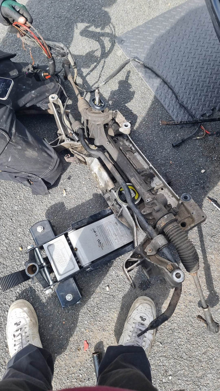

« Reply #18 on: March 05, 2023, 08:22:24 pm »
So I believe that the J500 is faulty, does anyone have any more information regarding the continuation of a fix. Disconnected the power steering wire seen in the video, I believe its that is the reason for the powertrain having communication issues due to this. I still had the ABS module unplugged but I will plug this in tomorrow and rescan it. It starts every time now, but I want to be 100% before I drive it anywhere.

After removing the rack, we wanted to see the damage. If anyone has had any weird symptoms. Make sure to get it checked out before driving it anymore. Thankfully the power cable insulation held up and didn't catch fire.

I guess that's why the Gen 3 racks have an upgraded harness!  Good work  :happy2:

Thanks for the previous help pudding. Currently getting a lot of voltage 30 codes but slowly getting there :P

Ah yeah, 30 is the Battery + post I believe? There are a few modules that are 'hot' at all times, so that error code is quite common.
You have the patience of a saint and well done for keeping us informed.  So many forums have dead threads with no answers, so top man  :happy2:
I find vehicle wiring incredibly tedious and unrewarding to troubleshoot. I think I would have thrown the towel in an scrapped the car, but Kudos to you for tackling each issue systematically  :smiley:
How is the engine bay fuse board looking?  With some fried steering harness wiring like that, I wouldn't be surprised if the fuse box could be slightly toasted as well.

Yeah I know the feeling. I don't keep costing spreadsheets like some folk do as it's too depressing. I reckon with the money I've spent on fixing and modifying VWs, plus all the 20mpg fuel costs over the past 20 years, I could have driven a diesel sh1tter or 5 for that long, saved the money and bought a 911  :grin:  But car enthusiasts always seem to prefer the school of hard knocks  :grin:
Thinking back to the beginning where you said these problems began after you rebuilt it, was it fine before hand? Did the engine come out? Just wondering if a wire got accidentally got pinched and shorted out, which caused all this grief?  If any of the CAN modules get shorted out, that can upset the rest of them, including the gateway.
Having said that, the steering rack wiring harness on Gen1 racks was a known weakness. VW under spec'd the wire size, which in some cars caused the crispy mess you ended up with. If one of those shorted out thin wires is a CAN signal, I can see that causing you some problems. Before I switched to a Gen 3 rack and harness, I did notice with hefty steering inputs, it felt like the rack couldn't keep up and got mega stiff all of a sudden. I suspect that was the motor struggling for current over the thin wires.

I think you were just unlucky with that. The Gen1/2 rack was known to have under specced wiring. Thank god it didn't torch the car!
