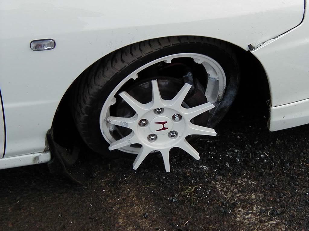

Bummer on the ITR, you can't account for idiots sadly and I bet no farmers were willing to hold their hands up to that one. Diesel is as bad.
It was for the best, methinks. I was a menace in it!
Low sun, wet road...and missed the mud. Rear stepped out, fishtailed, power on, hit the limiter, followed by the lock-stops, spun it into an embankment, flipped it right over and back onto it's wheels destroying 3 corners and twisting the 'shell.
Heavy impact too:
That was the end of that.
Then spent the next 3 years trying to make an 8L S3 as interesting to drive as the ITR. And failed.
It was fast, and handled brilliantly. But it was dull as dishwater.
