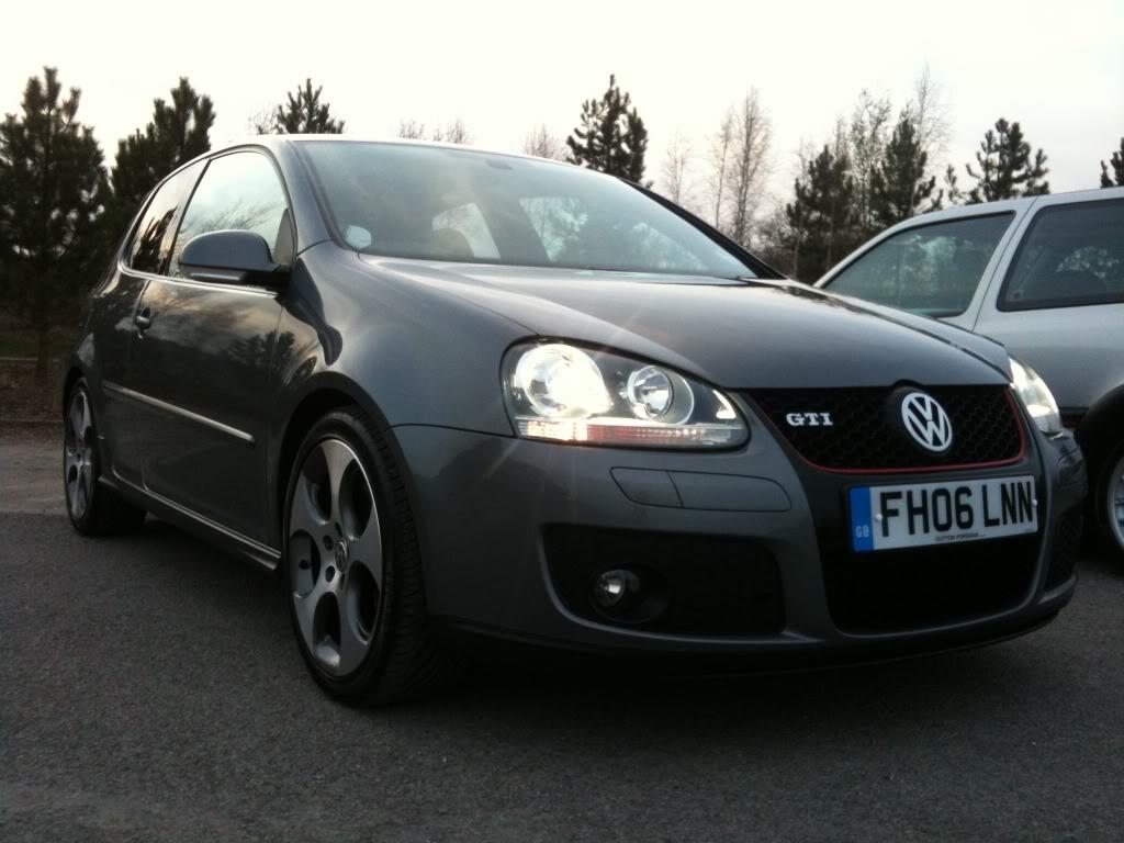

Woke up to a nice warm, slightly overcast day today which seemed perfect to clay the car and use my recently purchased Lusso Revitalising Cream and Oro wax.
 All I can say to anyone thinking about clayling is to just crack on with it. It made such a difference to the shine/feel of the paint and wasn't difficult really. It also gave me the perfect base for applying the Lusso which I am well impressed with!

The red GTi looks awesome Boothmeister!  :happy2:
