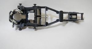

One thing I'm trying to rectify is the passenger door handle blank is loose, I've taken off the side panel and the sticker (already removed) to look for the Allen bolt to tighten..... But it's not there! What does this screw into? As I'm clearly going to need another of whatever that is? I've looked at the handle assembly replacement guide but can't see this part.

You mean the T20 Torx? If its not there then someone has unscrewed it previously well beyond the 12 turns to pull out the blank. Can you pull the bank out fully away from the car?
If you can then I'm afraid your gonna have to remove the door skin completely and replace the door handle mechanism. 1K0837886A
https://www.mk5golfgti.co.uk/forum/index.php?topic=52585.0
