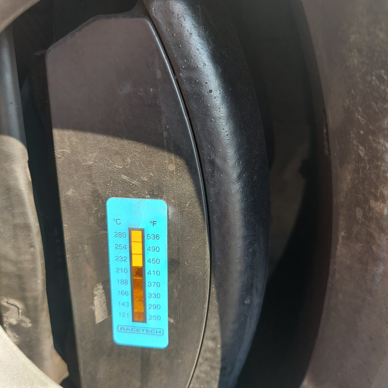

« Reply #140 on: July 31, 2022, 05:39:39 pm »
New front brake setup Bedded in, pedal feel is good, slight gap of no brakes compared to the gti setup as in its a longer pedal but if I wasn't expecting this I may have not noticed as its very slight. Surprised how noisy the j hook discs are, not that it bothers me but I know VBT have made alterations to make these quieter so can only imagine how loud they could have been. Looking forward to testing this setup out in a few weeks at Pembrey, don't think I'll really get to see the difference until I'm on circuit again.
The pad size  difference is quite subsantial
Ebc bluestuff on the rears have worn very fast, 2 track day and maybe 500 road miles and they've got about a 1 track day left in them, I'm swapping them to use as spares now and going to install mintex m155 in the hope they're more durable as I've heard.

Yeah I couldn't get on with that dead spot at the top of the pedal.  Where it's most noticeable is dependant on how it's driven and is subjective, but for me it was when cruising at 70ish and someone pulls out on you, and you just want to scrub about 10mph off.......nothing  :grin:  I mean, it's not horrendous and just needs a firmer press on the pedal, but when you do 80 miles a day with that.....yeah.....it gets annoying  :grin:
J hooks are noisy are they?  See, other folk who've used them have never mentioned that  :grin:  I did suspect as much as grooved discs I've used in the past made horrible grumbling noises, and the drilled Clubsport S discs make a ticking noise as you pull up....kind of like a cricket chirping away.  Anyway, old man gripes aside, I'm glad the mods are working out  :happy2:

Awesome day at Pembrey. Never been before but a really cool circuit and very technical. 31 degrees most of the day took its toll on me and the car a little!
New brake setup took some getting used to, trail braking requires a heavier foot for these calipers on the mk5 master cylinder which feels a little wrong at first but with this setup with pbs pro race on the front and mintex m155 on the back it really shocked me how much quicker it stops when the pads and tyres are warm, felt wicked out braking a lot of light weight and better prepared track cars in a 1.4 tonne fat boy golf with heated seats and air con :grin: temp stickers show 140-160 on the calipers which is much lower than before but with it getting hotter and hotter and then getting carried away and staying out far too long on the last session they got seriously hot, didn't help that it was so hot they didn't cool down that much between sessions either.
Will check how the pads have coped and maybe bleed the brakes just in case but it all feels fine still on the drive home tbh.
