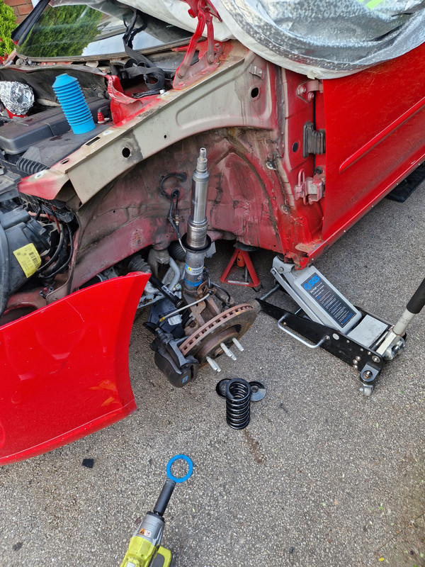

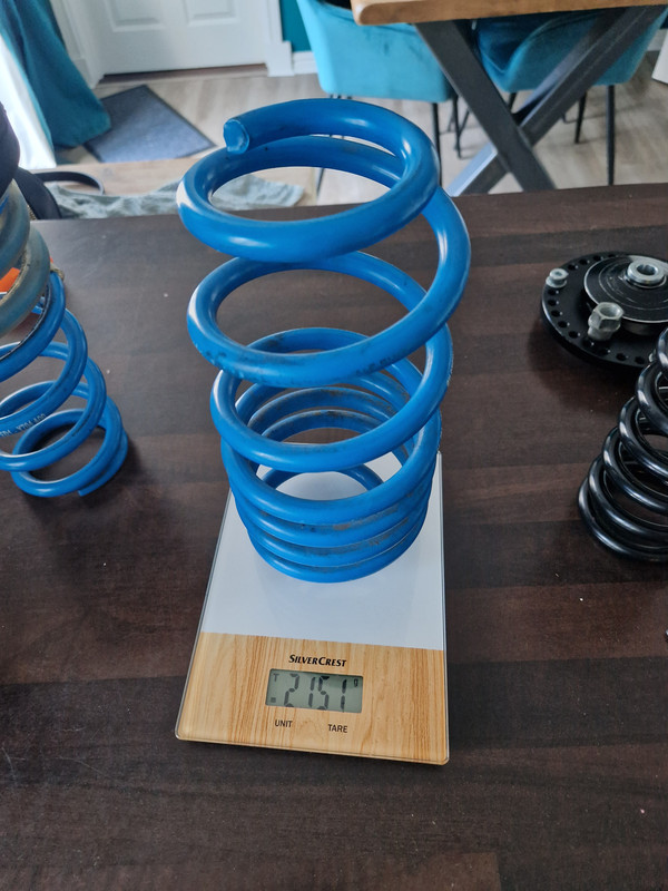

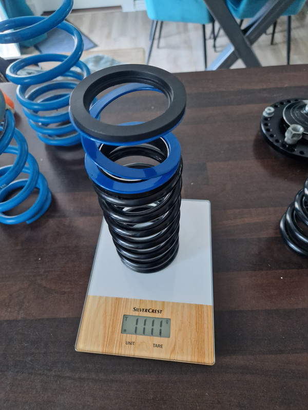

Started messing around with linear springs again! Lots of sanding down and odd adaptors and I'm close to working out how it will fit while getting the ideal ride heights. As well as the obvious benefits, there is also quite a significant unsprung weight saving, roughly 3-4kg total saving which is about 0.8kg - 1.05kg unsprung weight saving on each front corner and about 0.6kg - 0.85kg on each rear corner. I'm going to mount 450lb/in (8kg/mm) all around and check how the dampers feel with some road testing and go from there.
Here is something cool I came across the other day, reversing adjustable top mounts left-to-right and vice versa to increase castor.
I've got the compbrake solid top mounts in the shed so did some quick calculations, the compbrake top mounts have 30 holes to mount them and can be mounted in any orientation so there is quite a lot of freedom. So mounting them so the adjustment goes forward-to-backwards allows for 0 extra camber, but the top of the shock can be mounted up to 18mm further back which should be quite a substantial increase of castor. A good compromise would be to mount them somewhere in between which will still allow for half the total amount of camber possible along with pushing the shock a further 9mm backwards which should still be a decent castor improvement. For now I'm just going to mount them normally so no castor increase to ascertain initially how much camber I can achieve and then I can add additional castor this way if I'm not maxed out on the camber adjustment of the top mount. Camber I'm aiming for is roughly -3.5 degrees.

Linear springs are much better than progressives. Way more predictable. Progressives are OK for road cars driven slowly but they're no use on track.

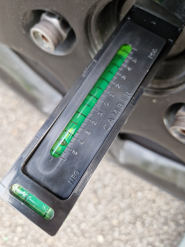

It's good to experiment with castor as that gives you a lot more dynamic camber, so you don't have to go quite so aggressive with the static camber  :happy2:

I did try 450's/8kg springs all around the other day on a quick road test with a very wonky alignment but ride seemed better than previously frankly so I will be taking the punt on getting it setup soon as an intermittent solution to either re-valving or replacing one day which is fine for now, a cage and a diff are way higher up on my last right now.

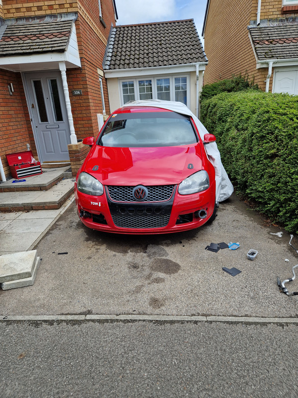

Been busy..

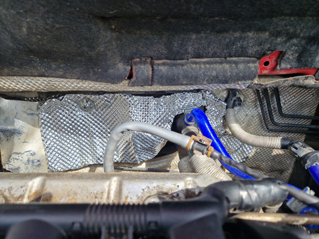

Ac is now out. 10kg off the front end in total.
Lots of debris blocking the IC going on, clearing it out and removing the AC out should see a nice difference in temps

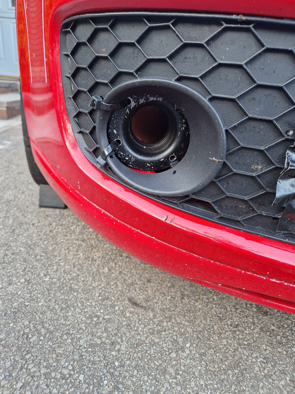

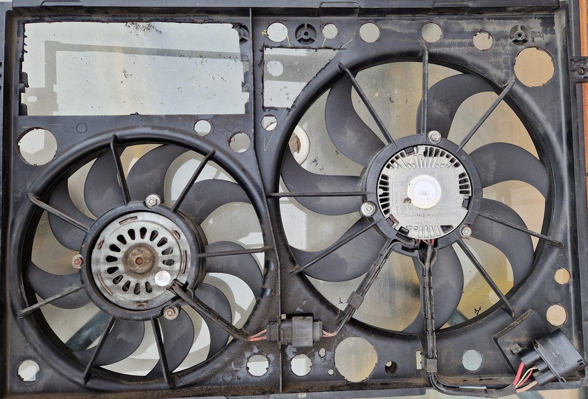

I tried to improve air flow from the fan pack, by reducing blockages so the air can escape easier, this will lower the air pressure behind the rad and the bigger the difference between the pressure in front of the heat exchangers and the rear the more effective the cooling system will be. I could cut more out but I was concerned it would lose all its strength and start to flop about at speed and possibly damage something, most likely the radiator itself.
Its quite common to see multiple holes cut out of the front bumper on track and club race cars, I've always been dubious if this does anything. So I thought I'd put it to the test, I've cut a letter box out the bumper.

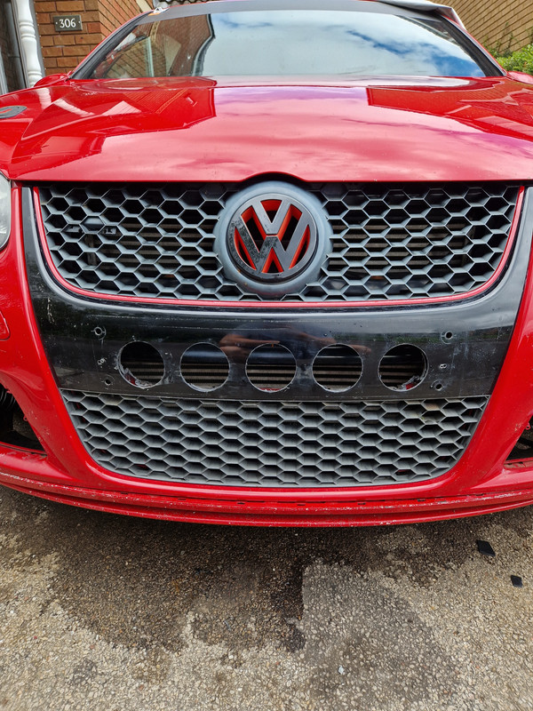

And cut some holes then out of front grille
I'll use the number plate to block this up normally, next time at circuit I'll run logs in 2 sessions of multiple temps with and without the number plate to see if it makes any difference at all.

Without the A/C condenser removed, debris shouldn't build up like that again, plus the obvious airflow benefits  :happy2:
Yeah I wouldn't have swiss cheesed the radiator cowling like that tbh  :grin:  It reduces the amount of air pulled through the rad when sat in traffic, although as your car is predominantly for track work, it shouldn't really matter in your case  :happy2:  Defo not recommended on a daily though  :grin:
Swiss cheesed bumper should help the intercooler though, and indeed engine cooling at high rpm  :happy2:

So the heat shield to cover the bulkhead is a pain to remove and re-install so I just cut the thing up and bent some embossed stuff over it instead. I had to import this stuff from China as could not find anyone in UK who would sell it for a reasonable price which I thought was super strange as its quite a common material in modern cars :stupid:
Added a little spare stuff over the IAT sensor, I heard before that they can heat soak and read higher temps because of it than the actual air that is in the intake, when I get around to it I'll see if I can put that theory to the test:
Now on 6 inch 550 pound spring up front (roughly 10kg/mm), not test driven yet but I'm pretty sure after so many calculations that we'll end up with a just a stiffer linear setup and the rebound should still be OK with this spring. Using a 7 inch 450 on rear which is the same sort of thing, linear and a little stiffer.
Bought a cheap little camber guage, you have to calibrate it everytime you use it and it does un-calibrate itself which just a single violent shake so got to be very careful using it but I just wanted to see how much camber I was roughly getting with the top mounts and if I could adjust them to still hit my target of -3.5 up front but with a bit more castor by rotating the top mount to move the strut rearwards. But.... when setting the camber at max both sides on the front it showed 2 degrees on the left and 5 degrees on the right? I think possibly the floor was not perfectly level (it was by eye though) and the subframe might be in some really weird position so I'm just going to try and get the subframe in a happy position for now and set the front camber to -3.5 via a trusted shop and if there is plenty of room left in the camber aligning area then I'll know next time I can add more castor.
Some pics of the bumper trim, like a minute amount less drag and I'm usually not one for the aesthetics and more about function over everything else but I think its looks cool in person more than anything :grin:

Yeah that stuff costs a fortune over here for some reason. It's just stamped aluminium sheet  :stupid:
The intake sensor does indeed heat soak because of where it is, but on the move it sorts itself out quickly. It's just at idle sitting in traffic it gives a high reading. If you have VCDS running, you will see it drop right down if you crack the throttle open to get some fresh air through it.  More importantly, the reading isn't the intercooler temp....it's just the heat of being right next to the cylinder head and low airflow when the throttle is closed.
Interested to hear how the stiffer springs work out.  400lb front and 350/400 rear is fairy common on most coilovers as a starting point, so 550 isn't massively stiffer. A lot of folk run the same stiffness front and rear because the rear springs being inboard behave differently.....aka 'motion ratio' but it's all good experimenting  :happy2:  Are your dampers up to that level of extra stiffness?  I fitted stiffer Eibachs to my Ohlins and it was a bit too bouncy for my tastes as the dampers weren't up to it, even at max stiffness.  Stiffer springs keep the car flatter in the corners though, so you don't need massive ARBs.
Have you got a deadset kit fitted to your subframe? That usually helps iron out camber discrepancies. Most of them have more camber on one side from the factory! Mine was stock -0.55 on one side, and -1.2 on the other side on it's standard suspension. Shoddy!  Even with SuperPro ball joints, the best I could achieve was -1.2 and -1.5. One BJ was fully in and other fully out to get that. They're not the best cars for alignment!  So long as the toe and caster are the same, it doesn't really matter too much.
The rear end looks pretty cool actually  :happy2:
