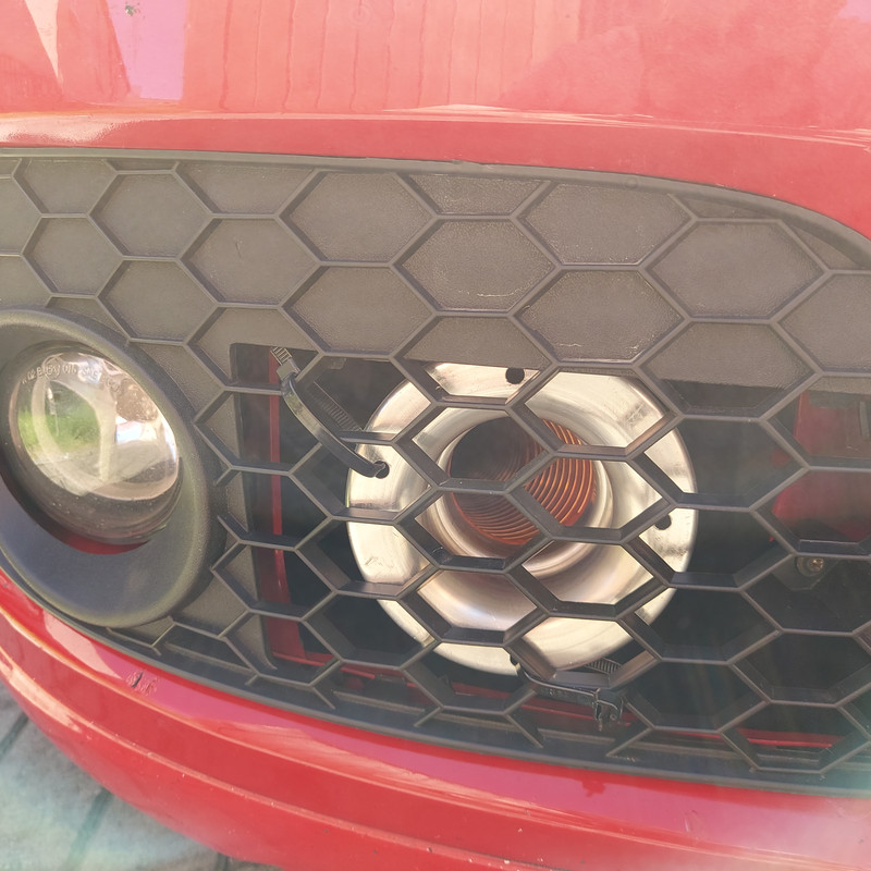

As per recent posts I ended up just routing the ducting to the wheel arch for better air flow, done a fair few miles on the road without front dust shields and no issues. Easy Install just cut a hole in the arch liner and get some inlets and outlets, drill holes in them so you can zip tie to them to the arch liner and rhe front grilles.
Ignore that extra random hole! Will re route them go via the fogs at some point and do a fog light delete for ease of access and disassembling and also because it allows me to add another duct to a cold air induction kit via the fog grille in future!

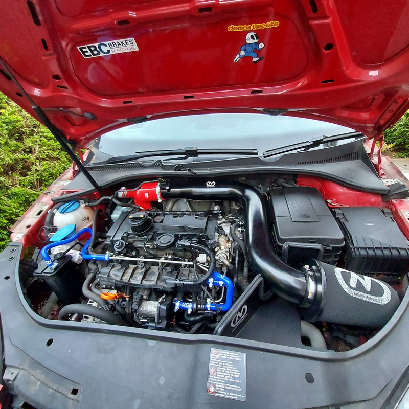

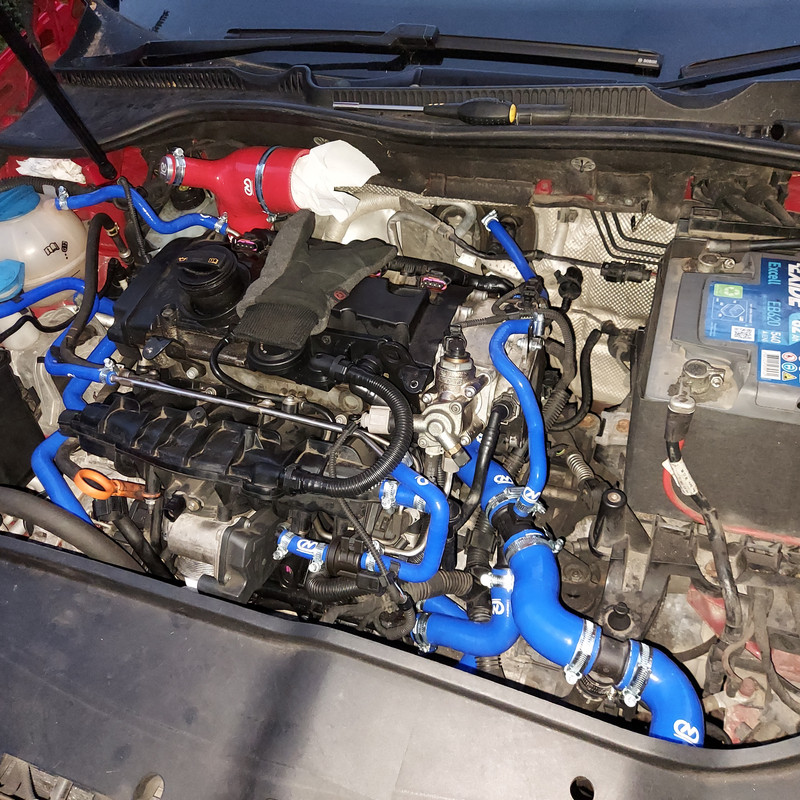

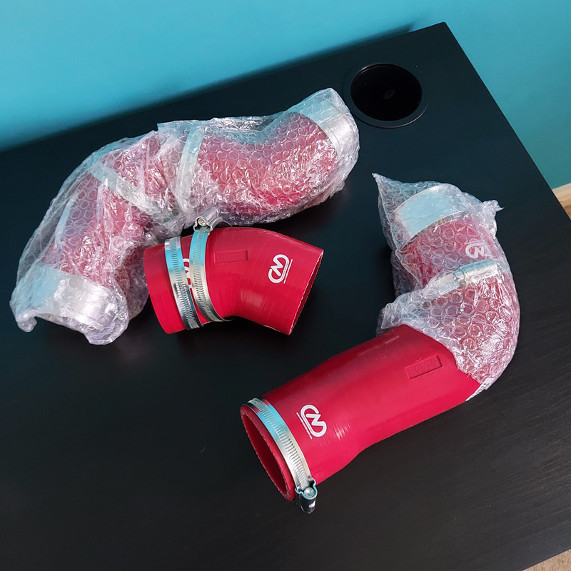

Bought some silicone hoses to replace the badly fitting and oil weeping boost pipes:
Buggers to get on mind, I gave up in 30 degree heat so will have to try again soon.

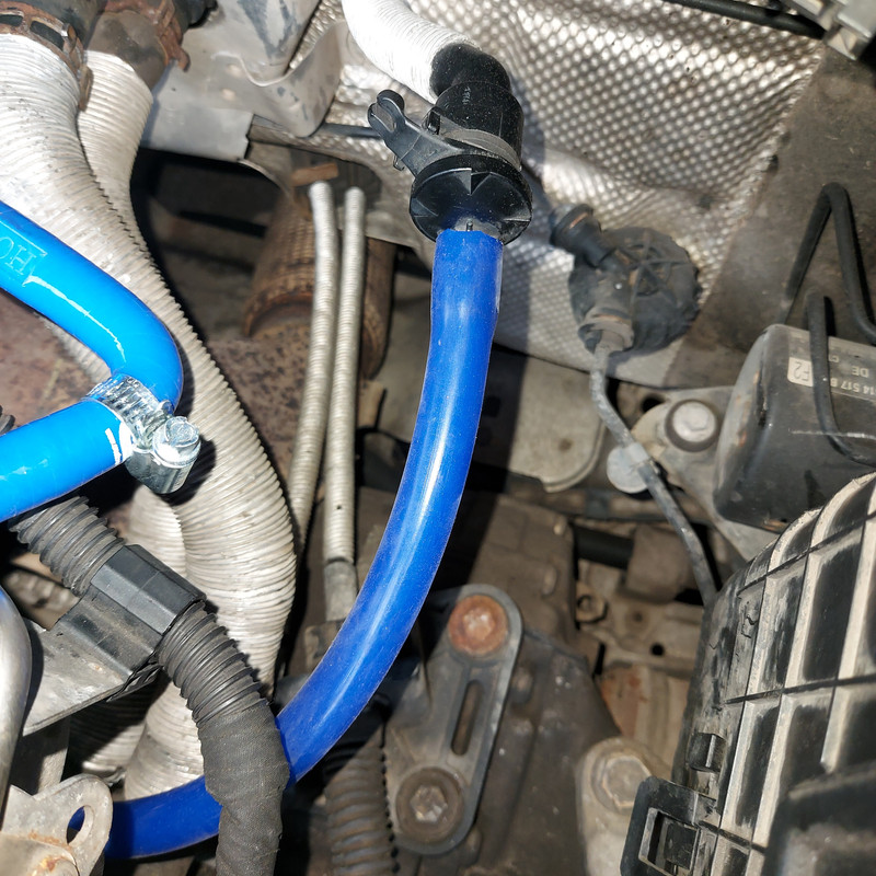

N80 valve change for a suspected evap fault along with silicone charcoal cannister hoses:

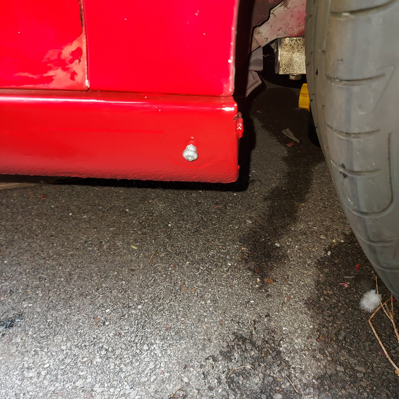

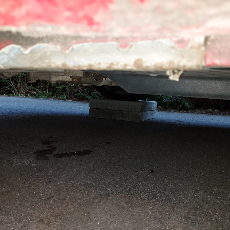

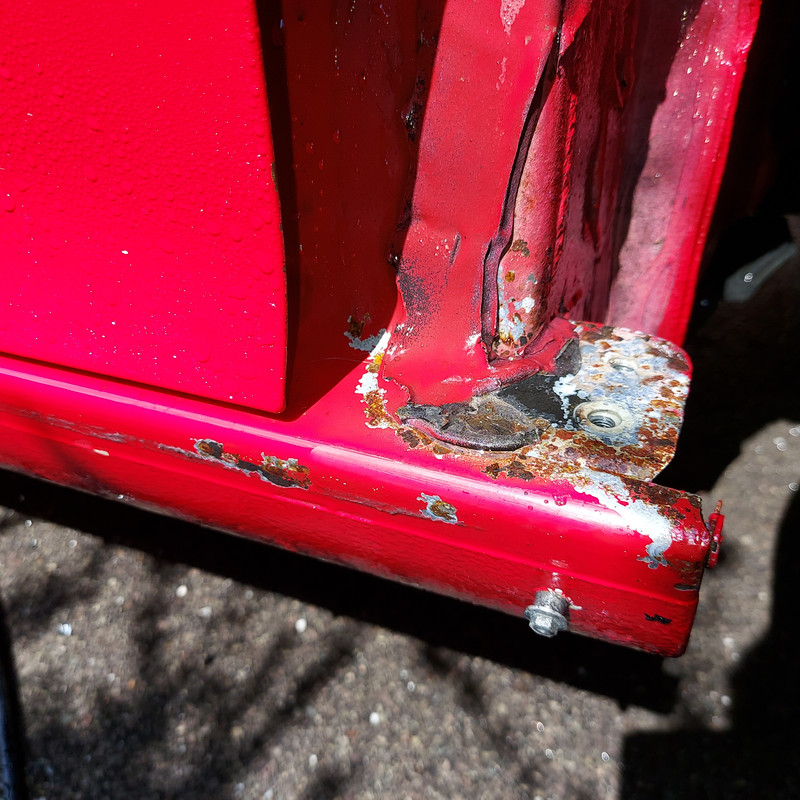

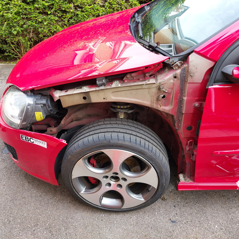

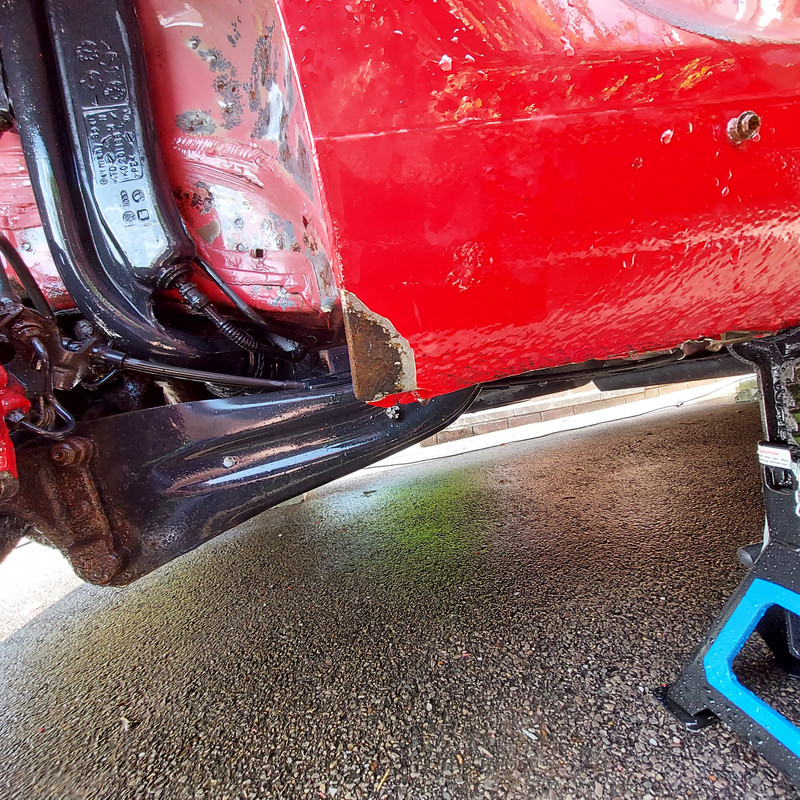

Currently examing the rust on the sills and jack points, seems to be all surface rust though which is good so plan is to straighten the damaged under body seam, cut off loose seam sealer and paint in por-15 Anti rust paint. I may give the sills and behind wheel arch area a gentle sanding first to get most of rust off and then apply por-15 followed by a rattle can touch up in the oem colour, pretty ghetto job but as long as its not rusting I'm happy.
I've seen pics of people having rust issues due to the side skirts Letting moisture in and it sitting there forever, I've taken mine off and tempted to just fills these screw holes with something and go side-skirtless as they're a pain to take on and off and just cause issues anyway... need to mull that one over

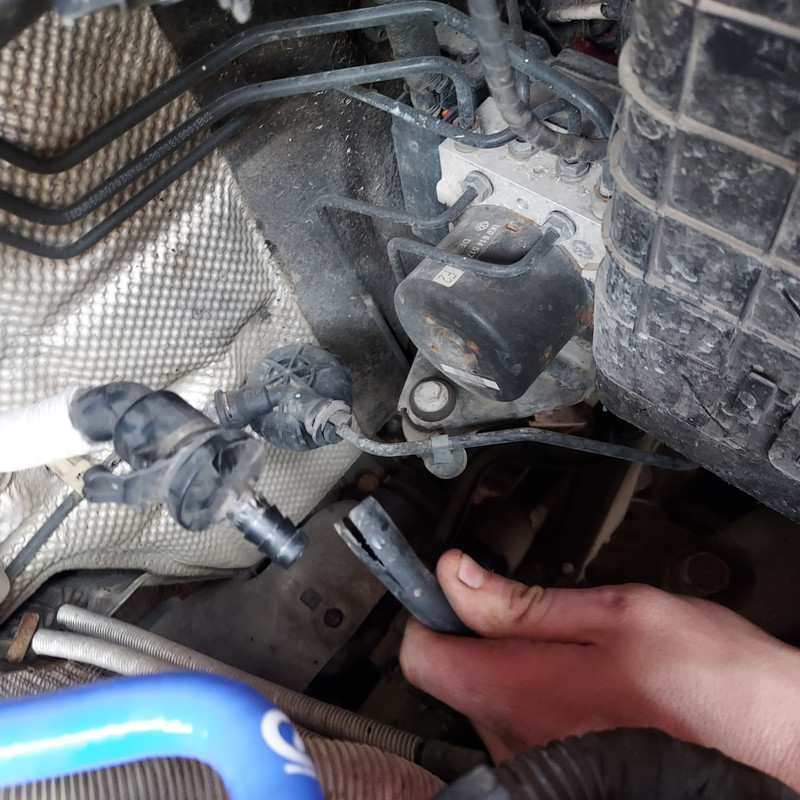

Also anyone know what this silver box is on drivers side behind wing?

isn't the horn in there?
Well spotted. Forget to mention that if you remove the horn, you can beat the top of it pretty easily until its flat, this will allow you to rotate it to a position you are happy with and then tighten it up.

The silver box is the alarm horn. It fails frequently with age.
Yeah this what it is, recently had to replace mine and it was a twat of a job removing it!!

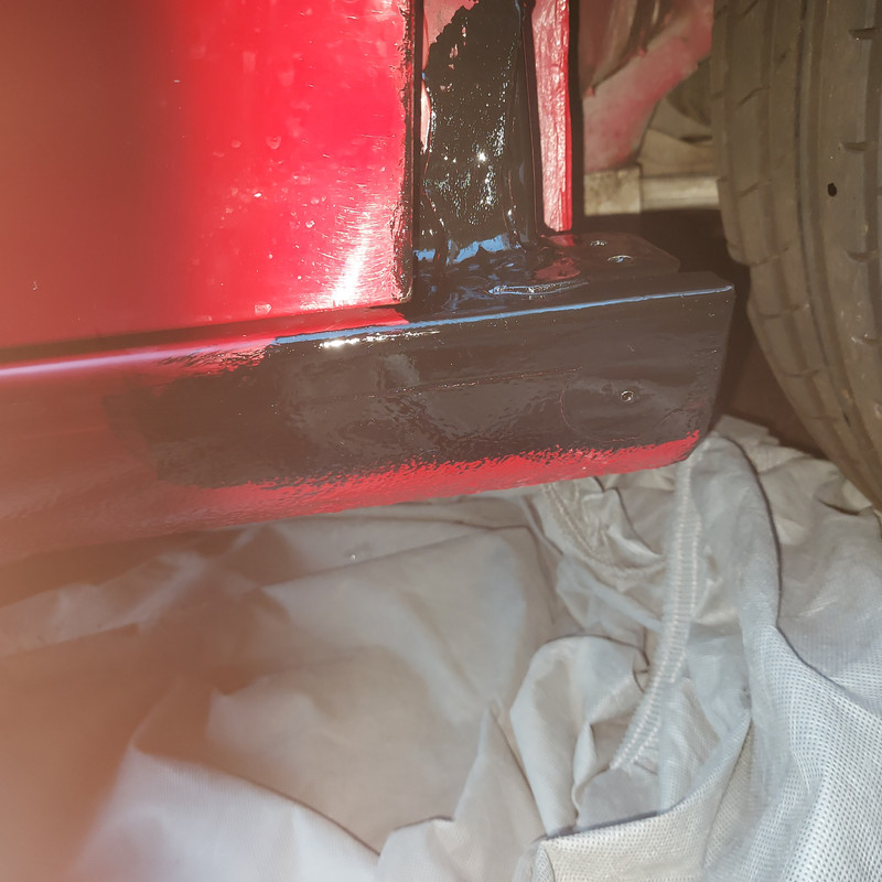

So been tackling the rust. Decided to just sand away some of what I could easily and cover the rest a rust converter, and paint any areas that will be exposed to sunlight. It did not look too pretty to be fair but all surface rust anyway, only serious rust I found was on some of the crash bar but in a pretty insignificant place to the structure so it's  no concern to me.
if it protects some vulnerable areas for a bit longer and slows down some corrosion I'm happy.
Also been tackling a misfire due to system running lean, mainly cylinder 1. Been scratching my head a bit with it so thought I'd do a bit of a overhaul. New intake, carbon cannister hoses and silicone coolant hoses, along with some silicone boost pipes.
Everything is from creation motorsport. Been happy with the quality but the throttle body hose I've had to leave off the car, I just simply cannot get it to fit onto the throttle body even with heating it up and using lubrication. It's just about 1 or 2mm too narrow. I've even tried taking the throttle body off the car just to check if I can get it on off the car but still no. Got a forge one in the post to check if its creation motorsport short coming or me being a wimp.
After doing a few hoses as mentioned I noticed this vacuum leak...
Looking around I noticed this brake booster vacuum section is quite hard to come by, autodoc sell it for about 25 quid, ebay specials sell it for about 45 quid. I have not check but I heard from vw it's over 100 quid... I ultimately decided to very carefully cut the cracked and hardened hose off the ribbed connectors and place a 9mm samco silicone vacuum hose on instead from Merlin motorsports, fits perfect and no chance of it popping off and in total cost me 9 quid so il take that as a win.
Just waiting on some new jubilee clips for some hoses, pop in the new coolant, stick the intake back on and hopefully we will be running reliably again! Got lots of orders arriving in the next month, so should be some cool updates to follow shortly.
« Last Edit: September 04, 2021, 09:40:47 am by Clarkj93 »
