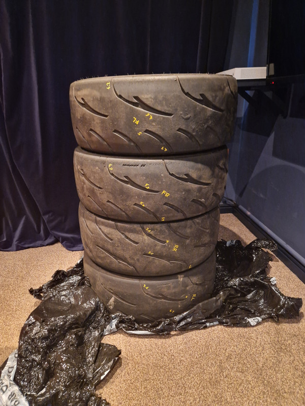

Not sure if anyone else here noticed but Darkside had/have a massive clearance on spare bits and bobs. I was quick enough to snag the AR-1's from their Mini development car, only seen one track day at Combe and after checking the depths, two of them are like almost new with around 4-5mm left (these only come with 5.5 when brand new) and the other two about half worn at about 2.6-3.6/4mm. Easily 2 full track days in them, maybe 3 at a push.
Anyway.. I bagged them for £170 delivered! Considering just 1 brand new Ar-1 is £180 what an absolute bargain. So chuffed with that I had to brag about it. :grin:
It was also interesting to see they had them mounted oddly. These tyres are supposedly non-directional but you can see by the wear that they've mounted them as if they are. They're marked as having an "INSIDE" and "OUTSIDE" to the tyre where as the NS2R's have a directional marker, I contacted Nankang anyway to confirm and they specified you must have the OUTSIDE label on the OUTSIDE and that even though the direction looks odd this is expected and part of the tyre design so they were Darkside were seemingly running the INSIDE on the wrong side which is strange.... maybe it doesn't matter and its just a tyre balancing thing but found that unusual anyway.

Bargain! They look meaty and grippy!  Weird switching the rotation round like that.  Maybe they had their reasons as they're all about track work there?
Yeah I thought that. I wonder if it's just an over sight on their side as maybe as Nankang did confirm that 100% it does give a non symmetrical look when setup correctly. Maybe one sides sidewall is stiffer to the other or something?  I drove the ns2r's the wrong way around before anyway and it felt like easy a second a lap slower and the car was moving around a lot so I'm just going to do what Nankang tell me form now on :grin:

Yeah could be an oversight with the tyres as you say. I can see how that could be confused with those particular tyres though as the cuts aren't your usual arrow head pattern. Normally with 45 degree water dispersing cuts, you want the trailing edge pointing to the back of the car, if that makes sense, to force water out the sides rather than fling it into the middle of the wheel arch.
I would say they should have fitted them with the row of smaller cuts on the inboard side, but I'm no track tyre expert.  Looking at the inboard camber wear, they had them reversed as you say  :grin:

Yeah they do look pretty useless in the wet with the water being pulled in? :grin:
