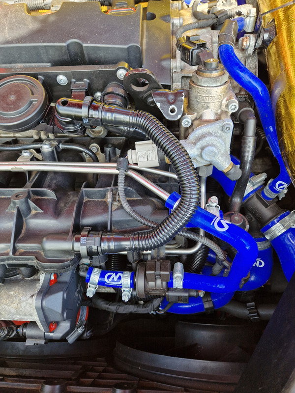

Ditched the ECS tuning silicone pcv hoses and opted for the genuine ones. The ECS ones were not great frankly - they were very slimey oddly just to touch and the upper one started to tear where the clamp was on. R Tech told me they were not convinced by them too. None of the big power cars have issues with oem ones so going to stick with oem now, think it's really just a case of go full catch can or keep entire pcv system oem.

Yeah keep the PCV system OEM as it works spot on  :happy2:  Maybe the ECS hosing isn't oil and fuel rated as it shouldn't be slimy and tear apart easily. Proper industrial Oil/fuel rated silicon hosing is generally far more expensive than regular silicon as it has a special lining in the bore. I say 'fuel' because PCV gases have a lot of unburnt fuel in them, and petrol is a solvent to silicon, which destroys it far quicker than OEM rubber and plastic hoses.
I remember in my very naughty days of dumping the PCV gases to atmosphere via a long regular grade silicon hose pointing at the ground.....yeah....the hose turned to mush after about 6 months  :grin:

I had that ECS pcv hose and it collapsed when the engine ran. Stuck the original plastic one back on and kept a spare for when it gets brittle and cracks.
I've heard that happen on others before but I definitely believe it could happen on the ECS ones too.

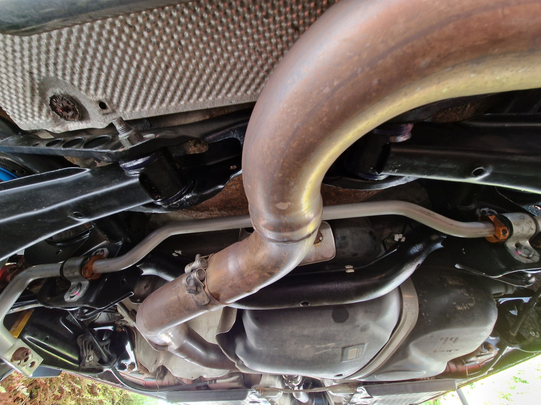

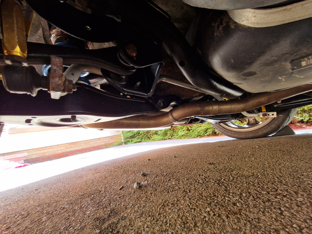

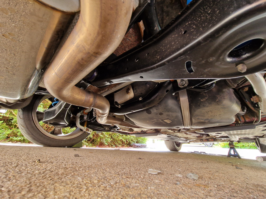

Back from Retro Resus! Although the throttle body starting mis-behaving on the way back which will need some attention as it almost did not make it home! I'll do a TB alignment and see, if it happens again I'll just stick another 2nd hand one on.

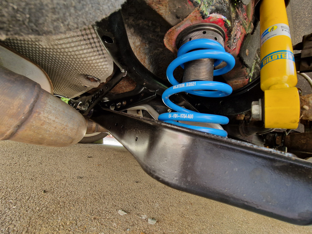

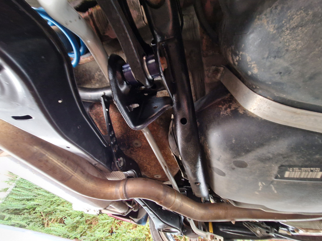

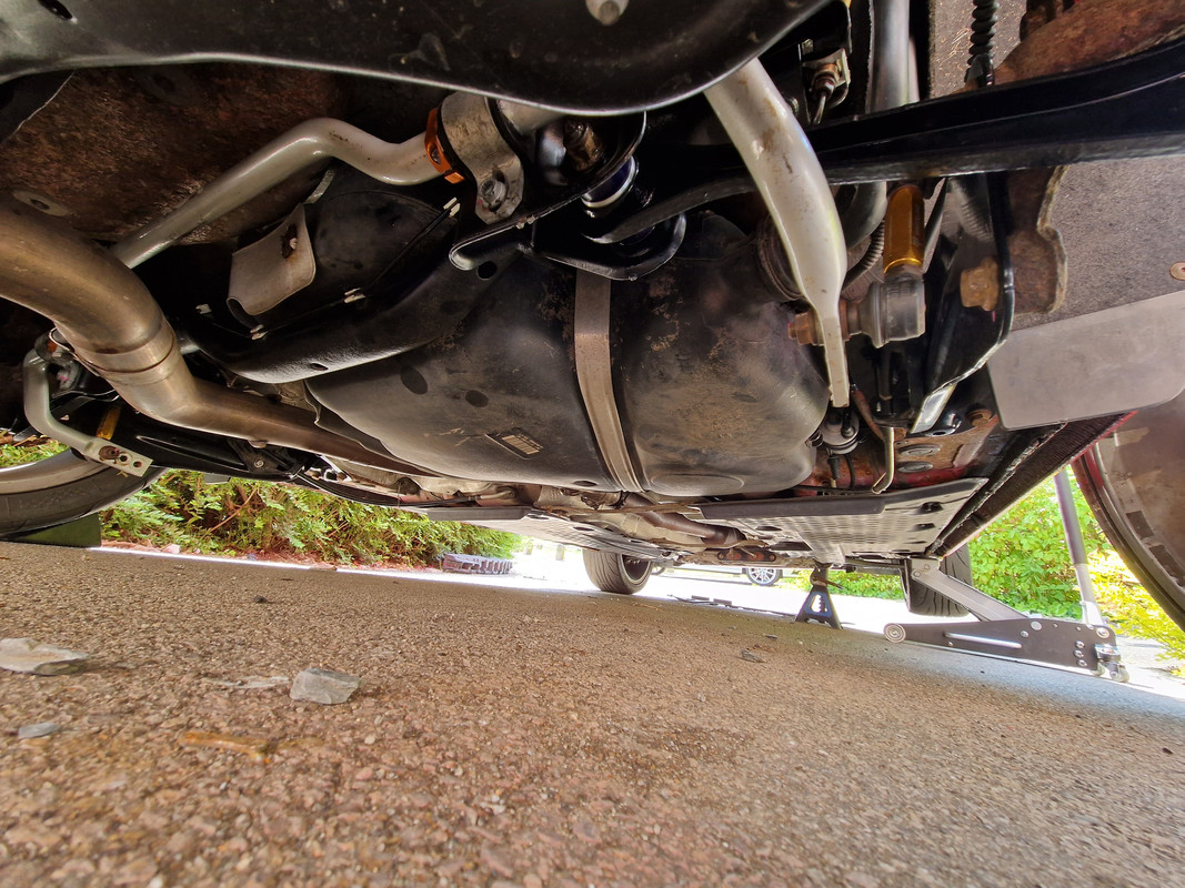

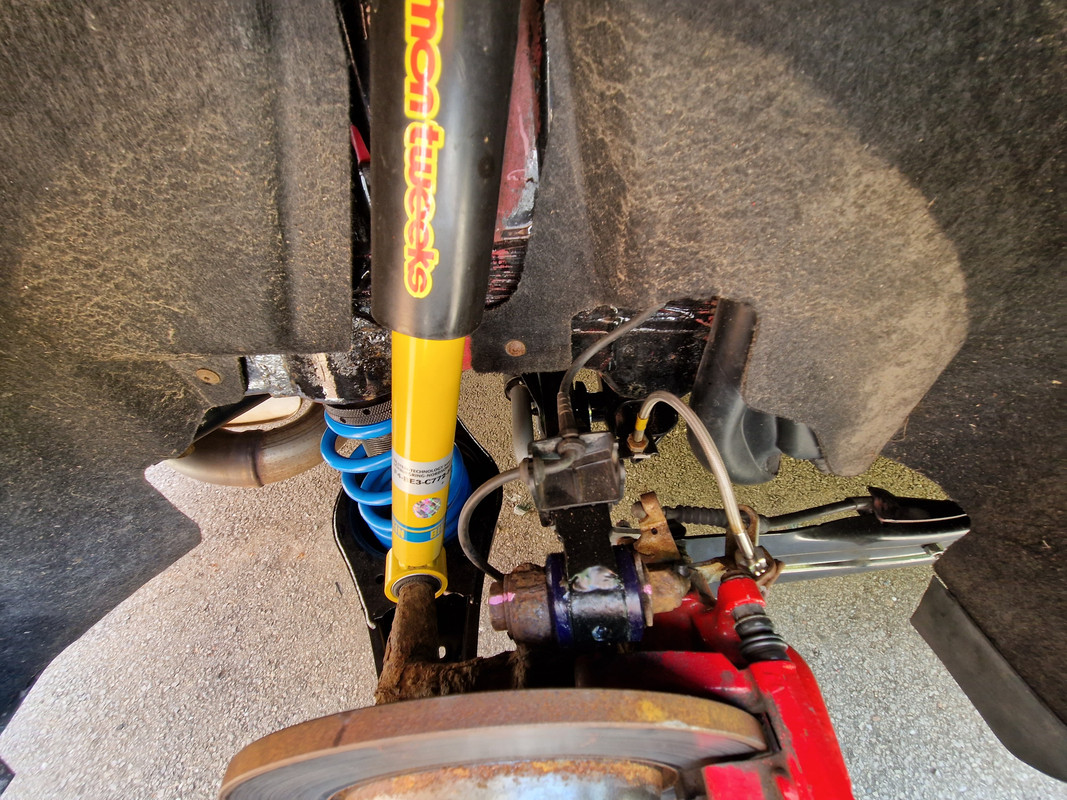

Now fully polybushed front and rear with SuperPro. Interestingly, the ride is substantially smoother which I didn't expect, those old bushes must have just been that bad! I did notice they replaced one of the control arms so it was corroded that bad so it was in quite a state in the end. Another unexpected surprise was the car is much more fuel efficient, a quick 20 minute drive across the motorway to home and 1 or 2 hard pulls so not driving economically really saw over 40mpg on average, nice surprise that!
I did have a chat with the owner Tom at Retro Resus about a cage for next year, got a rough estimated quote for a drive-in/drive-out weld in Production Gti championship spec cage. So next spring hopefully that will get sorted.
As all air bags are now out I forgot I actually have no horn now :grin: So I will have to wire in a button soon for that.
Max'ed out front camber (somewhere around -2.3/-2.5 degrees) and 0.5 degree less camber with 1mm toe out on front and 2mm toe out on rear. Looking forward to testing at Castle Combe sometime soon.

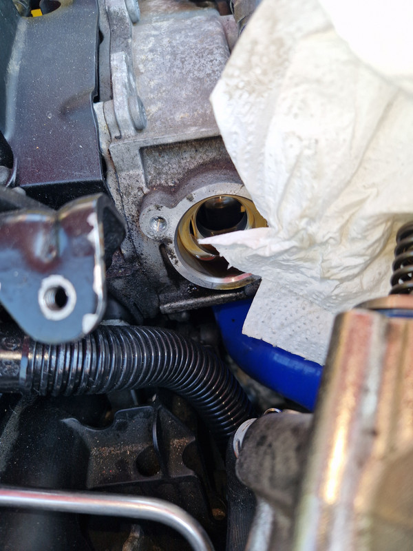

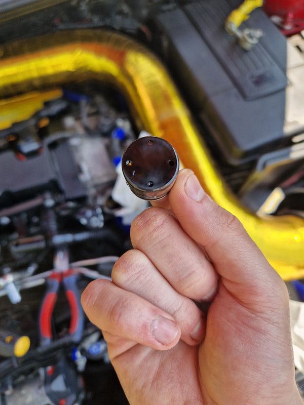

Checked cam follower today, I do check it every it about twice a year or so as it doesn't take long once you've worked out how to do it quickly. Still like no wear at all, they do last much longer than a lot people say for sure

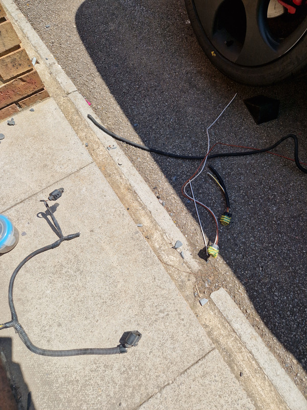

Stripped out some wiring from the fog lights too being as they are no longer on the car anyway so may as well cut out

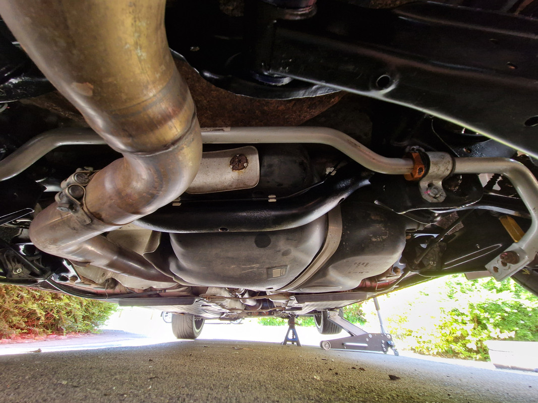

Hard to get a good picture but here are some snaps of the rear end fully powdercoated:

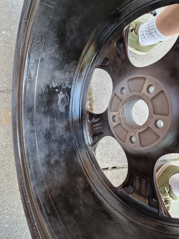

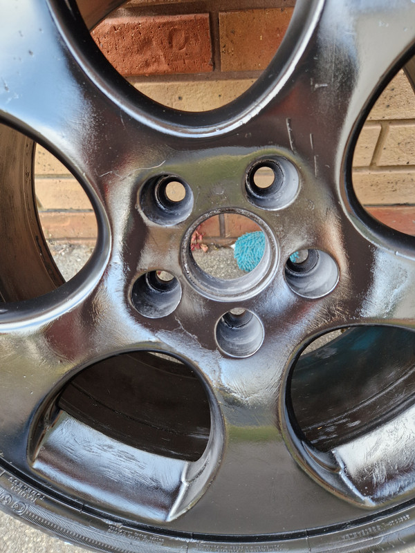

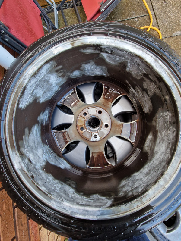

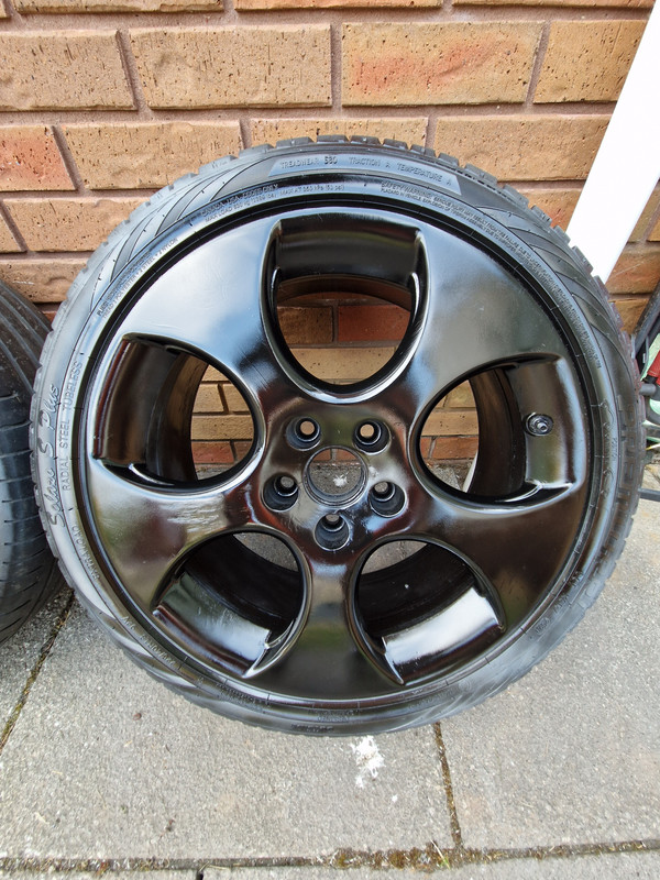

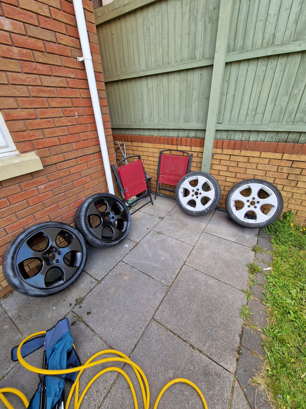

Started refurbing the second set of wheels, damn they were corroded badly. Wire-wheeled/sanded out any corrosion and have started painting. Its a bloody rough job :grin: but they're only track wheels so not too bothered.

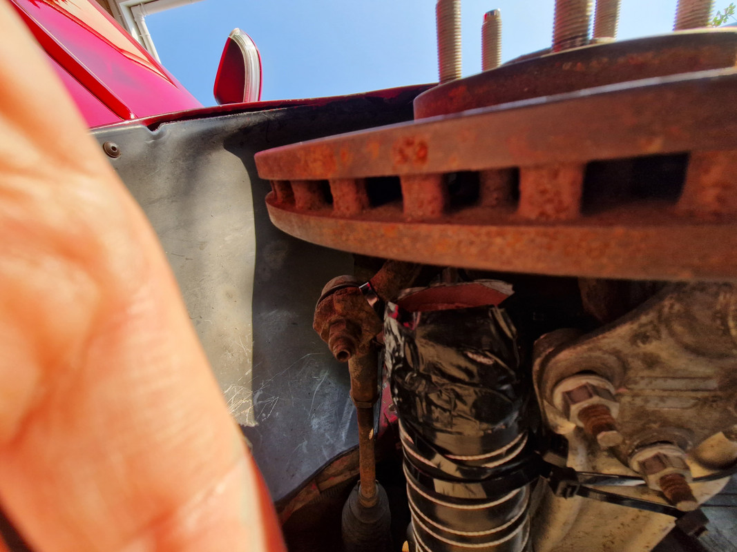

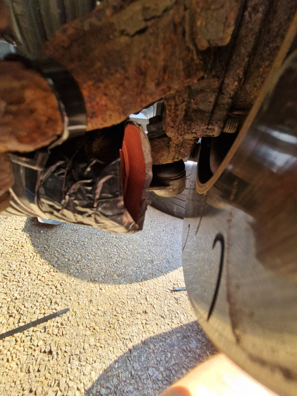

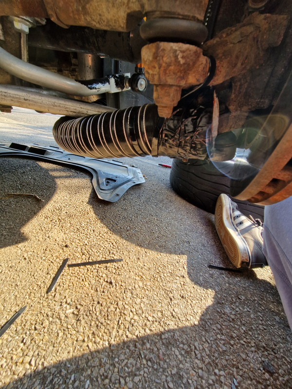

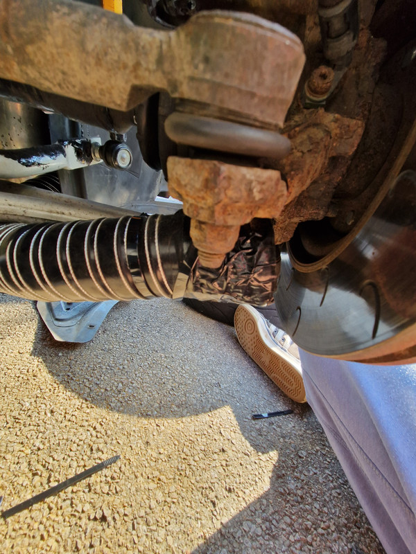

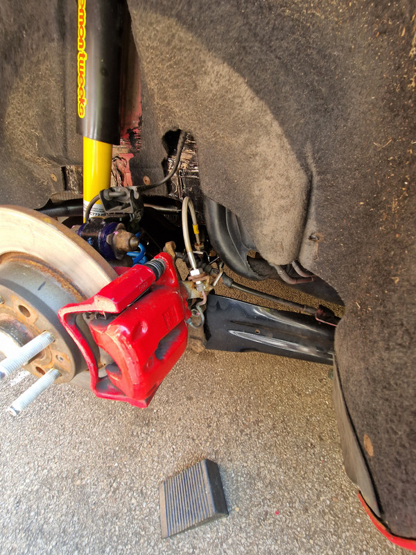

Attached some brake ducting, got it as close to the centre of the disc as I could with some beefy cable ties trying to angle it, it fouls the duct on full lock but only slightly so not too worried.
I road tested this, with one side with the duct taped up and one side open. No difference though in temps. The disc was about 230 degrees and the caliper about 95 degrees, I usually see double this on circuit so it may not be totally useless yet. I'll have to test this at Combe soon to be 100%, if it still does shows no progress then I will probably get the MQB ducts and modify them to fit the mk5 and leave it at that... https://www.akstuning.co.uk/shop/home/425-genuine-audi-rs3-8v-brake-ducts-retro-fit-for-other-mqb-vehicles.html
Its still only a 2.25 inch duct, 3-4 inch is well written about as the ideal size of a brake duct if required but its hard to find clearance, it can be done though with some strategic modification with a hammer on heat gun I'm certain of it.

Build up better brake ducting

Relocate battery

Dumping the A/C was on my todo list as it's crap anyway, even when working properly, and you can feel at idle the engine doesn't like the extra load of it. It's easy to remove, get a non-AC drive belt from AKS tuning and you're golden  :happy2:  It also frees up more air flow to the intercooler  :happy2:
I think you just need to put a load resistor on the pump connector and low and high side pressure sensors to stop the HVAC module moaning.
I'm not sure that 4" fan would do a whole lot if you've got a helmet on tbh.  Probably better than nothing though  :happy2:

Definitely move the battery to the boot if you can be bothered. The arse end could do with more weight over it.  You could use an R32 size rear silencer and fit the oem R32 battery cubby hole panel? It sits the battery nice and low, which has centre of gravity benefits.  You can also grab an R32 battery harness from a scrappy and wire it all in as per oem, which will prevent any weird electrical fault codes  :happy2:
So yeah, weight reduction, and also weight redistribution rearwards is the order of the day  :happy2:
