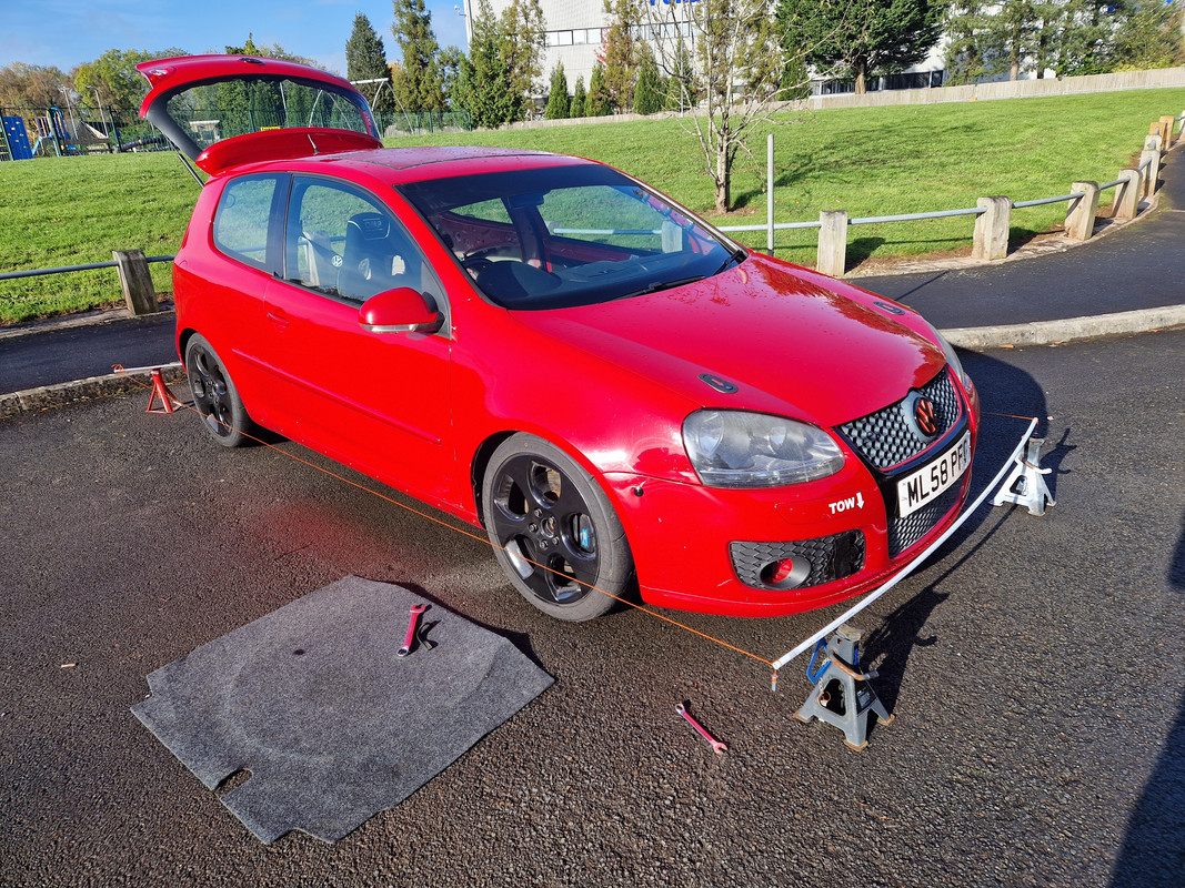

Bought a cheap little camber guage, you have to calibrate it everytime you use it and it does un-calibrate itself which just a single violent shake so got to be very careful using it but I just wanted to see how much camber I was roughly getting with the top mounts and if I could adjust them to still hit my target of -3.5 up front but with a bit more castor by rotating the top mount to move the strut rearwards. But.... when setting the camber at max both sides on the front it showed 2 degrees on the left and 5 degrees on the right? I think possibly the floor was not perfectly level (it was by eye though) and the subframe might be in some really weird position so I'm just going to try and get the subframe in a happy position for now and set the front camber to -3.5 via a trusted shop and if there is plenty of room left in the camber aligning area then I'll know next time I can add more castor.

That is a bit rubbish to be fair, I've toyed with the idea of string aligning myself but nah... It's so much effort into it on jack stands and so easy to read stuff wrong unless you have pricey equipment. I've got some basic toe plates turning up soon but that's just so I can get the car driving straight to take it to a trusted shop for a proper alignment rather than getting kwik fit to do it every time for £60 just so I cna safely drive to have a proper alignment afterwards :stupid:

Getting it close with string or camber gauges is fine to get you somewhere.  4 wheel alignments aren't cheap and annoying if you have to keep doing them with every suspension tweak!

After taking the shocks off and on so many times the wheels were allover the place. So I tried doing a home alignment for the first time, it was actually okay and the car drives straight about 90% of the time, its just adding a lot of lock when parking or navigating around low speed tight bends where you noticed its a little askew but perfectly safe to use and drive to the MOT and for the 1.5 hour trip to Taunton to get retro resus to set it up properly.
So after test driving and confirm it aligned okay I got to test the new 550 front/450 rear spring setup. Despite being about 1kg/mm stiffer front and rear the car actually rides far better on the road as well as being stiffer in total.... I really do not understand the point in progressive springs, they just seem to ride like crap and give less performance. The only issue I have currently is now the top mount is mounted lower, it means the angle of the drop link is less up-right and when I have the ARB on full hard it is genuinely only has about 2mm of clearance from the driveshaft! Full soft and medium the clearance is fine though, I do want to run it on full hard though too as for anyone who knows Combe, the exit of the Esses (first chicane) there is so much camber that you can lose a lot of time by having too soft ARB's. I might just ask Retro Resus to see if they can wiggle stuff around next time, I cant be asked taking subframes off in the winter months frankly!

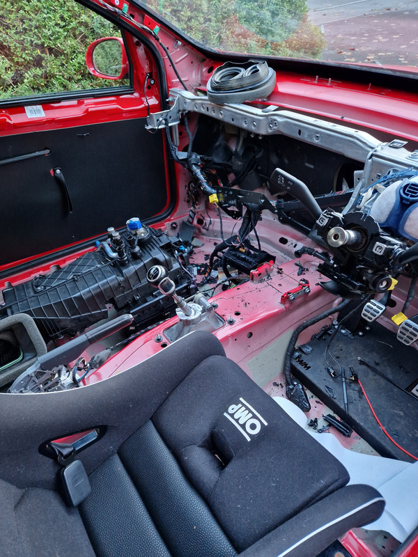

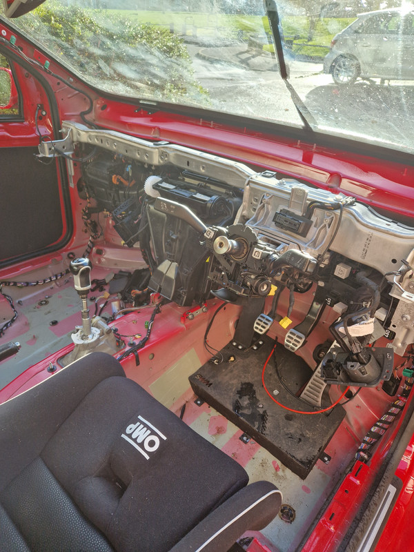

So it passed its MOT.. somehow! And now roll cage prep and further lightening has started!

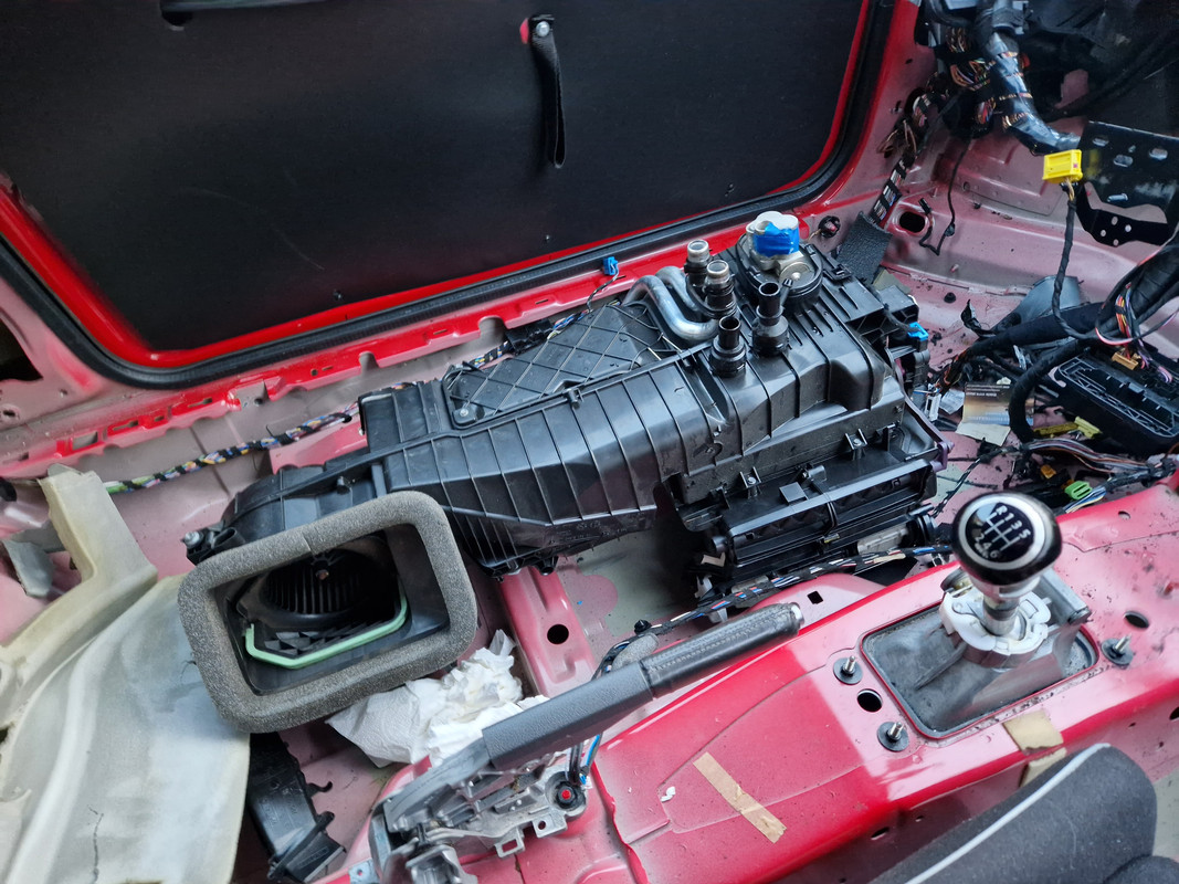

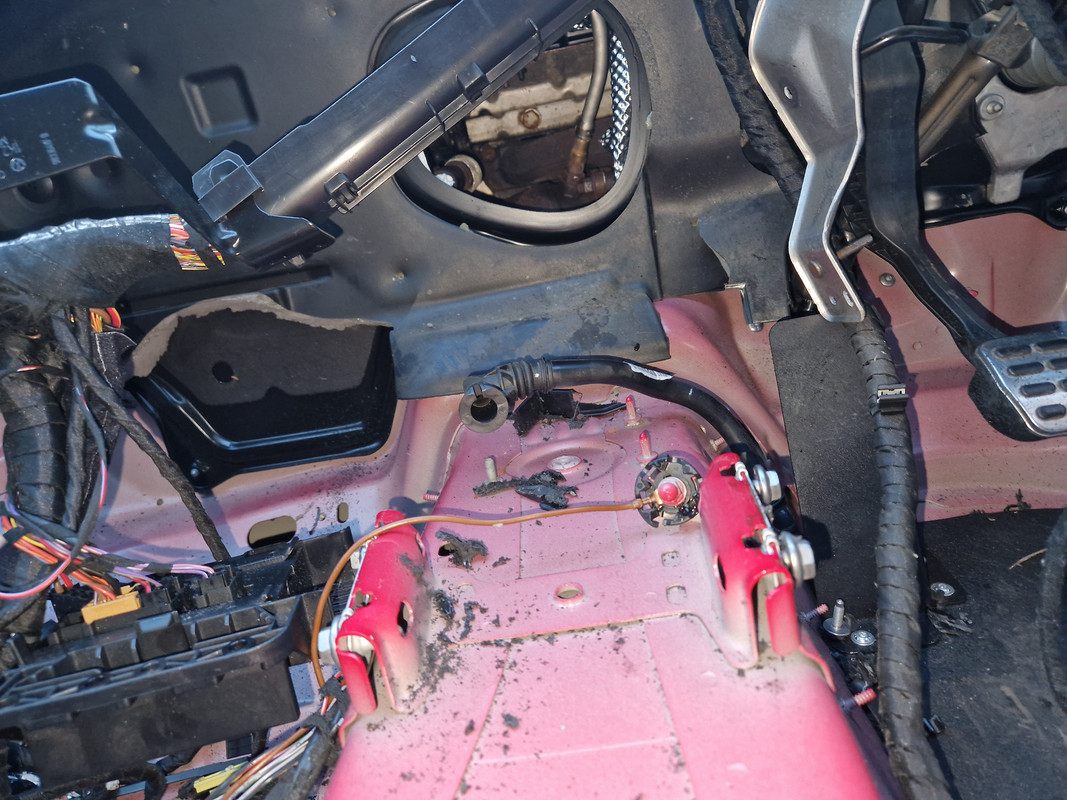

Trying to get this heater core out without having to drain the coolant is my current challenge, I just can't be asked getting under the car in the crappy weather right now :grin:
The heater core is 100% going though, I imagine it weighs a fair bit looking at the size of it and it has a TON of wiring in it too. I will need some rainex for the windscreen and rear window then. Part of me is thinking of keeping the heater matrix however, as it will act as a sort heat sink, I could possibly run a small duct to it or from it also for more cooling, my only concern is will it be impossible to stop the interior getting rediculously hot?
The main to do list looks like the following currently:
- remove as much wiring and unrequired items as possible
- relocate battery to interior (need a new gel battery)
- install new steering wheel
- ditch heater core for lighter solution
Its not going to be a quick turnaround I imagine though, as its all quite a mess right now! I'm still in two minds about adding a fibreglass vented bonnet and plastic windows for the front as a light bonnet and gutting the doors out and adding plastic windows equals about 30-40kg in weight saving! and all from the front end. We will see..

So I did try grinding the heater core into bits to try and get it out as a quick route but.... that does not work it turns out :grin: just made an enormous mess instead. I just spent some time doing it properly today and got it all removed. As you can see there is sh*t everywhere now :grin:
Feels like it weighs 5-7kg as a unit, but then there is the excess wiring, vents, the AC rad, condenser/compressor etc. By the end of it I think its a minimum of 20kg in weight if you ditch the entire AC and heater/blower system.
Nice big hole to fille now, not decided how I'm going to do it yet, will have to do a little research
Need to do a little cleaning and then I can start looking at removing unused wiring from the harness while there is lots of space + room, got some auto electrical tape to "try" and package it all neatly back together
Lots of other little bits to do, wiring new buttons, removing anything not needed, moving the battery to a much smaller gel battery inboard instead. make a nice fancy abs control panel for the centre console which is one job I'm actually looking forward to. cap off the coolant hoses, plug the firewall hole and some other little things I'm sure.
I need to consider what I am going to do about the doors, I would love to gut them as there is about 15kg each to get out of them but I need to find out if the cage is enough side impact protection or if I ought to retrain the crash bars in the doors.

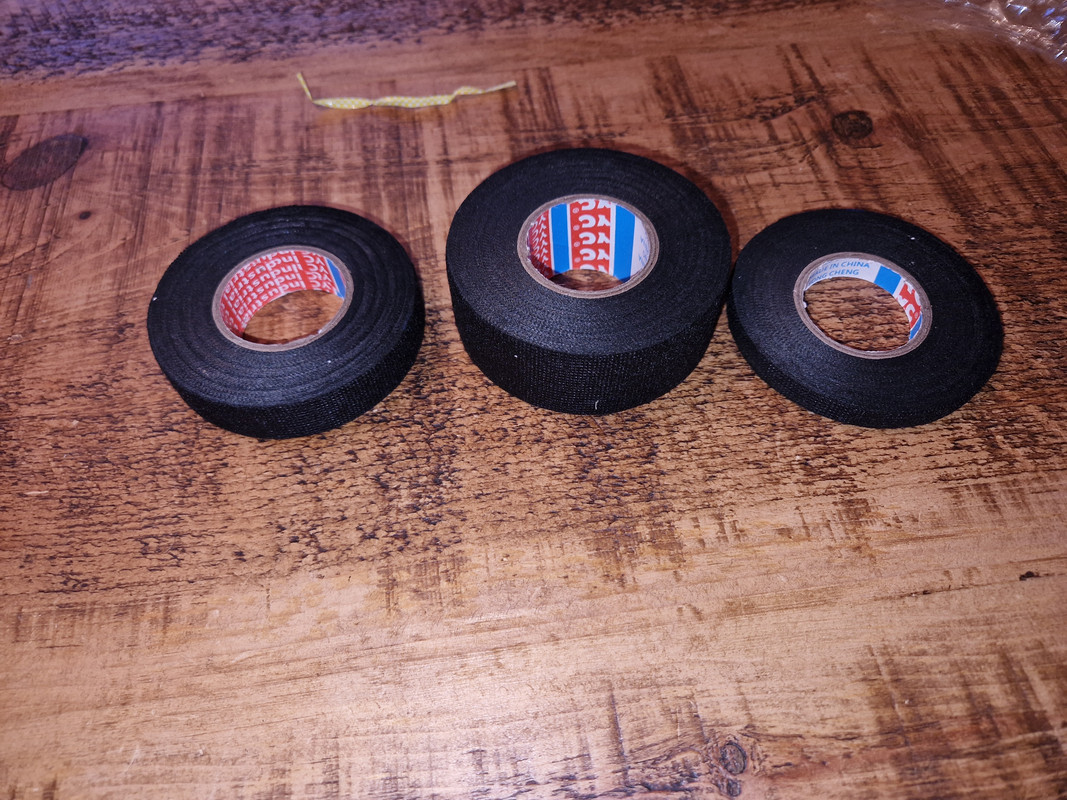

Is that harness tape the OEM style soft felt type stuff? If so it's really good  :happy2:
