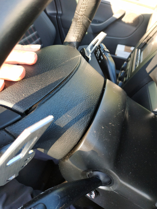

Can you take a picture to explain what you are asking?
Might be me being thick then. Is it the section in line with the buttons(blanks in this case) that prises off?
Offline Jb55
  • Posts: 205
Re: Mfsw buttons retrofit help
« Reply #14 on: February 27, 2021, 04:57:24 pm »
You need to remove the airbag from the steering wheel
