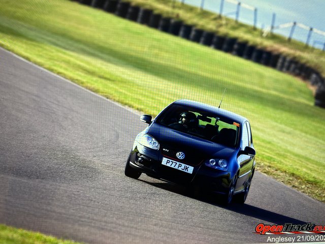

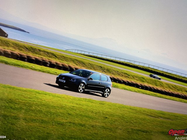

Hi Guys,
I am after some advice for a set of track day wheels and tyres.  Last year I took by beautiful Mk5 GTI around Anglesey for it's first track outing and It did really well riding on standard 18" Monza with a decent set of Michelin Pilot Sport 4 tyres.  The only modification I did prior to the trip was fit a lovely clean set of Golf R calipers along with with genuine new R discs and pads and the car was faultless.  With things opening up soon hopefully, myself and a few mates are planning another Welsh road trip with and another day at the brilliant Anglesey circuit.  This time I want to invest in some track wheels and tyres so I can push on bit harder and not destroy what's left of my Michelins!
I did stumble across an older post where someone had done the same with a set of 17" team Dynamic wheels in 17" shod with Toyo 888r's.  I like the sound of going for 17" wheels for the advantage of weight and lower tyre cost but will they fit over my calipers?
Tyre wise, I am a big fan of Yokohama Ad08r's having had them on a previous track car, I especially like their ability to clear water if it rains and perform well on road too.  I am open to other suggestions and if anyone has a suitable set for sale, I'm keen to get them now.
Thanks
