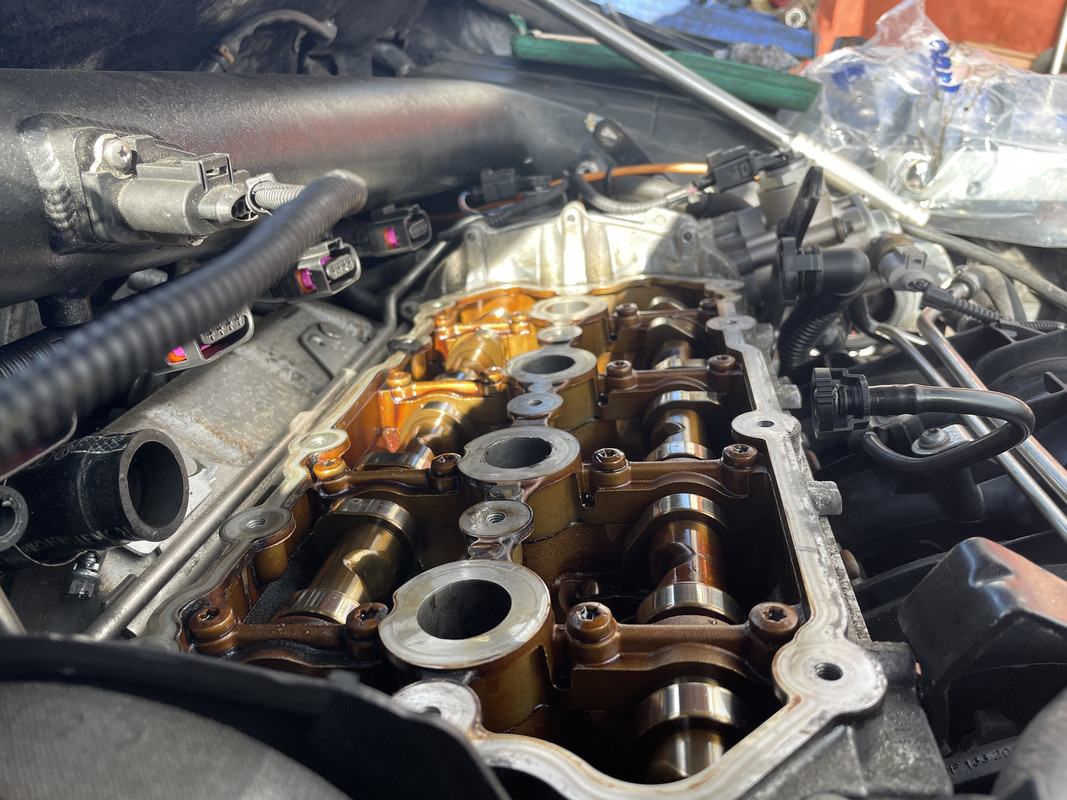

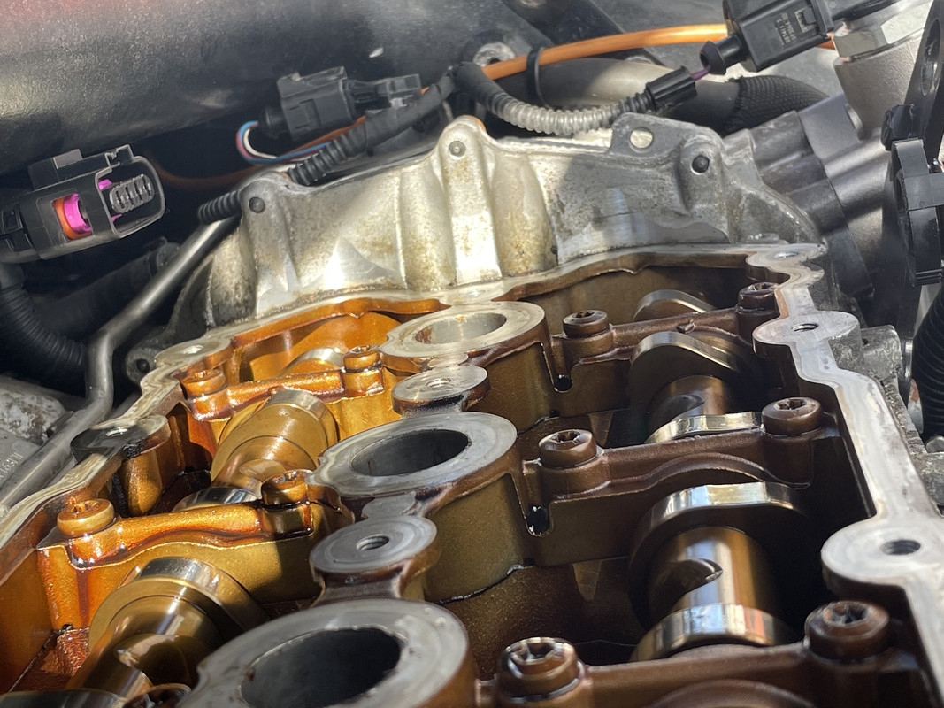

So guys my mechanic has got back to me and says that the camshaft is out? Should they all be sitting flush two of them are not sat correct. What would you guys recommend from here? Thanks
Offline Jb55
  • Posts: 205
Re: Starting issues, cranks no start?
« Reply #25 on: March 19, 2021, 01:48:28 pm »
I think you need a new mechanic
Offline DBXdarkangel
  • -Given: 18
  • Posts: 361
« Reply #26 on: March 19, 2021, 01:54:40 pm »
I second that. Maybe send your current mechanic on a course. Or buy him a book called "basic mechanics for dummies"
Offline FJB
  • Posts: 110
« Reply #27 on: March 19, 2021, 03:46:07 pm »
What do you mean the camshaft is out? The intake and exhaust cams look in the correct position in relation to each other, it looks like the locking tool would fit exactly, even if it the chain was one tooth out at the adjuster end I would still expect it to start but run badly. You need to check the intake cam timing mark in relation to crankshaft timing mark, you will need to remove the crankshaft pulley to tell.

« Reply #29 on: March 27, 2021, 04:31:22 pm »
