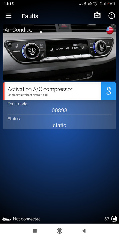

My air con has seemingly packed up just in time for the summer. There was a really bad smell in the car this morning (not me for a change) and after trying the air con this afternoon it's not blowing cold. Have the following code
What's the best way to test the compressor, should I be able to hear it kicking in? Any other checks I can do at all?

I have the same code on mine (recently purchased) that had a new compressor fitted. Be interesting to know what diagnostic measures there are.

Yeah can see it in the engine bay, no aircon. Haven't had time to get a multimeter on it yet or check with vagcom what the measuring blocks are.
