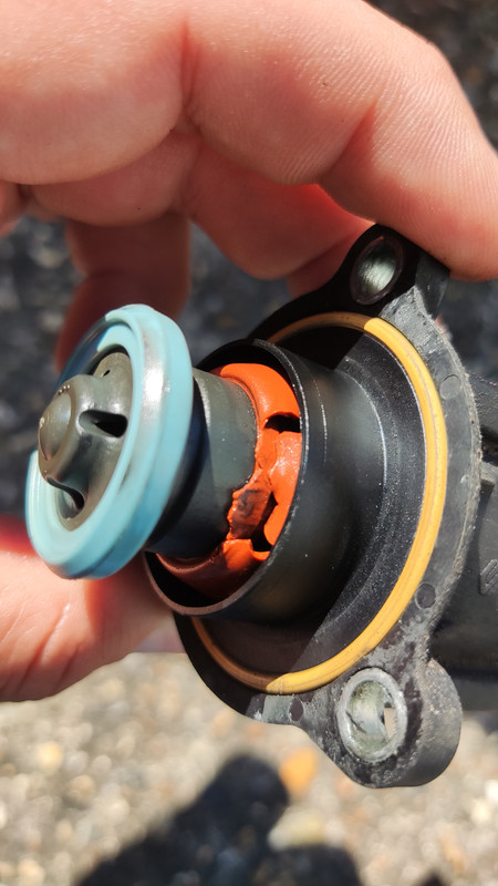

It started missfiring ever since my mechanic installed the RS4 Fuel valve. But the car before that the idle east great but never missfires. Anyway when it started missfiring again after all that work I decided to remove the RS4 fuel valve and found out the mechanic either tightened it too hard or cross threaded leaving tiny tiny fragments of copper the funny thing thing is the RS4 fuel valve is closest to cylinder 4 injector.
So am I right to think that the copper fragments have entered the injector 4 and blown it and then blew the new Injector too ?

That valve is proper mangled.  It's brass by the way  :smiley:

Injectors tend to have a replaceable mesh filter - if the brass has worked its way in hopefully it will have been caught in this

Quick update anyway the problem was indeed the small filing made its way to injector and blew it again.
