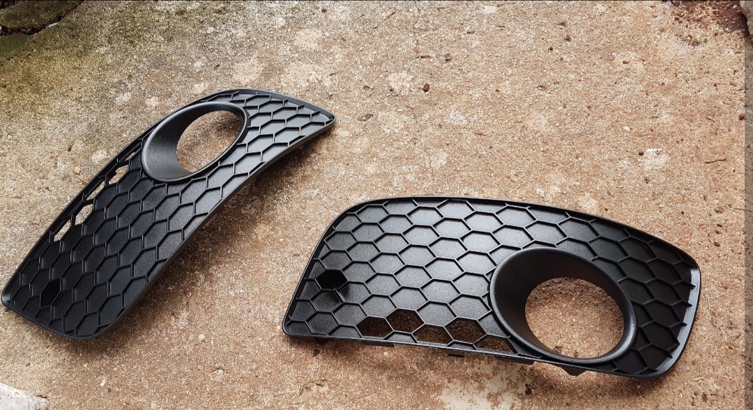

I sprayed mine. Way better than ebay aftermarket. Although I'm gonna repaint them again with better paint ha
These look great, what paint did you use? Haven’t had the courage to do mine yet.
Saw Autoglym do a plastic trim paint now. Proper aerosol spray can opposed to the dressing you wipe on.

I cleaned the honeycombe with white spirit then Plastikote primer, Halfords vw black pearl and 2 coats of upol lacquer Better than new :wink:

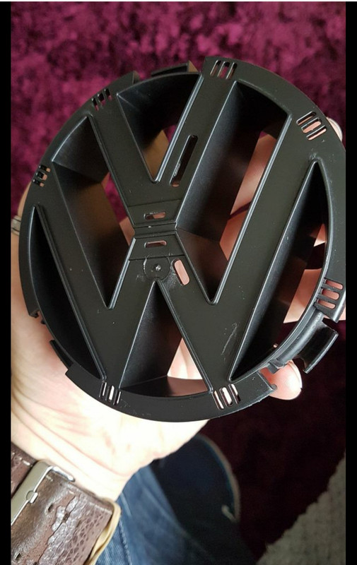

I've taken a punt on a grill from underground works. We'll see.....
I might have a go at spraying the other 3 and also the original.
In a 'pimp my wheels, mid-life crisis kind of way'  :signLOL: I want to change the VW badge to a black badge on the front and probably the rear, if possible?
Any links or tips on how to do the badges and links to where to get them please?
