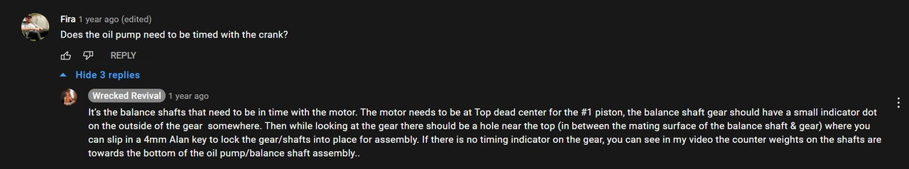

Now, I wanted to add another topic to this post about the oil pump balance shaft timing:
As I've removed the balance shaft sprocket when taking off the pump (I should've taken off the pump sprocket instead) I no longer have the timing mark lined up accurately for the balance shafts. I know it can cause terrible vibrations if not timed correctly, and I want to get it right on the first go.
As everyone else online seems to have taken off the pump sprocket (not balance shaft sprocket), not many people have the same issue as me. I did find one Youtube comment though:
Basically says, that the balance shafts should be facing straight down or 'BDC' while piston 1 is at TDC. This same idea is reaffirmed by this scientific video about how balance shafts work:

Assembly lube is made to blend into engine oil, so no need for a flush.  Hell you could even use axle grease or vaseline and it would still meld into the oil no probs  :happy2:  It's only stuff containing, shall we say, 'particles' that a flush would be wise.
'Wrecked Revival' is spot on  :happy2:  Most people taking the sprocket off are fitting free wheeling sprockets and don't care about the balance weights being aligned.

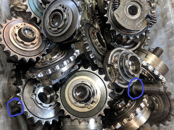

Was just doing some research in preparation for the job, and came across a guide from ECS Tuning showing how to replace the clutch. The reason I was looking at this guide in the first place is because the flywheel uses the same bolt the balance shaft sprocket does.
Pudding mentioned earlier that the torque for this bolt is 20nm + 90 degrees, but I think he mistakenly found the torque for the pump sprocket bolt instead, which is a narrower M8x22 bolt (unlike the M10x22.3 bolt I'm going to be installing).
Here is an extract from the ECS Tuning guide showing the same M10 bolt being torqued to 60NM + 90 degrees  :surprised:
I know the bolt wouldn't snap if torqued down that much, but I'd be afraid of stripping the threads in the oil pump. I can't find a manual that states what it should be torqued to.
On Youtube people use red loctite on the bolt when installing a balance shaft delete freewheel, and one said that it's hard to torque down because it keep spinning, even with a screwdriver stuck in one of the holes on the pump to stop the balance shafts from spinning. So maybe I just aim for above 20nm + 90 degrees but not much more?
I'm just paranoid I'm going to get something wrong in this repair job that will lead to catastrophic consequences for my wallet and engine :smiley:

You're absolutely right, I did mistake that bolt for the oil pump sprocket, my bad!
As you can see in the diagram below, there is no reference to the balance shaft sprocket bolt. Probably because that bolt is not available separately and therefore not relevant to a repair manual, as you'd have to buy the whole £1500 assembly to get a new bolt! Crazy! The sprocket isn't available either.  VW really don't want people messing with it do they!
I don't think 60nm + 90 (that's a bit over 100nm total in reality) is achievable DIY.  The factory must have some special rig to torque that bolt up, hence why the sprocket and bolt are non serviceable parts.
As you say, all you can do is use high strength loctite, tighten it as much as you can, and hope for the best!

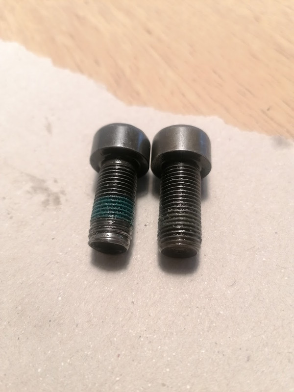

Alright, after working in 5 degree weather I've replaced the connecting rod bearings with the help of a friend. Here are pictures of two of the top half bearings, quite pitted as you can see (crankshaft looked fine):
All was going well (bar my low range torque wrench not clicking anymore) until we got to putting the balance shaft sprocket back on with the pump already installed.
The bolt was quite resistant but I thought nothing of it, as I had the idea of '50 NM' in my head and it definitely wasn't going in crooked. Just under half way in, and struggling for torque I removed it to see what was going on, and this is what I found. Left bolt is new one, right is original one that I took out:
Thankfully, the balance shaft threads seem fine, they must be much stronger than the bolt material as the seem to have carved into the bolt threads.
So it turns out I'm a bit of a idiot when it comes to making sure which bolt came from where.
While writing this post, I double checked on google images for reference to what the bolt should look like. Notice how they have washers and how the thread is much further apart than on the bolt I tried inserting.
This also means I have screwed the correct spline bolt into the the wrong place on the oil pump, marked as 'WT' on the bottom right of oil pump diagram I posted earlier. :doh: Probably completely stripped the thread on that, thankfully it only holds the plastic thing to the sump so I don't think it's too vital, I could be wrong though.
Now I need to see if I can get a replacement for the bolt with the washer or just stick the old bolt in and hope for the best.

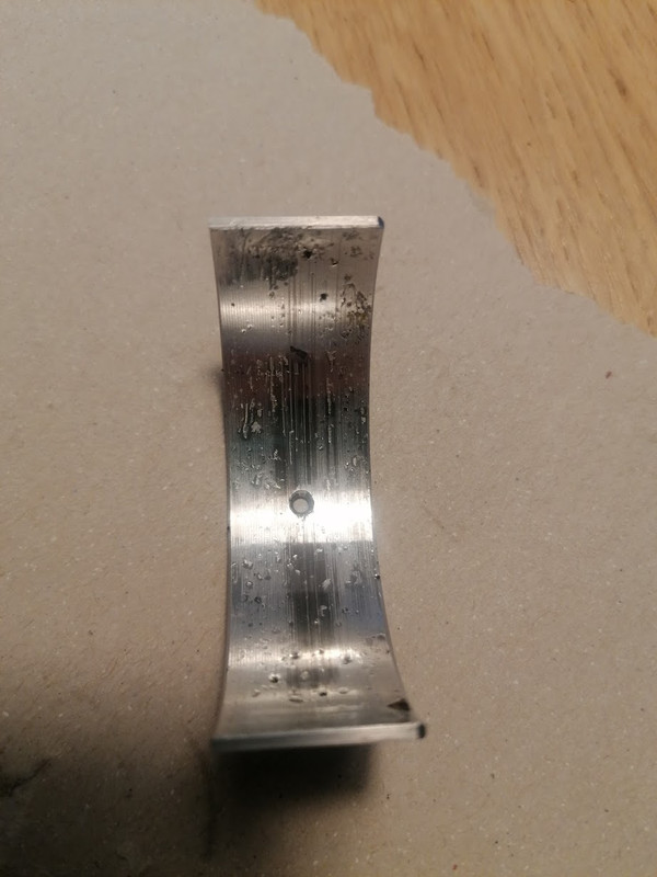

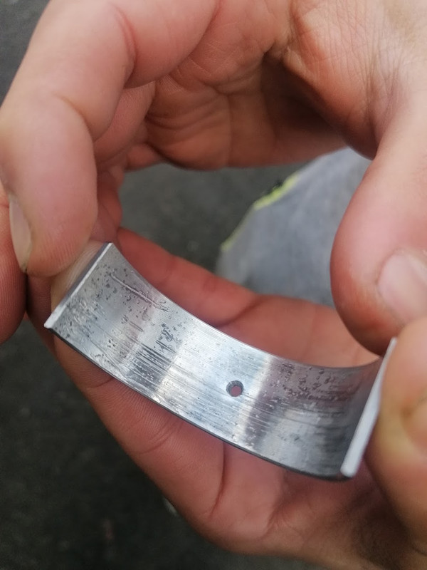

Apart from the pitting, the old bearing shells look fine.  Not sure what the pitting is all about.  Acidic corrosion from lots of short journeys?
Yes indeed, one cannot buy that bolt.  I would just reuse the old one, but just give it a set torque figure as high as you dare. Obviously you can't do the 90 degree bit again as the bolt has 'stretched' once already.

I got away very lightly with screwing in the wrong bolts in earlier - The correct bolt (which I screwed into the hole marked WT) was barely even scratched from being inserted into the wrong thread. The thread it was screwed into looked slightly mangled, but nothing a little threadlocker couldn't solve. If anyone is using this post as a guide, always remove the pump mechanism sprocket, not the balance shaft sprocket, and make sure you put the in pump chain tensioner and sprocket simultaneously, as otherwise they won't fit.
