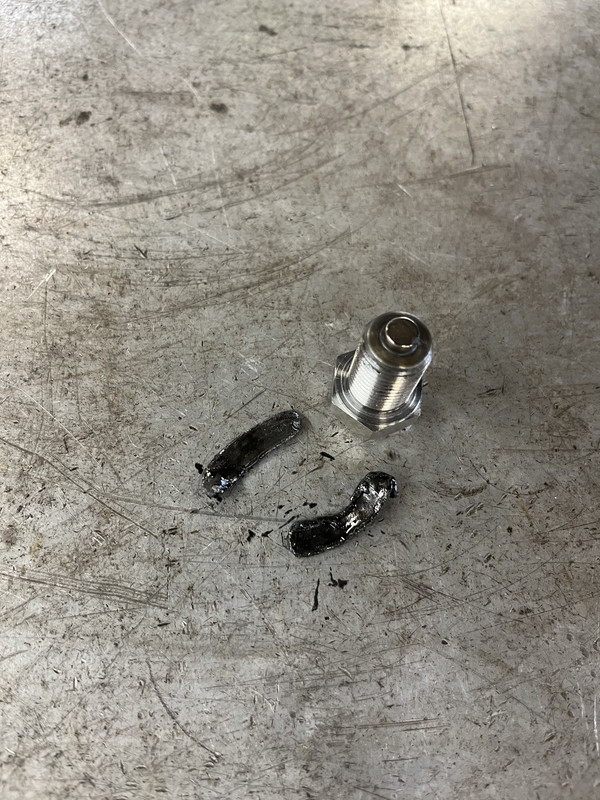

Then the biggest problem was discovered today when it had its post track day oil change. 2 random bits of metal were found in the oil.

What colour/size are the metal bits?  You're not the only one with bad luck  :grin:  They do keep soldiering on regardless though  :happy2:
There's a company on Facebook that does turn-key MK7 R engine conversions, otherwise it'll have to be a Golf 6 R/ED35/Scirocco R/S3 engine for easier compatibility.
If you can't get standard issue shims in the gearbox, it doesn't need shimming. You can't take up all the slack unfortunately as VW used plain roller bearings + circlip instead of the more usual taper bearings for some bizarre reason  :stupid:  Another cause of a sticky clutch pedal is crank walk, but hopefully it's just the gearbox, or master/slave cylinders on their way out.  Could even just need a bleed, or the friction disc is binding on the input shaft.

Crank walk? I have no idea what that is but it can’t be good! The cars got a brand new clutch, flywheel, master and slave cylinder. The gear changes aren’t the smoothest and on the track day, I struggled to get into 4th gear a couple of times.

Ok, did a bit of Googling. Crankwalk might be a reality. And those bits of metal might be the left over of a thrust bearing.
If it is “crankwalk”, is it fixable or game over?

Usually you just need a new thrust bearing if it is indeed the problem. It is unfortunately an engine out job (unless they fancy dropping the crank in situ), so it might make more sense to put a better engine back in!  Out with the old, in with the new  :grin:

Holy metal crumbs batman, I've just seen the carnage pics.  They look suspiciously like the thrust bearing remains we were talking about to me, which might explain the gear engagement issues, aka, crank walk.
The thrust bearing on these engines is a terrible design, basically only half a bearing compared to the usual standard.  I pity the later EA113 engines with the clutch down to start the engine nonsense. No oil pressure on the bearing whilst cranking.....what the frick were VW thinking  :stupid:
As for a rebuild/new engine. I doubt the cylinders or top end have suffered, you probably just need a new thrust bearing, which is like 40 quid, but the labour to replace it is 4 figures. Engine out job.

Unfortunately by Thursday the diagnosis was complete and I got the bad news. The first sentence in the message didn't full me with much confidence;
"Every now and then a car comes in and when we look inside, we are shocked that it was even running." :tired_face::joy:
So basically the crank walk is as bad as it gets. There's no thrust washers left at all, the crank has been grinding against the main cap. The flywheel has been grinding against the sump. The crank is moving side to side a good 10mm! The balance shaft has seized solid and sprocket that drives it has completely sheared off. The engine is officially scrap.
