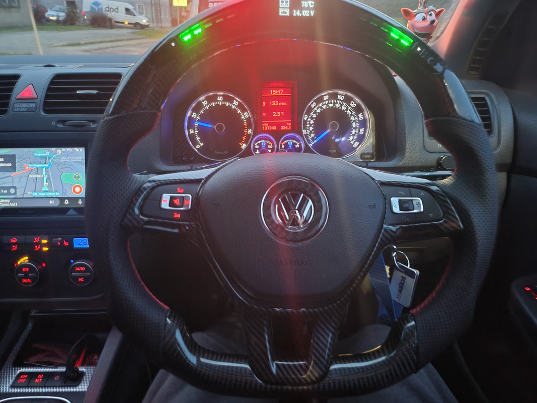

Hi everyone. I have nearly completed a Mk5 to Mk7 steering wheel conversion. Took me a few months to get this far, plenty of research and plenty of questions. Many hours testing options.
I am 99% complete. I finally need to get the LED lights to function on the right hand side.
If anyone has an ideas on how to get the otherside to work, oidbe happy to listen..
The buttons I have are 2h0959442

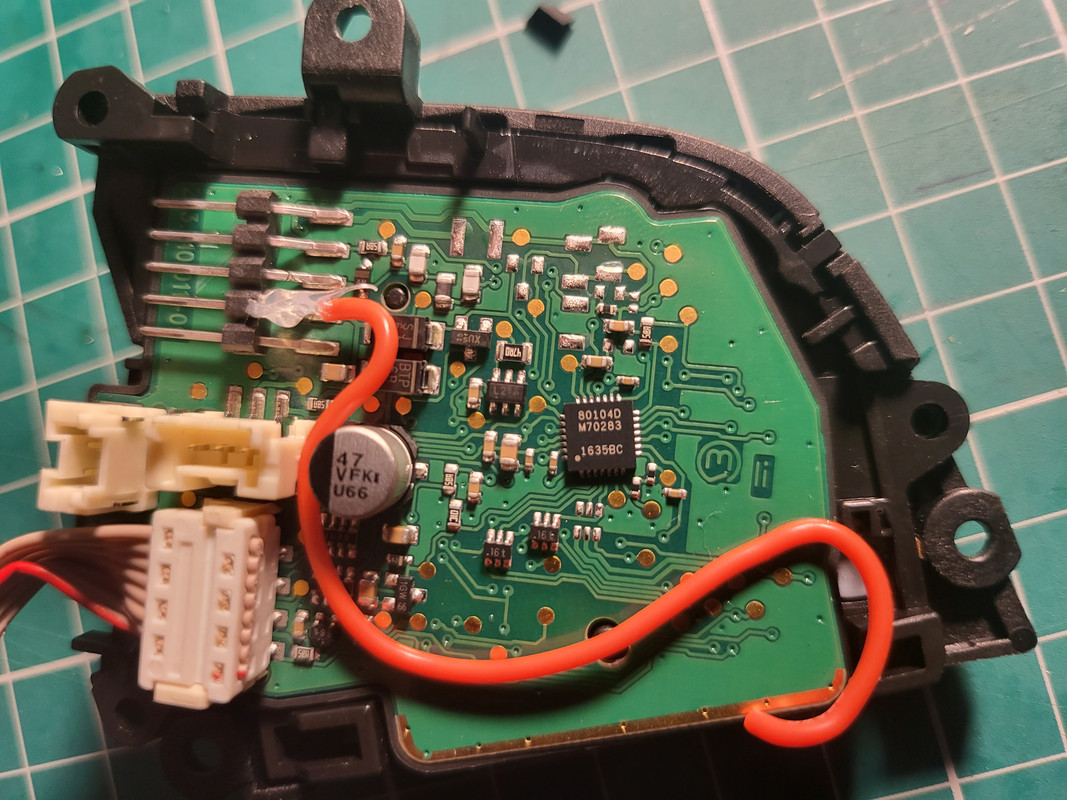

« Reply #2 on: December 24, 2021, 02:48:07 pm »
***SOLVED***
OK, just incase anyone else comes across this for help. I worked out where the second wire needs to be attached to get both sets of lights to work.
PLEASE NOTE, the is for unit No. 2H0959442
