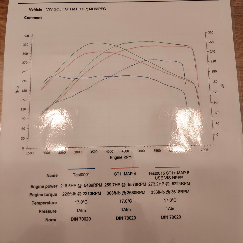

Yeah, R tech did a stage 1/stage1+ for me recently. So map 4 is effectively a stage 1 with 260bhp and map 5 takes advantage of the VIS internals and makes 273 with about 30 foot pounds more torque. This with a stock downpipe but with the pre cat delete.
If you tell your tuner they should be able to do the same sort of thing, up to you then to decide if the maybe 10-20bhp extra is worth it.

@Clarkj93 - i saw your dyno charts on RTech’s facebook feed and it’s a cracking result. Never mind the bhp as these turbos can’t flow much air but look at the extra area under the torque curve! I also have a stage 1 k03 car with precat delete and a vis pump fitted and even though the pump hasn’t been mapped into the revo software you definitely feel the extra torque and consistency.

@Lewo I have not driven it yet on map 5, they did it without me asking essentially, my guess is as it was making good numbers for stage 1 they popped in a VIS internals they had knocking around for another customer in to see what kind of numbers they could get. Works for me as when I get bored eventually of the extra power il just go buy the VIS internals and boom extra 30 ft lbs of torque with no new mapping session required.
Going from stock to stage 1 was 77 ft lbs of torque and that feels an enormous difference so I imagine the extra 30 ft lbs (roughly half the amount of gained torque between stock and stage 1) should still feel a noticeable difference.
I've been looking up a few dyno sheets and results since and to be honest it does look like stage1+ is a decent alternative to going stage 2 with an expensive sports cat down pipe as it seems very very similar numbers (I've seen stage 2's produce less than my stage1+ map sometimes) and a fair bit cheaper to do also.
