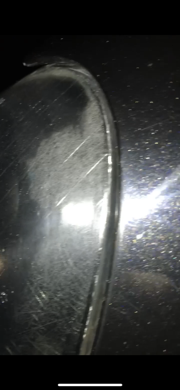

Back in March, I had a go at restoring the headlights. I have the standard lamps which are plagued by the yellowing lens problem that all vws of this time have. The headlight was murky, rough in places, the beam was unclear and just all around looked awful.
I had a go at trying the Chrisfix technique which involves wet sanding the plastic lens back and then applying UV protective clear coat over the top to preserve a long lasting finish.
As I had chose to do this in the colder months, the laquer application wasn’t the best and I really struggled to get it into the top corners at the bonnet / wing body line. The cooler temperatures and changes in wind just made it a bit of a messy task.
Any way they do look much better than they used to and after 6 months they are still holding up pretty well! The lenses themselves have a good amount of pea sized smashes in them from stones which only became visible once I’d polished them up, I think next time I’ll just get replacement lenses.
Not a bad effort for the cost of some plastic laquer and a few of my own hours. It should last for at least a year from now I reckon. Apologies that my photos are gash, it was the sort of job that I just wanted to crack on with and not to botherd about documenting.

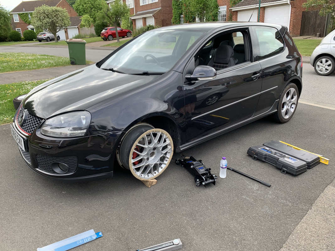

Modifying a golf gti continues to prove to be a steep learning curve, it seems even the simplest changes I have in mind need hours of research and consideration before pulling the trigger. Here’s my latest headache:

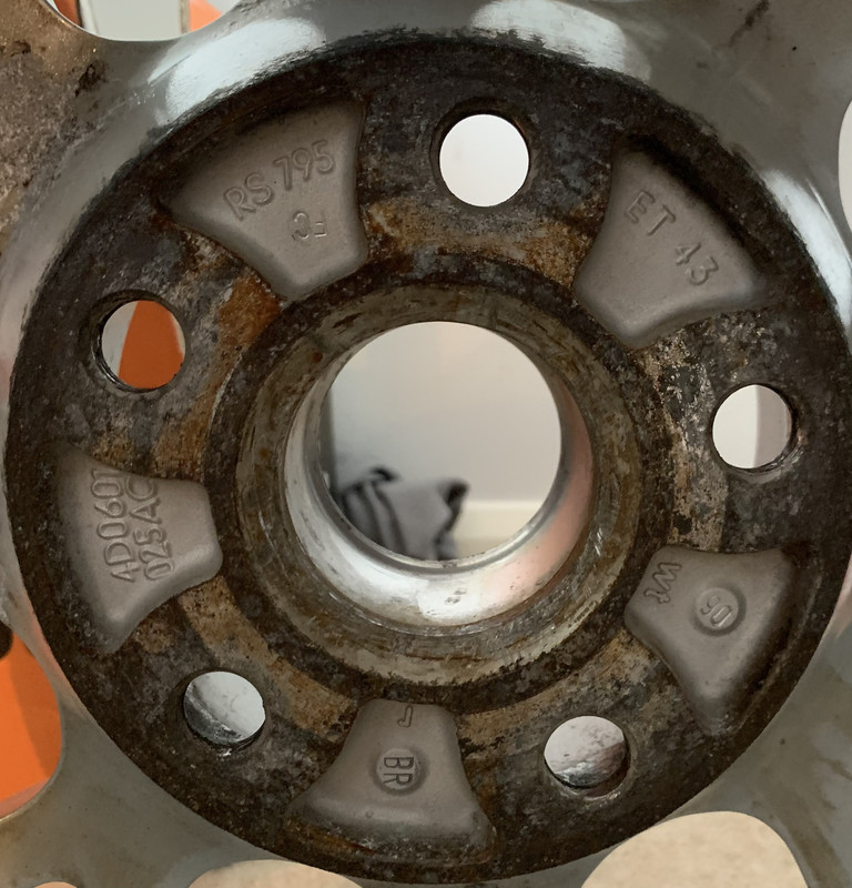

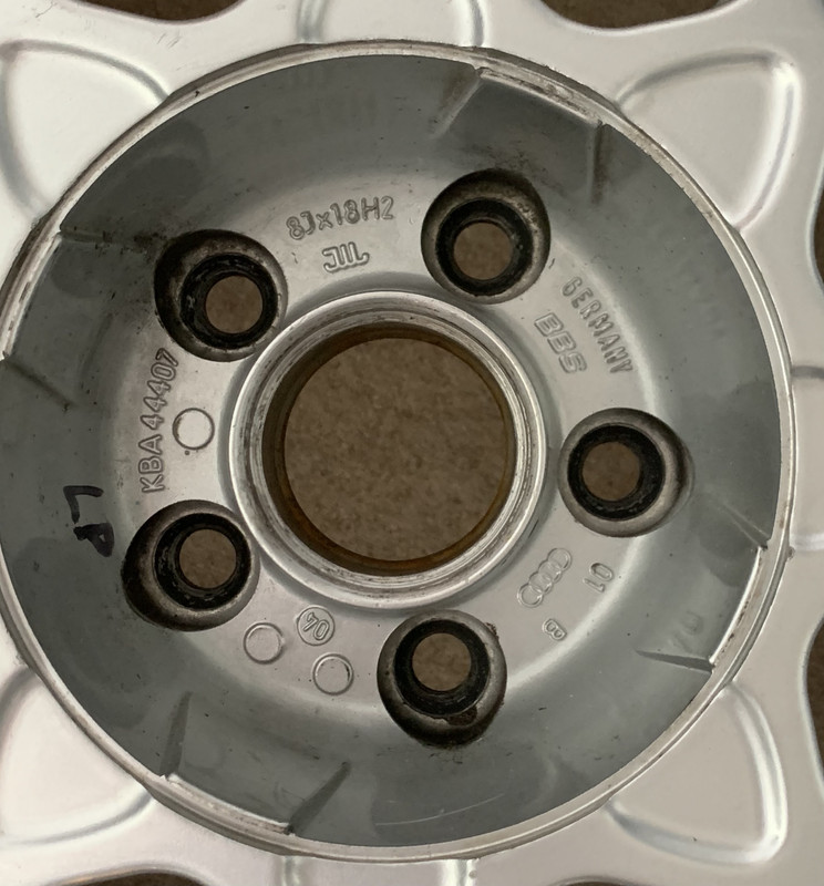

I bought some wheels back in June with the intention of refurbishing them and installing on my car. While I had been very tempted by the weight savings of a set of OZ alleggerita, I ultimately went with a set of ‘blingy’ BBS in my endeavour to do something a bit different. The one pictured is the nicest of the set of 4 which I honestly could not be bothered unboxing all for a photo.
I managed to source a fair condition set of BBS RS795. These are often referred to as the RSII and I believe these were an optional wheel for the S4 and the A8 of the early 00’s although I’m not 100% sure.
I paid £450 for these in fair condition which I think is reasonable as this wheel isn’t easy to find for under £1000 for a full fresh set with centre caps, centre nuts, all the rest. These wheels are heavier than my 17” Monza however my logic is that they weigh identical to the 18” Monza II so I’ve gone up 1” in size, and an extra half inch in width and still remained the same weight as the optional 18” wheel. Not bad eh?
The specs of the wheels checked out with similar setups that I have seen and they are a direct fit with no modification. With the mild lowering I’m aiming for, they shouldn’t rub in normal use with 225/40/r18 tyres.

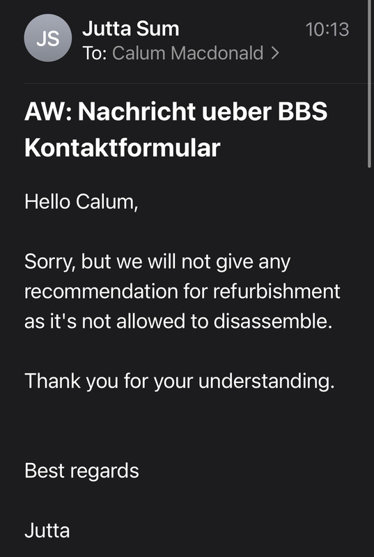

All seemed well until today when I enquired with BBS to get the correct paint colour for them and was informed that they must not be split when refurbished as this would make them unroadworthy. Now I assume that there is really nothing wrong with splitting a wheel to refurbish as long as you use new bolts and torque them in order, to spec. BBS just won’t want to be liable for anyone who doesn’t secure them properly.
I’ve run some costs myself and it looks like £562 is what it’s gonna cost to refurbish them. That’s a lot, but that’s just how it is for multi piece wheels. Since today I have learnt that the process for removing the face is more arduous than I expected. The bolts need to be heated to be extracted and extraction often results in some broken bolts and the thread needing tapping again, or worst case scenario even helicoil.
All of this has made me a bit uncertain about the aesthetic and (negligible) performance gain that I would get from this wheel set up. If anything it just makes me more mad that I missed out on a set of good condition 17” alleggeritas for £600 with tyres on eBay!
Anyway when they arrived I tried one on for fitment. I used a piece of wood which mimics the size of the tyre wall (yes I now know I should’ve rested the wood on the barrel not the rim). Because the springs hadn’t settled after being lifted the ride height hadn’t settled either and looked odd but gave me a good idea of what to expect.
For reference, the wheels have 2mm clearance inside the arch from being flush, I didn’t imagine they would be this aggressive initially. The brown tape was a mistake, left marks but never mind. Would be good to know what you guys think? I’m really split between selling them and finding a more suitable 1 piece wheel or just go all out and put them right.

I do like those RSII's - I can remember being parked next to a new at the time big Audi with those on, very nice.
Lots of people refurb split BBS wheels - suspect BBS are just covering their arses incase something goes wrong.

Thanks! I like them a lot too, glad to hear that you agree about the email I got. These are 18” so it would be just 1 wheel size up for me, 19s are a bit too much for me personally. Most likely gonna keep my Monzas for winter.

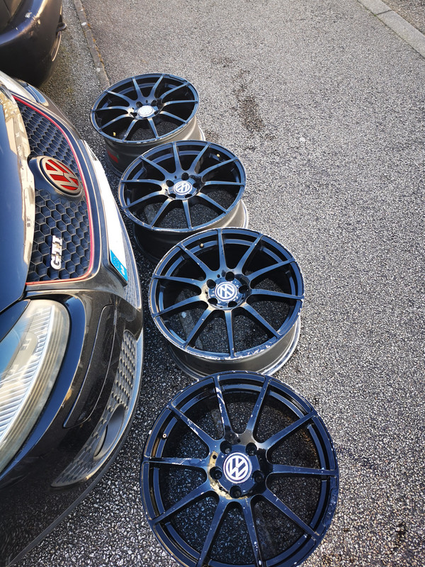

1- New front brakes and pads to correct some awful brake judder - £90 labour, £130ish for parts
2- a front wheel alignment - rear is too rusty to adjust - £40
3- a pair of part worn tyres for the front - £75 supplied and fitted

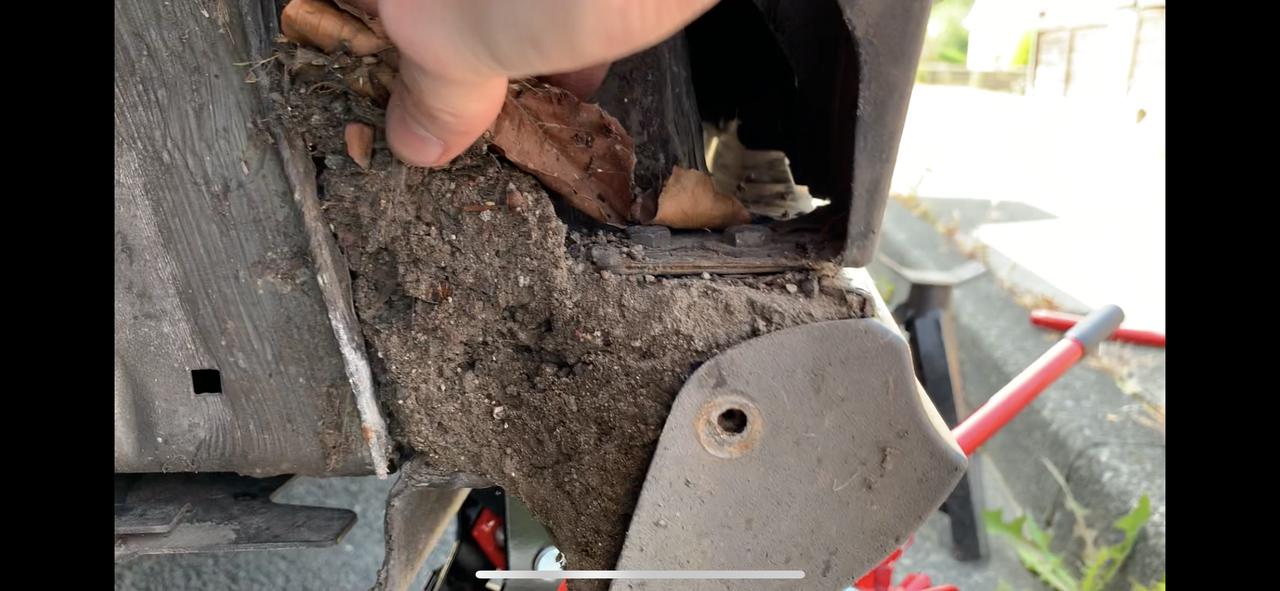

I wanted to make this as a separate post cause I think it’s important.

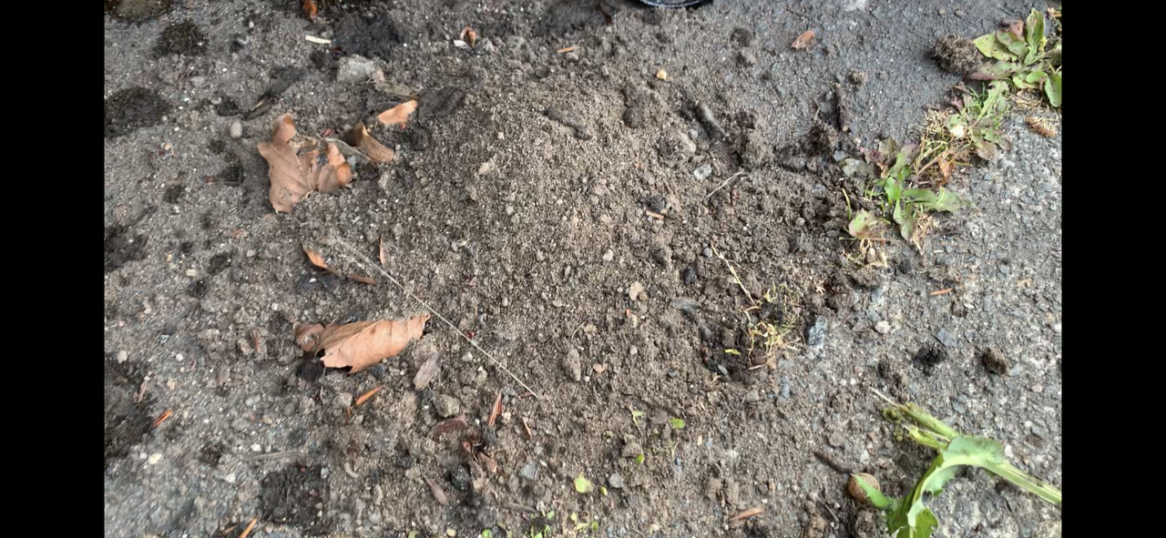

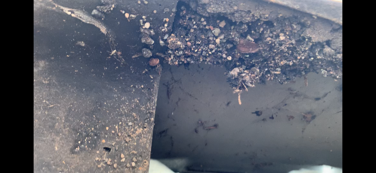

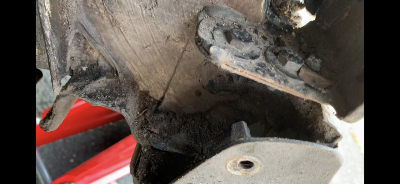

The rusty front wing problem on the mk5 is very well documented and almost everyone will encounter it. I fully advise if you haven’t already, pulling back the fender liner and giving the whole wheel arch a real good clean. I used meguiars multi purpose cleaner, a rag and a brush.
I was shocked how much crap was stuck in my car and thoroughly advise everyone to give these spots a check!
Very fortunately, the chasis rail end, bottom of door bit, whatever it’s called, was completely intact with no rust. I probably made a nice weight saving on each side too  :grin:
I sacrificed one of my Amazon detailing brushes to get all of the muck out which really helped.

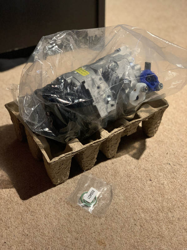

Brand new Nissens AC compressor, one step closer to having that functioning again, the condenser hasn’t turned up yet though…
I got both parts on Black Friday for a good deal, £250 for both, shipped! Will have to wait for a nice dry day to do this but summer is still a while away, no rush.

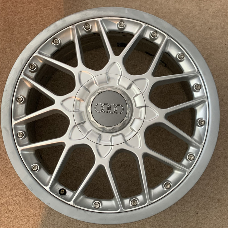

I retrieved a quote today from a local reputable wheel reburbishment company that does off PROPER split rim wheel refurbishment. I was quoted £470 for all 4 wheels refurbished, that’s pretty reasonable for a split rim. However, this doesn’t include the cost of me supplying new bolts, and it also assumes that the whole process goes buttery smooth.
I was explained to that a multitude of problems can occur when restoring these kinds of wheels. The bolts that secure the face onto the drum can shear which requires careful extraction. The threads on the barrel that the bolts screw into can be damaged during the process which requires re tapping (Even though I’m far from a newbie at tapping, I was informed this escalates the financial contribution substantially). Previous c*ck ups from owners, bodged repairs and “glued down” sheared bolts are opportunities for extra cost.
The cost of a new set (60) of bolts is £210 from PW Motorsport. Adding up the initial cost, refurbishment cost, and the hardware we come to a total of £1130.
In preparation I have found an set of 1 piece 7 spoke Ronal wheels from an Audi A8 for £200. These can be refurbed and balanced for a total of £245 including centre caps. £445 vs £1130 to get a set of 18” wheels looking presentable, sounds like a no brainer right? The contrary argument I have in my head is that the split rim wheel just look so cool! Im very tempted to just go all in at this point.
So what I’m going to do is take the wheels for an inspection and be told what they reckon the condition of the wheel is like and how they expect the process to go. Unfortunately it’s really one of those “suck it and see” situations where you don’t really know how bad it is until they’ve been split.
Im also not forgetting that the larger wheels will need skinnier tyres. £350 is about the going rate for Goodyear asymmetric 5. And if I did have the split rim ones refurbished, ideally I’d like to eventually get the BBS 80mm centre emblem to suit.
This brings the minimum total to around £1680…
…to get a set of split rim wheels fitted to my liking, on a 15 year old car worth £5-6k, in a ‘perfect world’ scenario where nothing ever went wrong.
It’s starting to sound a little silly isn’t it.  :doh:
I’ll update this with what I decide on, I think it’s pretty clear which way is the right way to go here… don’t get me wrong I love the Ronals I’ve bought but the rs 795 just seem effortlessly special.

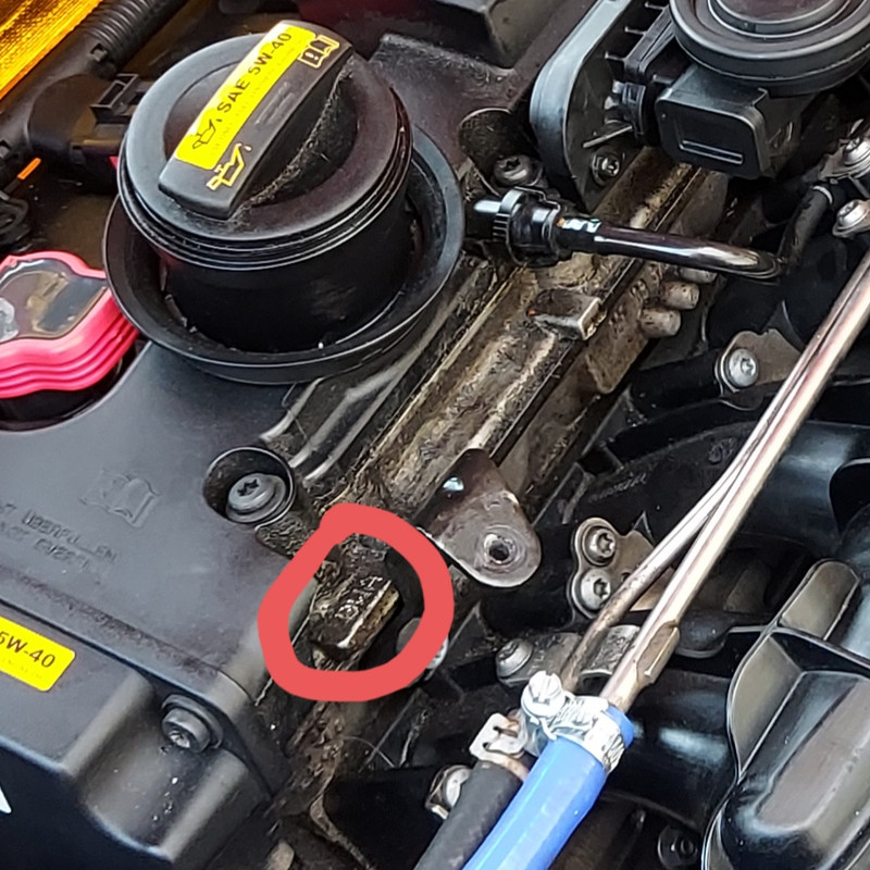

Been a while since I last updated on here. As of yesterday the bbs wheels have found a new owner, this comes as I have now sourced myself a bmw e46 330i! Have that car stored for now and haven’t driven it much but I’m dying to get it up and running properly for the summer, freeing up some funds for that. It’s a polar opposite experience to the gti in all imagineable ways. I’ll perhaps leave a review of both behind one day. Despite these cars sharing nothing in common other than being German and nippy, these cars were often compared and contrasted even today!
I’ve performed my first oil change on the golf and it went fine, I would strongly reccomend that you disconnect the coil packs and cycle the starter motor for about 10-20s to cycle some oil through the engine. As the oil filter is accessed upside down, and has its own reusable housing, filling up the filter with oil before installing is not an option. I briefly ran my car on low/ or no oil pressure for no more than 3s! And immediately stopped when I heard rough sounding start. I rememeber reading some time ago that after 8-10 secs of running without oil is enough to have depleted the piston rings of oil and start to damage your cylinder walls. Take that general rule advice with a pinch of salt as I can’t remember the source!
Today I tried to swap in a new compressor and condenser I had bought back on Black Friday. I didn’t get as far as I thought I would, but I will be trying this again soon, hopefully with a decent explanatory video on my channel ‘CalTarMac’.
Please note: you should not disassemble your own air conditioning system as recommended by vw and haynes. Haynes do not provide any instructions for this so it is entirely at your own risk. The air conditioning guy I went to reported to me that my system had fully depleted of any pressure. Therefore by disassembling myself I’m doing no more harm than already to the environment. It is a criminal offence to knowingly discharge refrigerant fluids into the atmosphere.
« Last Edit: March 28, 2022, 01:36:34 am by CalMac »
