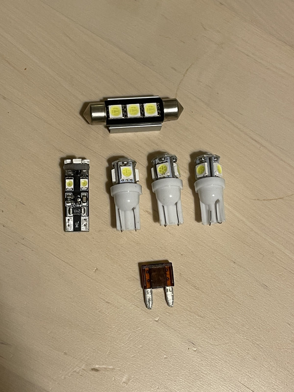

Pulled most of the el cheapo grande LEDs out. Look at these bad boys, they scream quality:
Now I have 50/50 white LED and ugly yellow stock lights both inside the car as well as on the number plate (which really is a sight to behold).
It did also seem to fix the always-on LED issue on the front reading lights, probably a more stable current in the circuit when distributed through working bulbs.
New bulbs are on their way... Thanks for the pointers so far!

I got these ones. Still cheap but seems to work significantly better. Flickering disappeared when all bulbs were fully functioning, so I suspect there's some circuitry that likes a steady flow throughout.
Link's fricked it seems. Here ya go: https://www.aliexpress.com/item/1005003021879653.html
