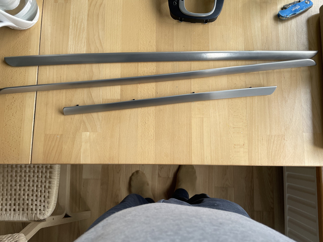

Spent a couple more hours on the car today,
Finished wrapping the silver trim:
And start refitting everything to the car:

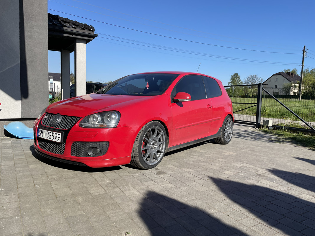

And finally dragged the car out of the garage to get a look at the front lip in the daylight.
As you can see now the color match sucks, im liking the look but it will need repainting and color matching properly at some point.

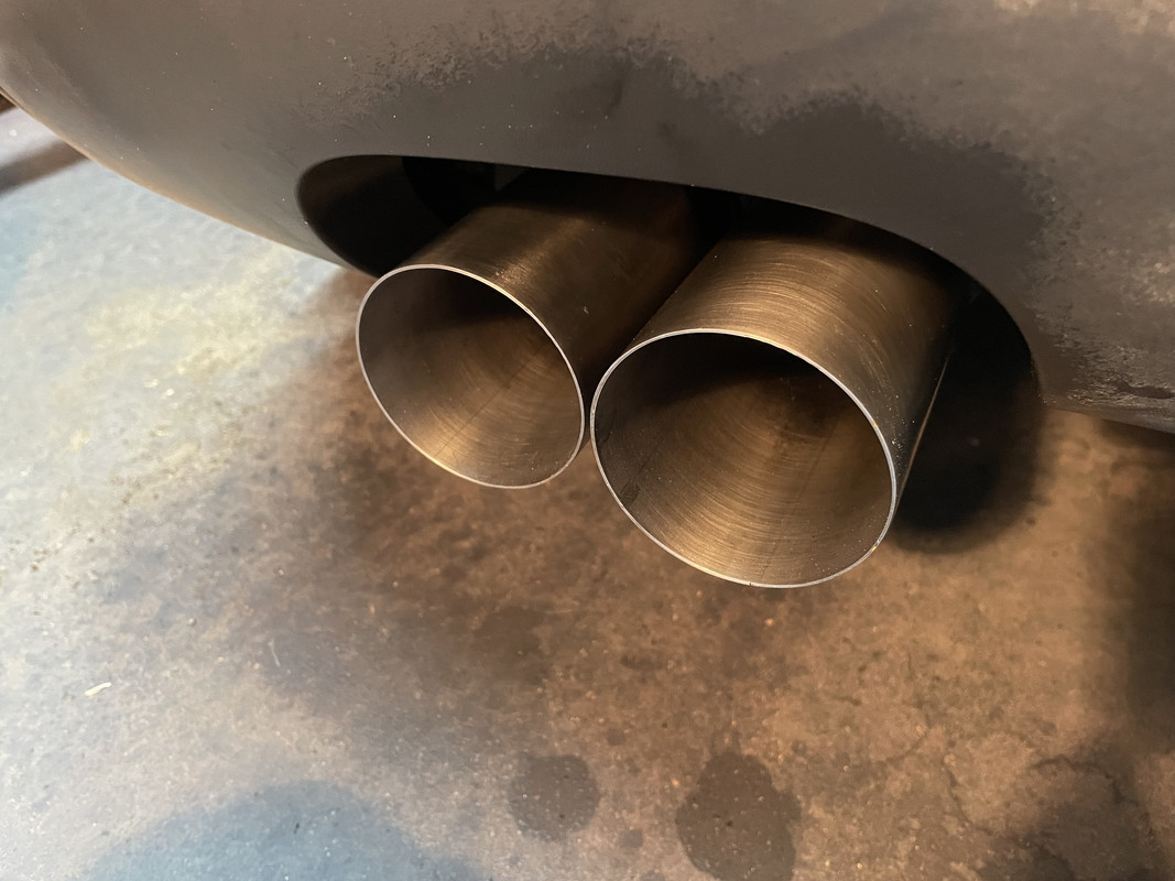

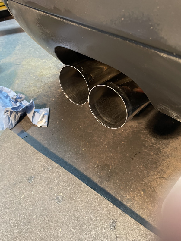

Today i gave the car a quick rinse off at the jetwash, and noticed that there was some rust on the exhaust tips, so i spent a couple of hours this evening with my fingers deep up a backbox…
Stupidly i didnt get a before picture so youll have to take my word for it when i say it was rough.
This was after washing and scrubbing with a course scrubbing pad.
And i attempted to finish it there with some polish on a fine pad but realised i hadnt got a lot of the corrosion.
So out came the sand paper, starting at 320 grit.
And working my way through 600, 1k, 2k, and some polish.
They still dont look great, theres some corrosion that even the 320 wouldnt get out, so ill keep an eye on it but for now its better, if not perfect.

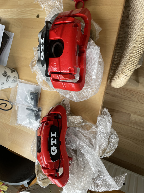

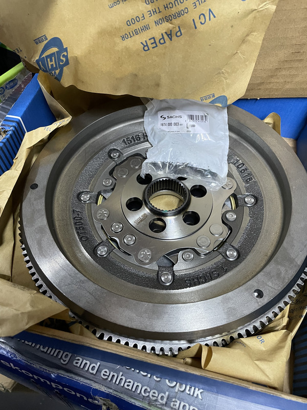

New dmf.
Ive also picked up a set of s3 340mm brake calipers, which are on the way.

Postman just dropped these off.

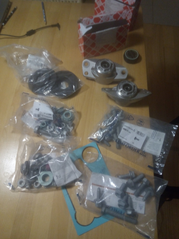

« Reply #37 on: April 14, 2023, 07:13:15 pm »
All new hardware, top mounts etc for the suspension just turned up in the mail.
Getting close now!

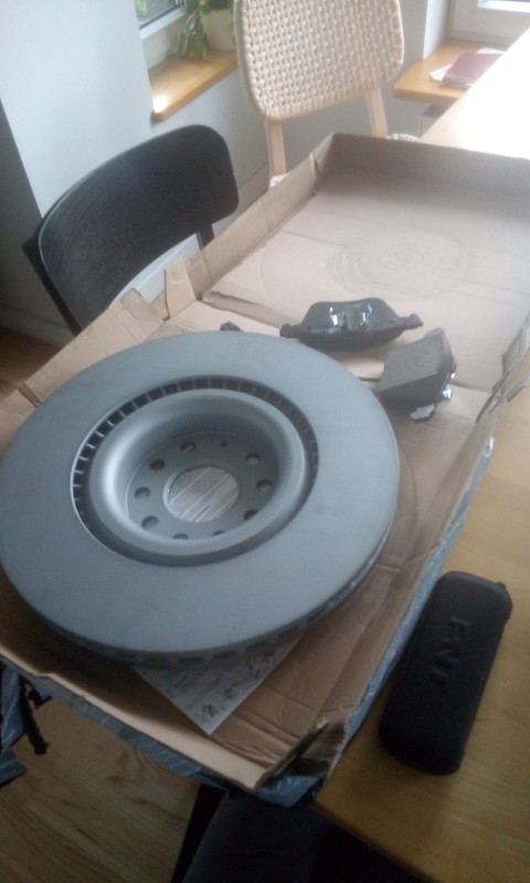

Brake discs and pads arrived today,
Nothing special, just zimmerman oem replacements, but will do to get everything fitted and tested.

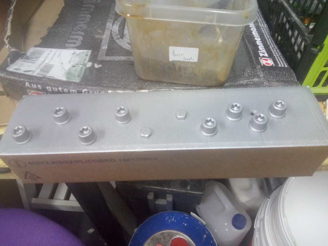

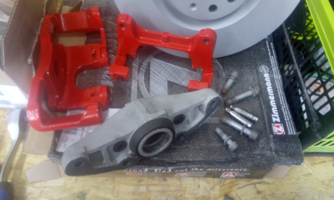

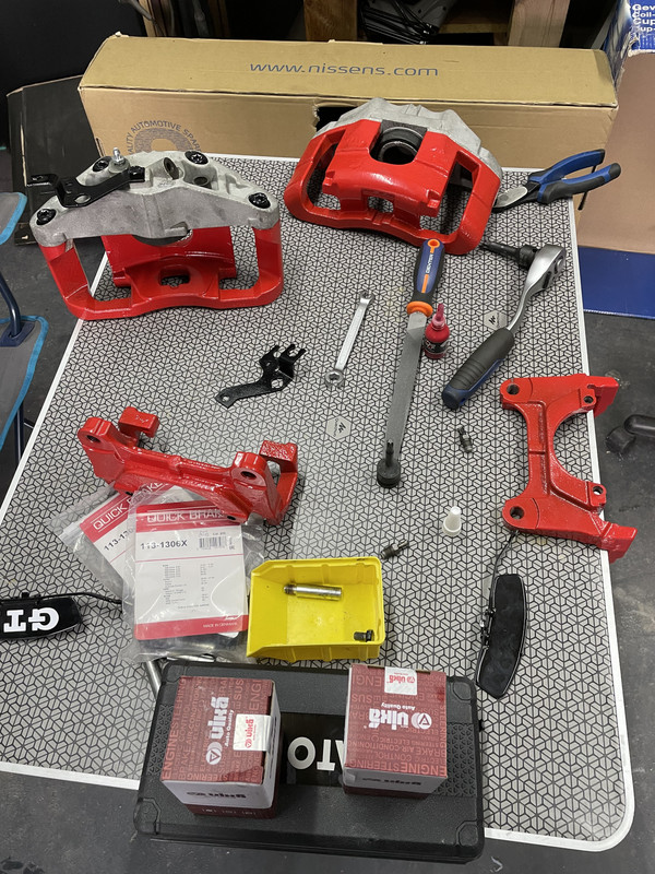

Recently I realised that the brakes I bought had rust on the bolts.
Nothing terrible, but I figured there was no point in leaving it to spread under the nice new powder coat.
So tore them down and gave the bolts a soak overnight in rust converter.
Then scrubbed them down to remove any loose surface rust before putting them back in the rust converter for a fer more hours.
Lastly I cleaned them off with white spirit before giving the heads a coat of zinc primer.
I had previously don't the same to the brackets for the back of the calipers.
Next up is to repeat the process with the threads in the calipers themselves, to make sure there's no rust sitting.

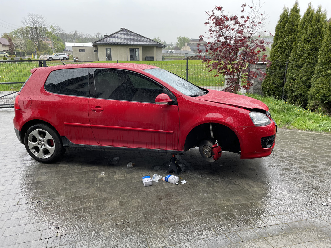

« Reply #41 on: May 06, 2023, 05:57:51 pm »

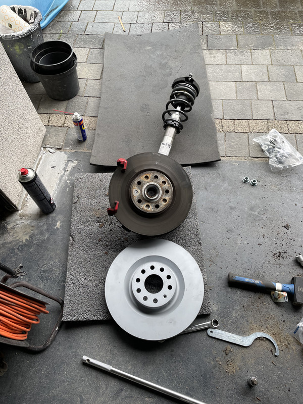

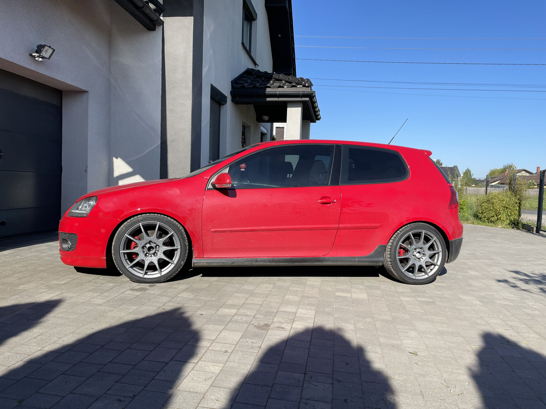

So progress so far is that the suspension is in and is awesome!
Decided to work on the driveway because theres really not enough space in the garage.
And of course the moment we got the car up and the front dissasembled it started pissing down.
In addition to the rain the tie rod ends had seized on both sides so we had to find a new pair.
But got the new struts fitted whilst we sat out the worst of the rain in the garage.
And got the brake calipers back together with the newly cleaned and painted hardware.
And at the end of the day the car is sitting pretty.
I still need to adjust the height a bit and bring it up half a centimeter or so on the front, and maybe go down a bit on the rear, but all in all im super happy.
The suspension rides almost like oem, a little firmer but not bouncy or crashy, no noises coming from the suspension.
I also tried to get the tyres fitted to the alloys but everywhere was full so thats going to have to wait till monday.
Next to do are the brakes which we dodnt have time for, and an alignment.

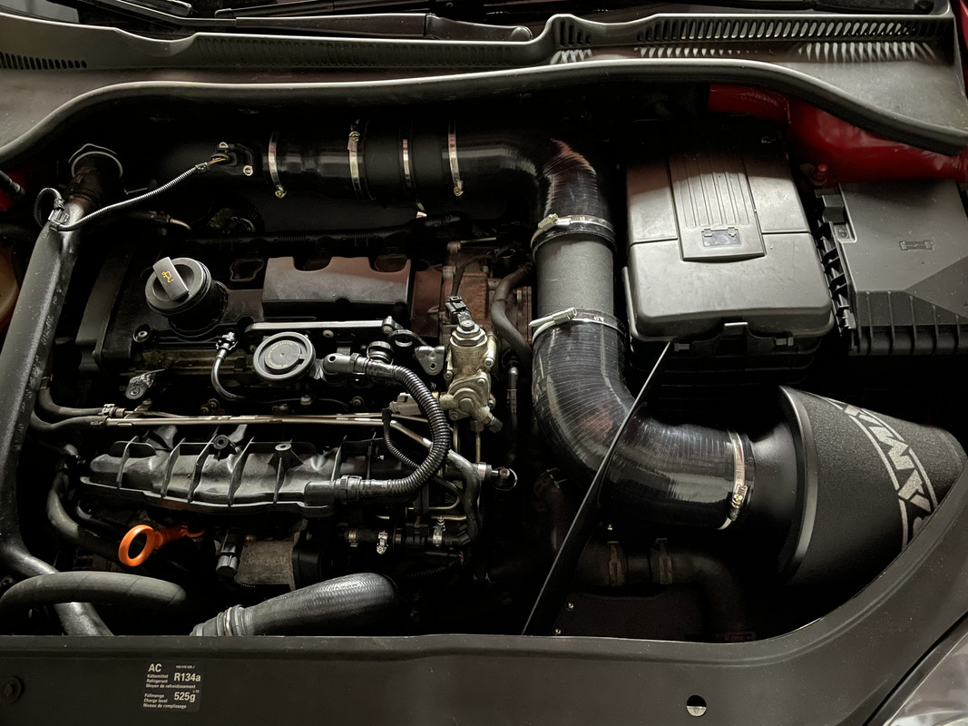

Then today i had the good idea to remove the noise pipe from the car as i dont see the point in it, and its just taking up space in the engine bay.
In preperation for this i did some research and found that other tfsi vag cars dont have the noise pipe, so i ordered an intake pipe from an audi a3.
Here is the twonintake pipes next to one another, as you can see the audibone doesnt have the extra exit towards the top, unfortunately you can probably se that the rest of the pipes arent an exact match either, the brackets dont line up and the angle of the top is a few degrees off.
But not to be put of i removed the brackets from the new pipe and after some messing about, and replacing the pipe from thenintercooler with another one i had bought from an audi just in case. I ended up with something that should work.
Engine bay before:
Engine bay after
And what was removed or replaced:
The failiure here was that when i dug about behind the firewall to remove the rest of the noise maker it looks like someone had already been in there and blocked te pipe off with a nylon bung  :congrats: so all my hard work was for little difference outside of cleaning up the engine bay and a couple hundred grams of weight reduction lol.
Anyway, its good to make progress even i its two steps forward one step back.
