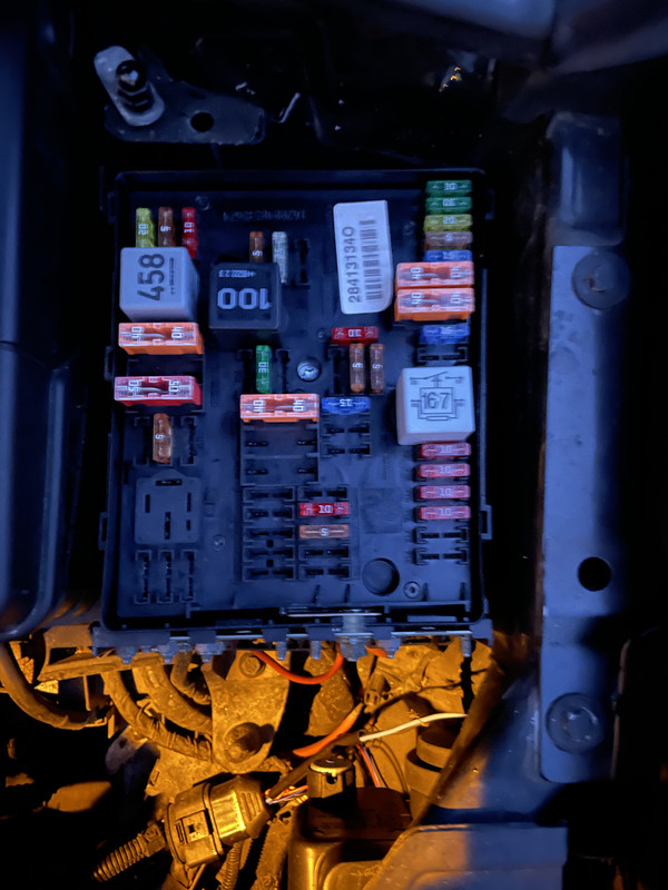

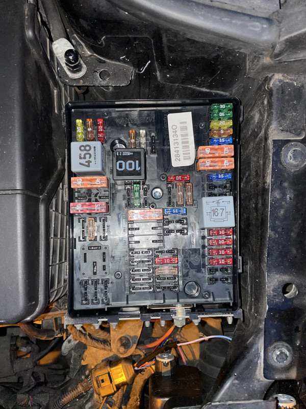

Can anybody confirm the location of the cooling fans fuse? I’ve not got the diagram for the car and various sources reference  different fuses.

They're the big chunky bolted down ones at the front of the fuse box.
