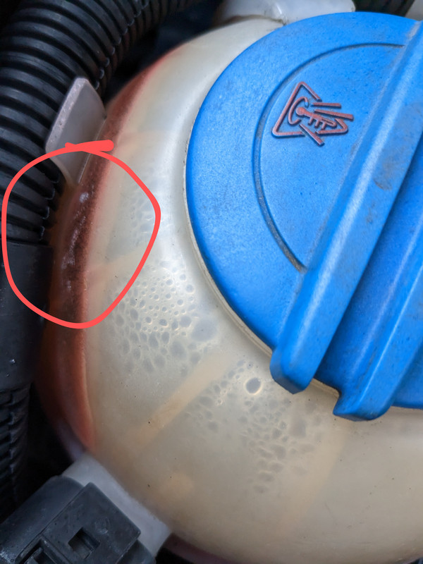

Hey guys,
just noticed a tiny crack near the top of my coolant expansion tank, that has made the coolant level rise, I assume due to a loss in coolant pressure? On a hot engine coolant is fizzling out at the crack.
Last time I checked the coolant level it was barely above minimum, due to a very slow leak somewhere, so it's a suprise to now see it above max now on a cold engine. Engine's not overheating or anything.
Is it safe to keep driving for now? I've got a road trip from Dublin to Belfast so I need to know if it's something to get sorted ASAP or not.
Thanks  :smiley:
'06 Skoda Octavia vRS TFSI

You will more than likely get a "STOP" warning light when the coolant gets lower.  Id be tempted to seal it with hot melt or glue for a temp fix  then replace when possible.

I'd try a temporary fix with epoxy or hard plastic padding.  Siphon out some of the coolant so that its below level of crack then carefully clean and dry before applying the epoxy.   Best to replace as soon as possible as its under pressure.

Something important like this for the engine…. personally I’d just change the tank. Either get a 2nd hand one or new. I wouldn’t be using glue or something to repair it when it’s under pressure.

A new tank is about a tenner from ECP and takes about 10 minutes to fit, be quicker to do that than try and bodge it.

Ok thanks for your replies guys - will try and get a new FEBI one today as that's what's available locally. Will let you know how the install goes.
Not doing a temporary fix as this may just lead to a dramatic explosion at motorway speed which I'm not exactly a fan of  :grin:

Alright expansion tank replaced now, got a new OEM one from my local VW dealer for €37 as that was the closest one available to where I live.
Old
New
Surprisingly one of the easiest and quickest repair jobs I've ever done on the car, took about 15 minutes. I even had a pick ready to remove stuck hoses but they only needed a few jabs before sliding right off.  :smiley:
Absolutely no reason to even consider a temporary fix if you're able to source the parts locally, it's such an easy job.
