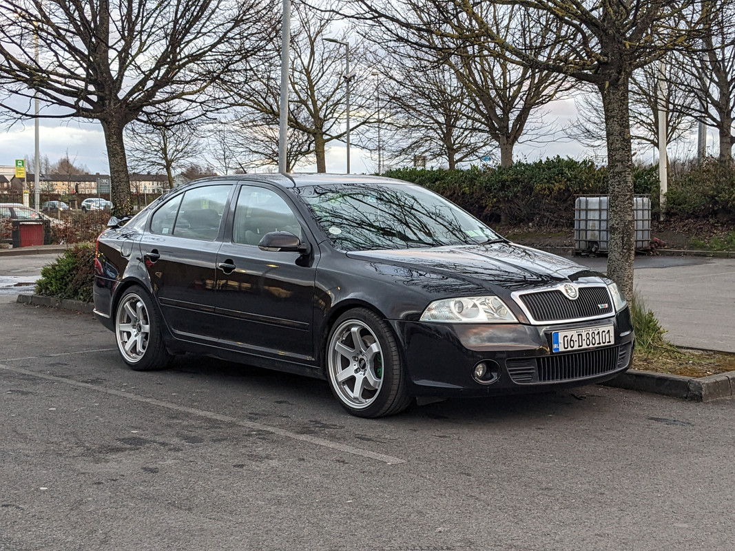

EDIT 23/05/2023: The low oil pressure light I got in this post was likely just from hard cornering with a below average oil level while on track. By pure coincidence I later discover there is actually something mechanical causing insufficient oil pressure, but only at idle RPMs.
^new suspension setup, H&R 45-50mm Ultra Lows on OEM shocks, wheels are 18" Bola B1s
Planning on doing my first track day ever in the Octy.
It's only a half day on the track so two and a half hours, and I'm not planning on pushing her too hard as I've no experience of driving on a track other than go karting.
I'll change the oil before hand, is it necessary to change it after too? The Millers CFS 5W40 NT+ is €81 for 5L so don't want to throw that money down the drain  :sick:
Current setup, appreciate any and all feedback on this  :smiley::
Brakes are all pretty much factory and had all pads and discs replaced 10k kilometers ago. They're still squeaky as a barstewards though, and of the rear calipers leave more brake dust that the other 3, but isn't seized or anything like that. Also brake fluid was inspected by the garage then and deemed to be fine.
Suspension is now on lowering springs and OEM shocks with new top mounts, and all the bushings are in decent condition. I'll get an alignment before the track day too.
Tyres are Eagle F1 Asym 6s, and only have a few thousand kms on them.
Engine's got a RamAir standard size CAI and is running a 95RON-tuned remap, and oil pump still has an active balance shaft. Rev G DV.
As for octane booster, on UK track days you guys are obviously running 99, but are you running any octane booster on top of that?
Cheers!
