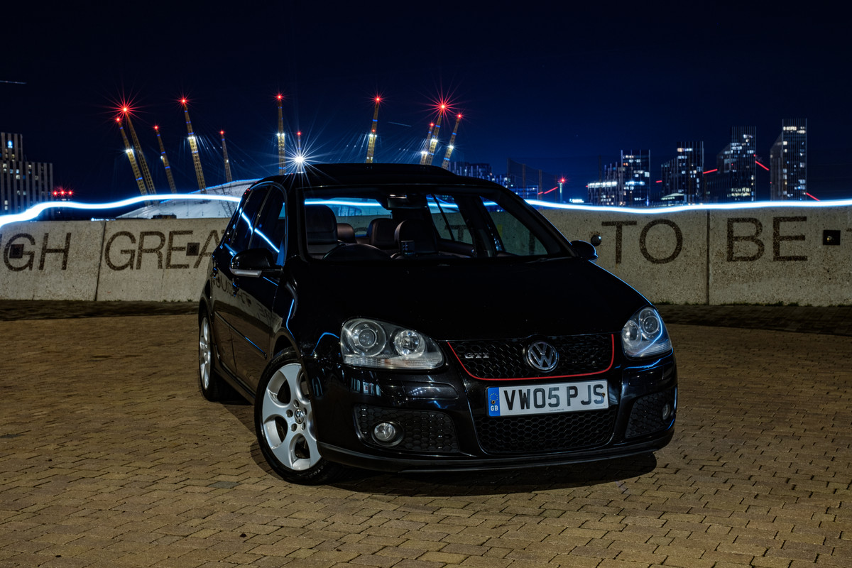

Hello there. I am new to this forum and this is my first post. Attached is a picture of my car. I'd like to ask if anyone's had the same issue as me and could help me. Last night as I was leaving work I noticed all of a sudden my key fob wasn't unlocking the car. I don't think the key fob needs new batteries as you can see the red light turning on and off as you click the lock/unlock buttons. I've had to manually get into my car. However after manually unlocking the car I noticed none of the other doors unlocked and I've had to unlock them all from inside. Before this happened I did have an issue with the passenger side door not locking and had to manually lock it each time. This started happening about 2 weeks ago and I didn't think much of it. Once I got inside my car I put the sunroof on the tilt position and noticed that also wasn't responding to any inputs. There's no warning lights on the dash or anything. I've also checked the fuses of both central locking and sunroof and they're still good too. Not sure what could be causing this. Anyone had a similar issue and found a solution?
