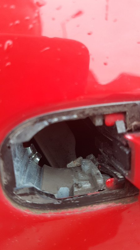

I then drilled a hole through the internal skin on the door and then through the plastic casing of the module. I then sprayed wd40 into the housing and continued to lock and unlock the car to try and work it through. After about 5 mins it didn’t double click, pulled the handle and at last! It was open! Saved having to cut the exterior door panel off the get the door open.
I’ll attach some photos of the hole location.

I’m going to have to do this on my rear near side passenger door. It’s temperamental at best! Thanks for the pics

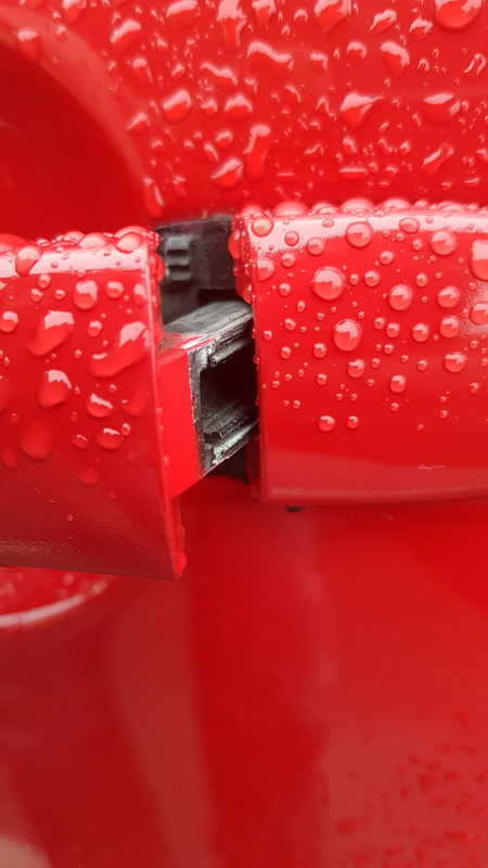

I later found out that if the door won't open from the outside and Inside it's because one of the cables that connects to the mechanism is pulled slightly so you have to pull the door handle, unclip the little black tab as pictured and then open it from the Inside. Then once the doors open you can take off the door skin to replace it.

Believe me mate, I had tried all of that before this 😂 My issue wasn’t the cable it was the motor not fully operating. My fix is literally a last resort without having to cut the exterior panel 👍🏻
