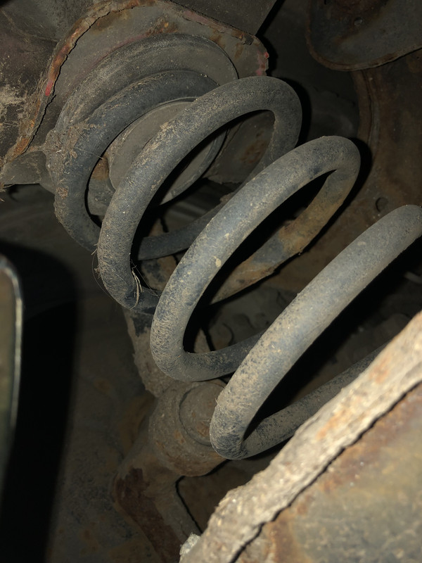

Thanks both of you for the fast replies. Rear disc back plates look very rusty but seemed to be solid and no movement. Springs also look very rusty to the point where I could pick off bits (of old paint possibly), although I couldn’t see any obvious cracks. Here’s pics of the springs. I’m gonna try the springs first, then change back plates when I next get rear brakes changed. Thanks!

They normally snap at the bottom, if you remove a rear wheel you can see the bottom of the springs better

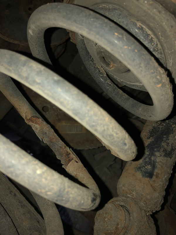

Here’s 2 pics of the bottom. Definitely rusty looking but tbh I can’t see a break. I checked brake disc back plates again and they are slightly wonky so that there is a 4-5mm gap between it and the brake disc at the top and they are touching at the bottom. If I flick the back plate with my finger it’s a very similar kind of noise to what I’m getting. I wonder if when I corner harder, it’s just enough to rub the brake disc against the back plate?

In the last year both of the shields on my rear brakes rusted out.
On one side all of the fixings rusted through so as I drove the shield was completely loose and making a very loud sound.
The other side was only partially loose so it made less of a noise, louder with the windows down.
