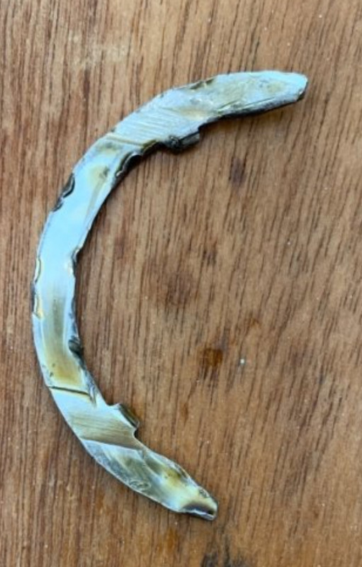

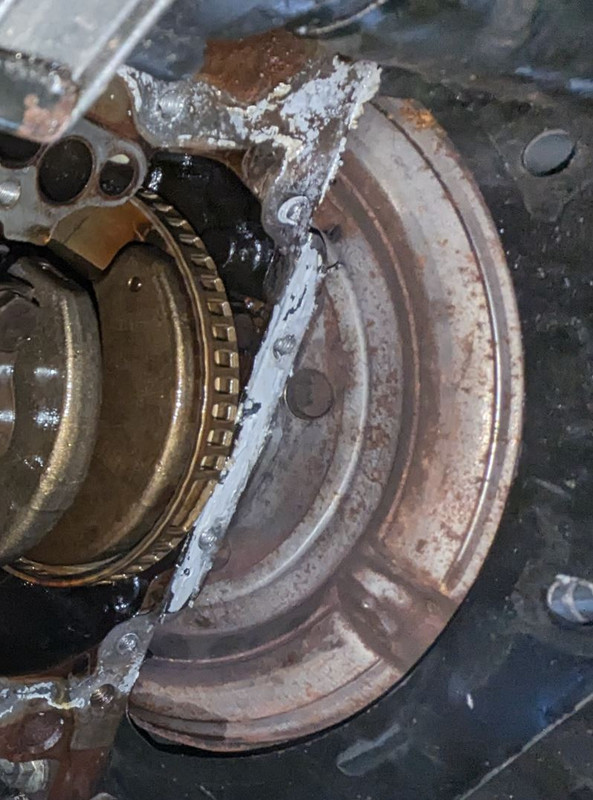

A guy on our local car forum had this issue on his and it turned out to be crankwalk. The thrust washers were destroyed. He had an uprated clutch though.
Not his thrust washers but they were somewhat like that.
It is his flywheel though you can see were it has been rubbing on the block.
« Last Edit: October 10, 2023, 05:01:53 pm by SpongeBob »
Yikes that's a scary thought. I replaced the connecting rod bearings in-situ as a precaution two years ago after my oil pressure mishaps, but I remember I wasn't able to access the thrust bearings (without taking out the crankshaft, something I wasn't prepared to do). But I would have checked them if I could.
As for the flywheel, I assume that picture you sent @SpongeBob is the view with the sump taken off. Here's mine:
These pictures are from this May, or about a year after the issue first appeared. No visible scratches.
