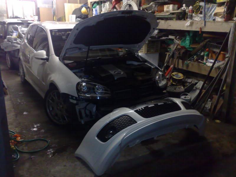

« Reply #8 on: April 12, 2010, 12:46:56 am »

^^^ Well done Vick, I'd love a garage that size.....needs a good sort out though  :signLOL:
Mate tell me about it  :grin:
I seem to clean it, then over  a few weeks seem to add more crap in it!  :sad1:  :grin: :grin:
