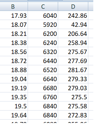

Here's one clip of mass air data from a log. You see mine peaked a few hundred rpm before the near 6900 redline (a bit higher due to its DSG tune). I can't remember when the HP peaked at on my old dyno runs, the graphs are packed and have no pics, but those show only wheel HP; for being done here in the states. The dyno peak HP occurred, iirc between 5600 and 6100, a good bit before the 6500 rpm mass air peak shown in the data log. So I could only guess what the BHP would be. But yeah...others have said "at least 340 BHP."

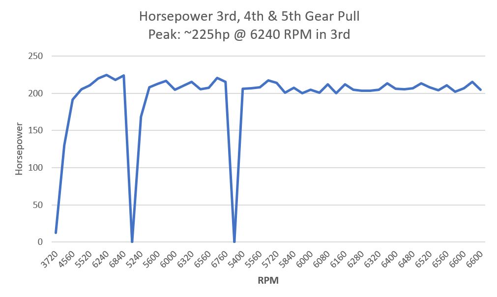

MAF points to max power at nearly 7000RPM, Torque spec points to max power at ~6200RPM.
Also the '238hp' I posted earlier definitely comes up under 'rubbish metric'. I dynod at 232hp on a proper dyno, running enough octane booster to make my 95 octane equivalent to 99. But you're right, less than 5% off.

EDIT: Forgot to include, finally learnt how to use Excel, here's a couple neat graphs from logging on just 95:

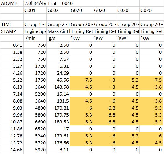

Yeah I was just looking at the timing pull and anything over 6 isn't great to be honest, but not critical. Even standard ones usually pull -4 to -5, they run pretty close to detonation from the factory.  -7.5 certainly isn't disastrous, so don't worry about that too much. If you see figures of -10+, you need better fuel or a remap of those load areas.
From memory, those aren't the actual degrees of ignition retard. It's a weird Bosch way of doing things. It retards in steps of 0.75 degrees, so it would 7.5 x 0.75 = 5.6 actual degrees of retard, which at 1700rpm isn't anything to lose hair over.
The stock TFSI timing map is pretty gnarly. At some load points there is 0 degrees advance, sometimes minus degrees. They're just all over the place, but it all works hand in hand with the VVT and other parameters, but anyway, I've not seen anything in any of your charts that rings alarm bells  :happy2:  You have very low timing pull from 3600 upwards, which is the danger zone.  At those rpms, excessive detonation is game over as you don't have time to back off, and you can't hear it happening.  I think the ECU's retard limit is -25KW (18 degrees), so you're well within the limit.
Obviously you want as close to zero pull as possible for power consistency and engine life span, but even with 99 RON in England I was seeing -6 on my ED30 with Stage 1.
Also bear in mind, a heat soaked intercooler will raise intake temps, which will also cause the timing pull.  45 degrees C intake temp is when the ECU starts pulling it.

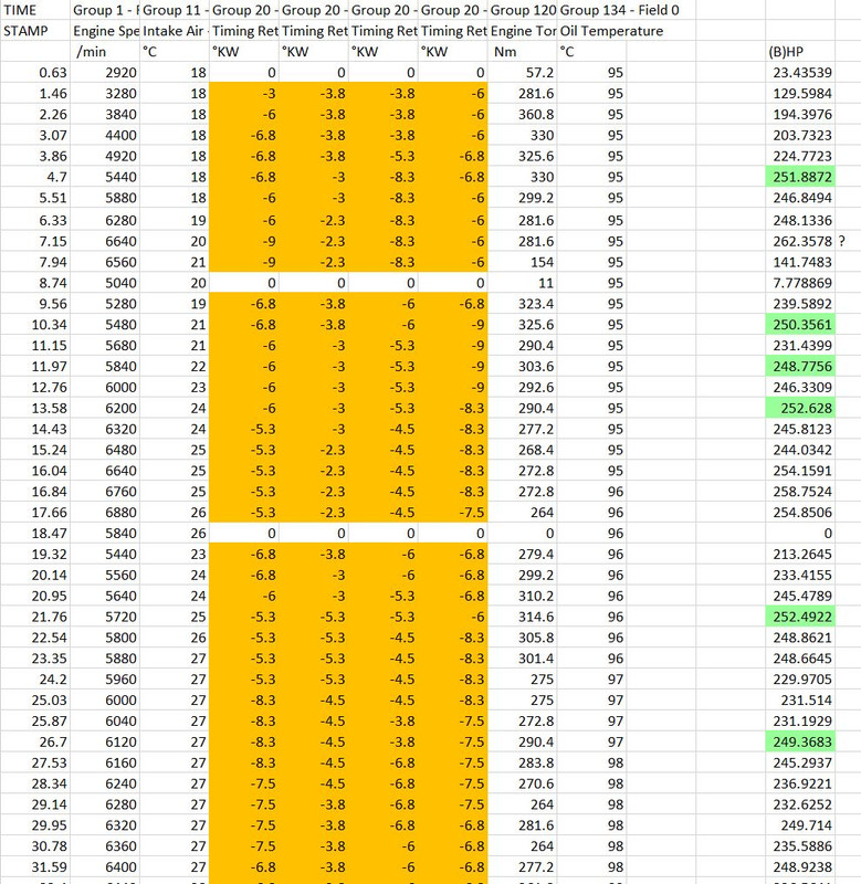

Finally, got mapped. Unfortunately no dyno as the dyno my tuner normally borrows was too busy, so just a road map for now. He says we'll get the map fine tuned when the dyno is free, but who knows when that is :grin:
Also, I've figured out that the HP conversion formula I was using was for BHP, not 'PS', or the version of HP I like. God damn you imperialists, making me think I have 3 less HP. So all numbers presented below (and previously) are all in imperial horsepower, not metric.  :doh:
Anyway. The numbers. There's some weird anomalies like high HP near redline so I've included timing pull again and intake air temp.
95 Octane
Horsepower ≈ 250BHP*
95 Octane + NF Sport Octane Booster
Horsepower ≈ 259BHP*
*To be taken with a grain of salt, as this is just VCDS logging and anomalies occur in the data. Only a dyno will reveal a more accurate number. I also just threw in the octane booster right before the second run without filling up, so may not have been mixed perfectly.
I'd like to know what you think of the timing pull, @Pudding . Tuner said he changed the timing slightly to squeeze out more power. She's hitting as much as -9KW timing pull on 95 in the peak power RPM range.
Cheers!

-9 is a tad high but not excessive. Personally I wouldn't want to see any more than -6, but the octane booster appears to reduce it  :happy2:
