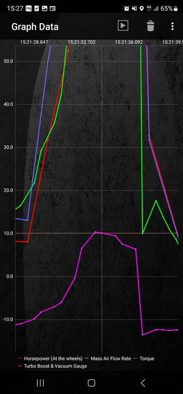

Hi folks , what psi should a mapped gti be at my readings are saying roughly 11 to 12 psi thought it would be more than this. Car feels quick and is side by side with my mates mk3 focus rs on a roll
Took these from torque app not sure how accurate it is

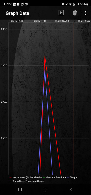

Just did a pull 3rd gear to redline strange that it's saying bhp is 280odd but boost is just over 10psi

Is there anyway to check the RPM when you hit that second Torque peak? Something seems off, you MAF intake peaks around 175g/s, to be anywhere near 280hp you'd need above 200g/s.

Sure the torque was at around 4k to 5k ill check tomorrow

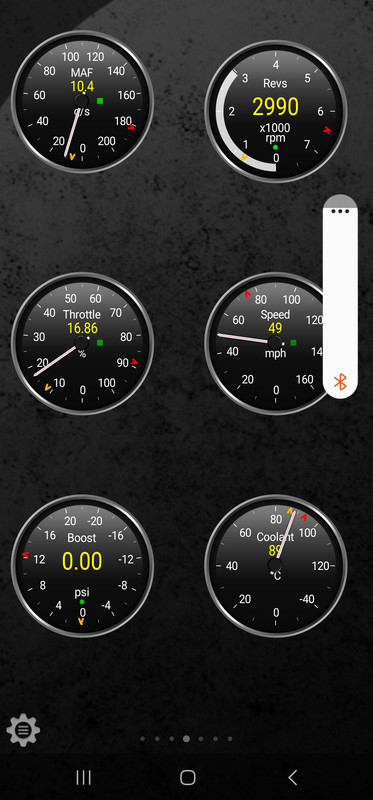

What is the timing advance this is it at idle
