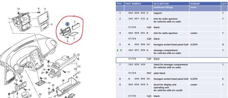

VW do an official double din to single din adaptor, fits both MKVs and MKVIs
1K0857058A 1QB  STOWAGE COMPARTMENT £22
1K0858169 9B9     INSERT FOR COMPARTMENT £4
N90698606            BOLT £0.12
