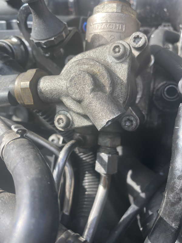

I was attempting to replace my cam follower, all was going well until I encountered a 2nd hard line on the left of the fuel line (I think it’s normally a soft/flex hose)
Anyone experience this - photo below.

There's 2 generations of HPFP lines used in the mk5. This one is the old gen. The newer gens use the rubber hose because it makes maintenance much easier but other than that, there's not much point in upgrading. One thing you can do tho is drill out the limiter in the end of this hard fuel line. This eases the stress on the LPFP, making it last longer and also helps with fuel demand if you're running an upgraded HPFP.
I drilled mine out to 4mm, plugged the part that goes to the fuel return valve and flushed the other side out with compressed air and brake cleaner so no metal fragments are left.
