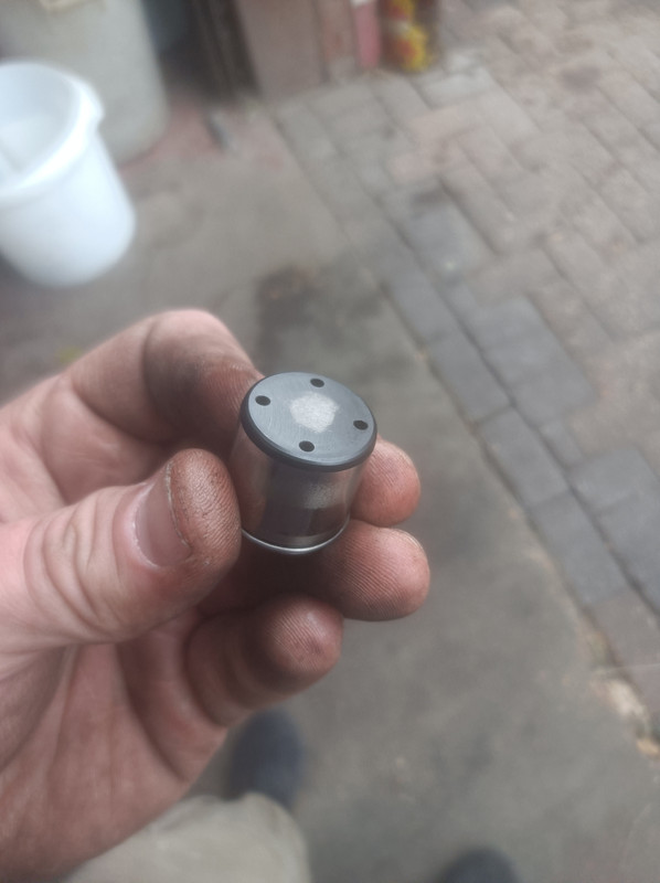

Today I've changed the fuel filter, and I took the HPFP off to inspect the cam follower (pic bellow) and the lobe of the camshaft and they are fine!!
I'm running out of ideas now on what this could be.

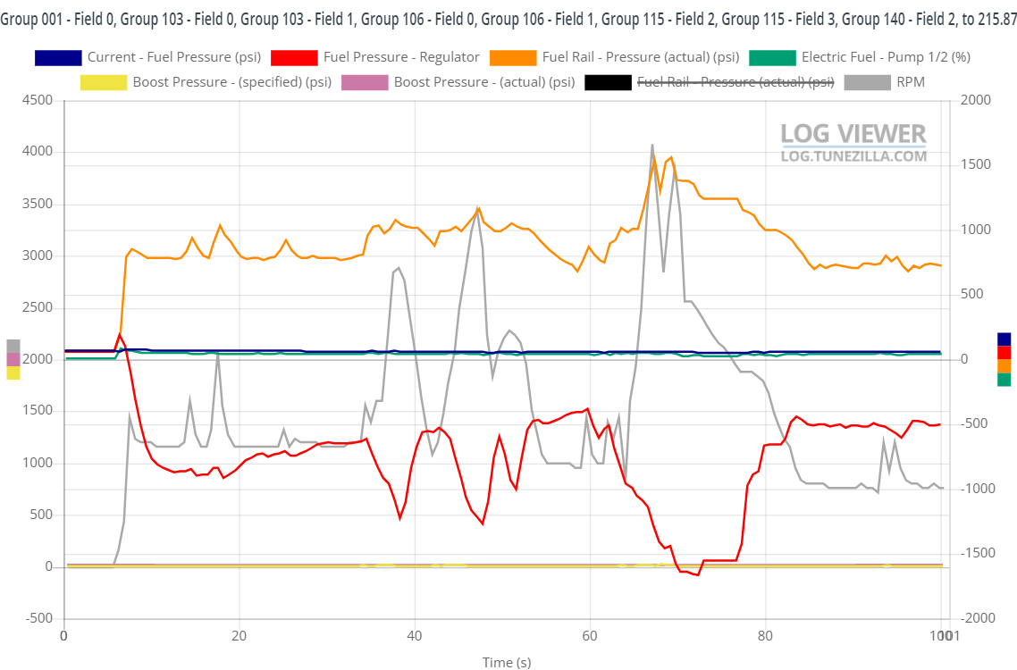

Ive make a log in vcds. If anyone could give me a bit of feedback from the graph on what the problem could be, id much apprechiate it. Any questions or doubts, let me know to clarify.

Anyone got any feedback on this or info on that graph I put up yesterday?

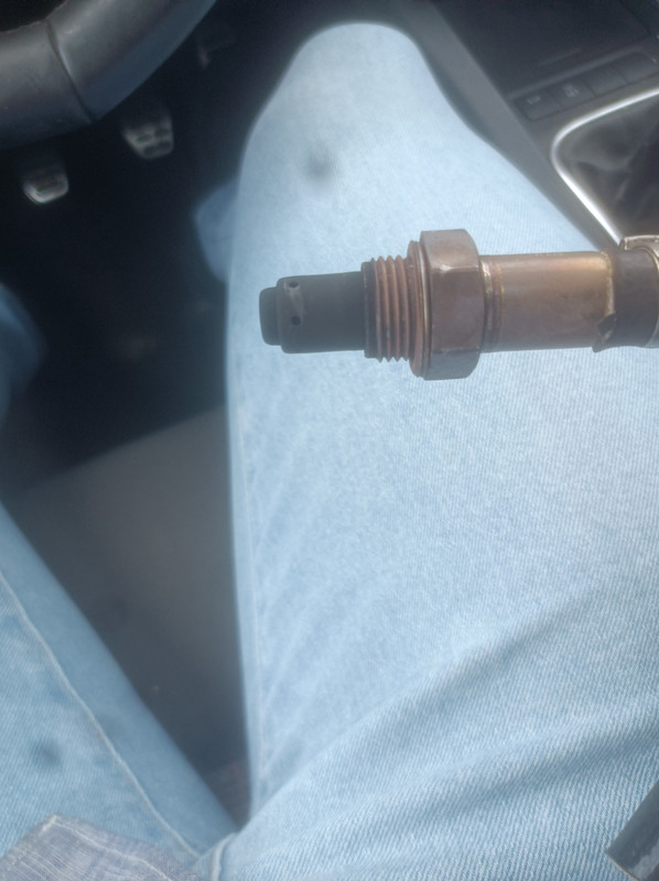

The knock sensor and misfire codes are because of lean fuelling.
You have 2 issues. Bad lambda sensor and insufficient fuel flow. B1 S1 is the Pre cat O2 sensor in the downpipe next to the turbo. It is the primary sensor, so is the important one.
The graph doesn't make any sense because the boost and rail pressure specifieds are flat lined.  Fuel pressure actual seems to follow rpm though, but fuel pressure and fuel flow are different things though.  For a remapped engine you need more flow, therefore you need HPFP internals at minimum. If that still doesn't solve the fuelling short fall, then fit a new LPFP.  They get tired with age and were revised by VW twice in the MK5's lifespan.

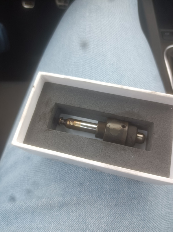

UPDATE for future references: Car is now sorted! I had the lambda (O2) sensor changed and I changed the hpfp piston to a vis one and now the car is back to its good old self. I also changed the cam follower for peace of mind.
I was getting low fuel pressure faults that where setting off other faults. I did however change the spark plugs and the coilpacks and they made no difference, but they're changed and new now so no complaints.
Below are the pics of the old parts I changed.
