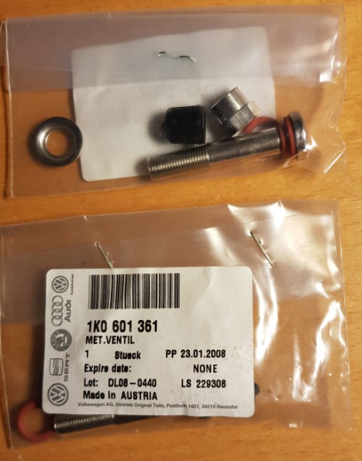

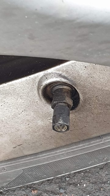

Just thought I'd put images up.

Checked the front two wheels and they are '1K0601025AC'.
Reading a couple posts down 'https://www.clubgti.com/forums/index.php?threads/unable-to-find-any-valves-to-fit-17-monzas.256039/'. I would need the part '1K0601361' rather than the B at the end. Im not fully sure at the moment due to reading the the monza I bbs would need the 1K0601361B.
I think futher down the road ill try find ronals (maybe for a winter setup) or the ed30 BBS but currently I cant budget it.
for 1K0601025AC you definately need the metal valves 1K0 601 361
and yes they are now obsolete, and no stock left in UK or germany ...
