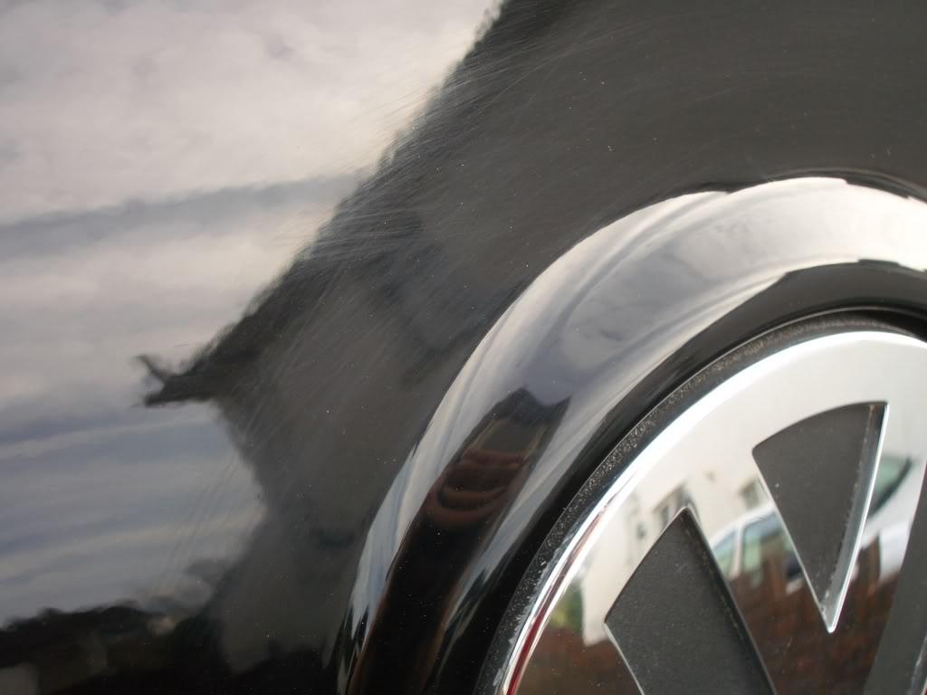

Yes the Auto Glym paint renovator seems a good bet, just wanted to share some experiences before I spashed out;
heres a pic of the offending area:

You have to work it in for ages and it might take a couple of tries but it does work well & won't leave any extra scratches / swirls of it's own. Failing that, you're gonna need to machine polish it, which I'd be more than happy to oblige if you are in the Wakefield area  :happy2:

Can you feel the scratches with your fingernail? If so, then there's no chance you'll get them out by hand polishing. If not, then you should be able to get rid of them with a bit of hard graft!

They look like they should polish out without too much drama. With regard ScratchX i think the AG Paint Renovator is the AG equivalent so if you have one then i dont think its worth going to get the other as its the same product by different companies.
As said above, aside from making sure the area is properly clean it will probably just require some elbow grease if you're not using a machine, just be careful as obviously using abrasives on the paintwork will be taking layers off and although tiny amounts, it all adds up and you dont want to end up with an even worse situation.

I think you will be better using a product that will fill rather than be abrasive. Purely for the fact that, you are just NOT going to touch the paintwork on a golf by hand.
Another reason, i see so many cars where the owner tried to get rid of things by hand and ended up putting more serious marks into the paintwork.
I can completely understand owners wanting to try themselves by hand, but it normally ends up worse.
So, Id recommend Auto Glym Super Resin Polish, then a wax.

Thing is using the "Safe Cut" product I did remove the deeper scratches but in doing so was left with more lighter scratches. THe scratch X has made things better, but not removed them completely, thing is do I persist with the scratch X stuff or similar???

Im wondering if you just masked it with a load of lighter scratches. I see how you get on with AG SRP, thats the best bet.
Ive seen some real messes with scratch X. Its for "spot" scratches, rather than big areas.

Mate JPC is right then again he is never wrong lol! the paint on the Golf is to hard to get paint correction by hand.
The only real solution would be to save up some cash and get your car corrected by a detailer im going to be getting my black GTi done in a few weeks by james in TI22 so youll be more than welcome to pop done after to see what kind of results are possible. Until then youll just have to fill the offending scratches with AG SRP etc to cover the scratches until you can get them removed.
