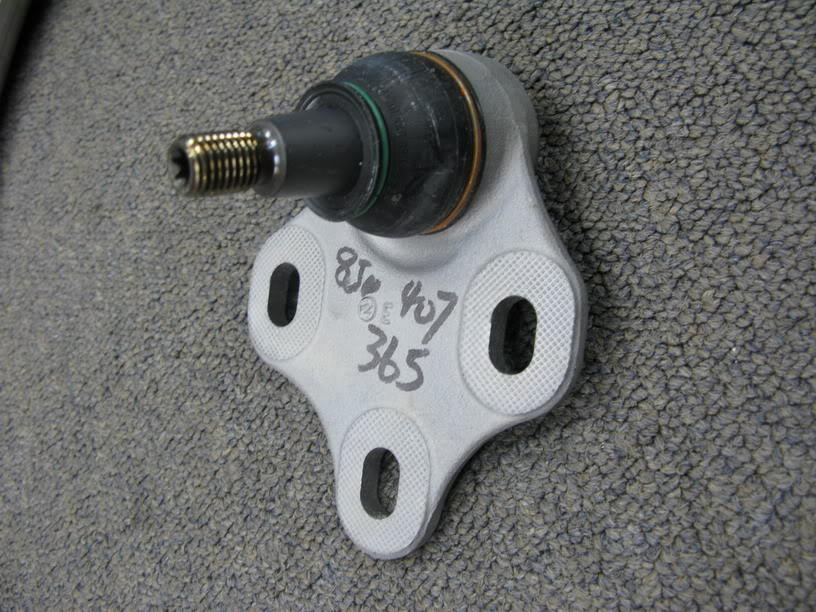

ok, so just to confirm we will be getting "slotted" ball joints mate?
if so can i order a set of ball joints/locking plates/and bolts for £100.80, how do i go about ordering them  :jumpmove:
I have qouted on the following part numbers
8J0 407 365 and 8J0 407 366.  The pic (taken from ASN) below depicts one side - 365.

Given Beddie's find, I think the ball-joint only method is not the way forward.

As Sy alludes to, the issue for the Cupra/S3 boys is the fact that the S3/Cupra lower arm is slightly different to the MK2 TT arm, therefore the 'cheap' option we thought may work (buying the ball joints only) is in fact not available to them without (IMO) unsafe modifications to the current alloy S3/Cupra lower arms.  So if the S3/Cupra boys want (Safe) adjustable camber, then the MK2 TT arms  and ball joints are also required.
The GTI however has steel lower arms, and to add camber to the GTI you need to fit the whole package (TT Lower arms and Ball Joints), and then you will benefit from much lighter wishbones and add some adjustable camber.
So for either the s3/Cupra/Gti to gain adjustable camber you will need the whole kit.
