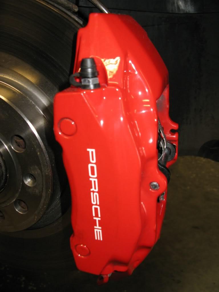

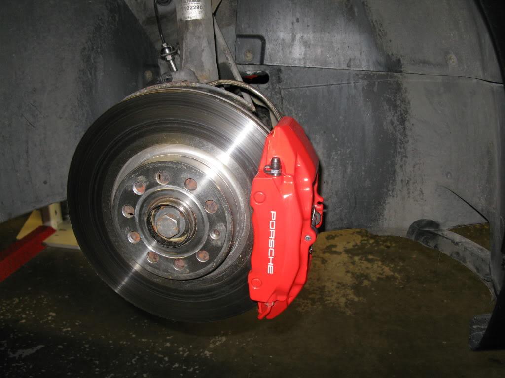

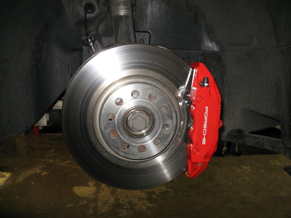

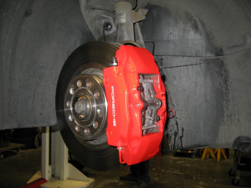

Ok so it all fits, brakes went on and lets just say seem to be working and Joes Happy
Dave at ADS took the chance to rebleed the brakes today and took these pics I'm having some major IT issues at the mo, the more I think about this the more I get revved up, the difficult bit of any brake conversion is the carriers and the geometry needs to be bang on with these as the cayman only uses a 24mm thick disc and the 312 is 25mm, but it all works.
We've gotten over the first hump and proven the pedal which is reported as very good, they seem to be bedding in nicely, next hump is the ring trip where hopefully they'll get a work out with some track pads, it'll also be a chance to try some different wheels over them, then Dave R's set'll will go on and we can get a comparison to the setups thats Dave has already experienced on the target car which is the ED30
Calipers & Hoses & Bolts £200
Two calipers with used pads/fitting kits and a sensor already in like this £280 delivered

Looks good ! are those porker calipers brand new or reconditioned ?
Dave are you getting my pms, didnt want to phone ya incase you were away again, Ta.
MK7 GTI - ARRIVING DECEMBER
Offline DaveB@Vagbremtechnic
  • Trader - 2014
  • -Receive: 130
  • Posts: 1315
    • Vagbremtechnic.com
Re: NQS BBK - A Not Quite So Big Brake Kit.....Read On
« Reply #41 on: May 03, 2010, 09:23:16 pm »
Got them mate, managed to request the prices by email before my lappy died.....
Will get you sorted this week bud promise - just got back from a tour.
Calipers are refurbed - standard boxster calipers are like an annodised black/blue finish
