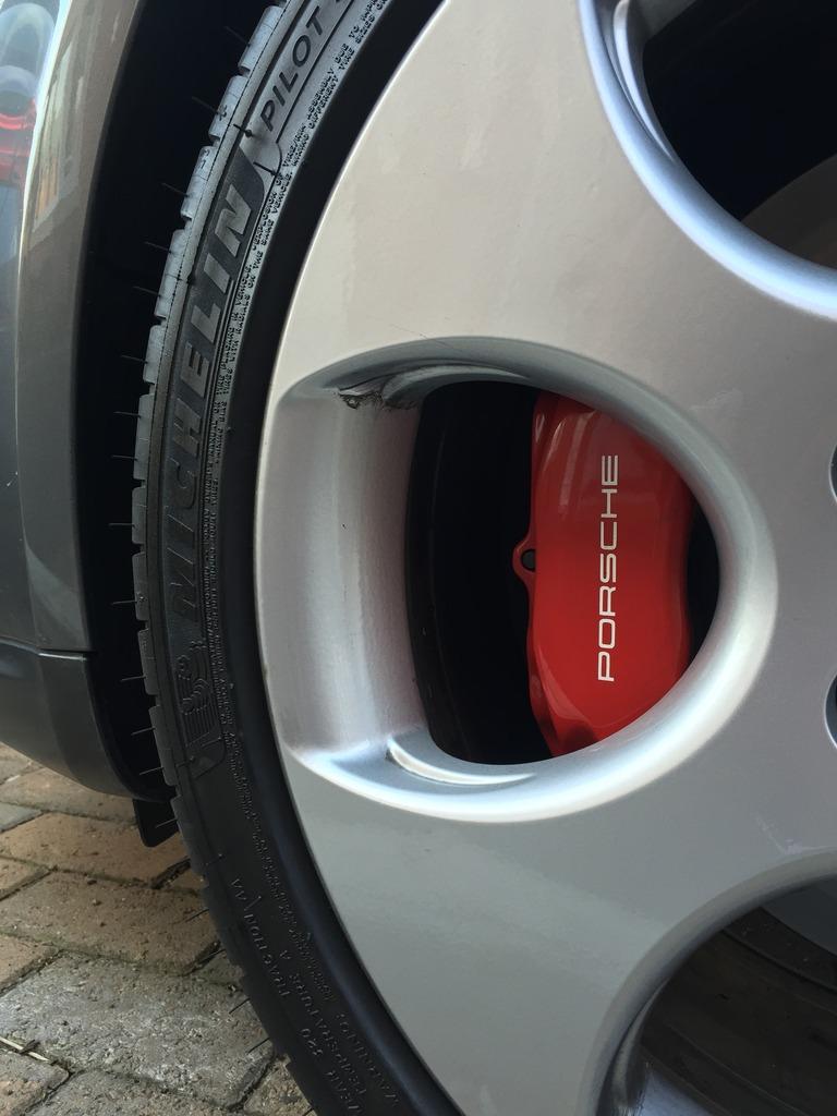

Offline daz_rt_04
  • Posts: 29
Re: NQS BBK A Not Quite So Big Brake Kit..NQS Rear mods now.....
« Reply #967 on: July 31, 2016, 06:54:13 pm »
Just finished fitting my front NQSBBK.
Mines soley road car, I used Brembo discs and Textar pads (P/N's below from ECP) and they perform really well together.
To make it easier for people, below is a complete list of the part numbers I used;
Calipers - 986.351.421 & 986.351.422 / Refurbed set via www.brakecaliperrefurbs.co.uk/
Caliper Fitting Kit - AK0002 - Vagbremtechnic
Textar Pads - 101330166 - ECP
Brembo Discs - 10444150A - ECP
Warning Wire - 99661236500 - Porsche / Or disable via vagcom (I did this)
Pad Fitting Kit x 1 - 99635195901 - Porsche
H&R 8mm Hubcentric Spacers - DPM Performance - 1655572
I didn't bother with Shims for the pads, mine do not presently squeel  :happy2:
Offline Paradox1
  • -Given: 41
  • Posts: 1038
« Reply #968 on: August 01, 2016, 10:35:50 am »
They look so fresh.
the GTI should have came with these as standard.
Im doing a BBK at the moment. was looking at the 986 calipers but at the time they were going for silly money.
Offline daz_rt_04
  • Posts: 29
« Reply #969 on: August 04, 2016, 09:59:35 pm »
They look so fresh.
For the costs, I'd definitely recommend this setup - Its not the biggest yet its a big improvement over the standard setup.
 :drinking:
