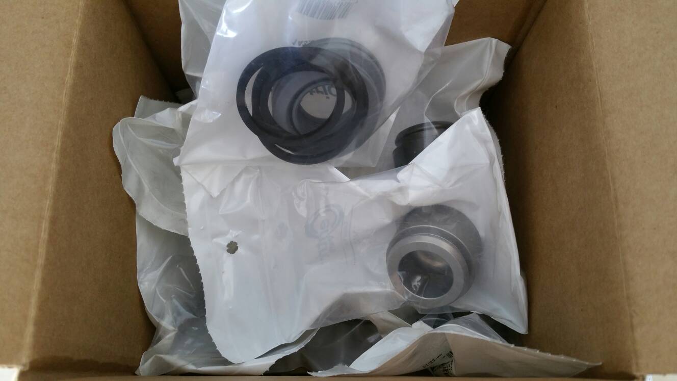

Fixed, just as of last night actually.  Took the calipers off and rebuilt them with all new pistons, seals and dust boots.  Used all new centric parts.  The old pistons didn't have any major visable scratching on them, but I did find a few tiny shavings inside the caliper themselves.
I blew them out REALLY well multiple times, lubed the hell out of the new pistons before putting them back in, etc.  Anyway, drove it to work this morning and all noises are completely gone.  I really should have done this earlier, as this noise has been driving me absolutely crazy for months.
So with about 2.5 hours of time, they are now rebuilt and noise free.  Very very happy!
Do you have the parts number for the new pistons, dust seals etc. Where did you get them? What lube did you use? I plan to do the same.

« Reply #941 on: January 26, 2016, 11:11:52 am »
I got also the centric parts
