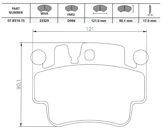

I think they mean the actual brakepad material...
Here are some specs from brembo sport pads
Milltek Catback Non Resonated - K&N panel filter with Carbonspeed, NQSBBK front, Caddy rears, CF engine cover, Bilstein B8 with Eibach Prokit, DS2500 all around
