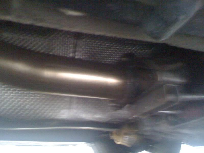

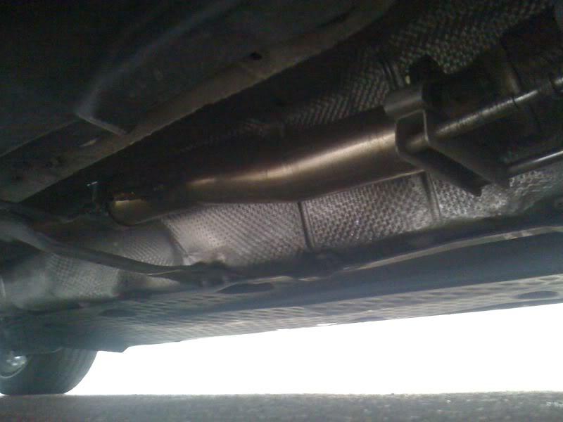

Quick iPhone snap
boy its quite loud!  :laugh:

where are the flanges??
Re: de-cat
« Reply #55 on: May 25, 2010, 09:51:22 pm »
The end towards the rear of the car doesnt have / need flanges.
It flanged just above the exhaust bracket near where the flexi is.  Ill get a better pic soon as I get chance.
Infact will prob be on the ramps at statlers soon so will get a snap then.   :happy2:
Sorry for the poor pics didnt have any light
