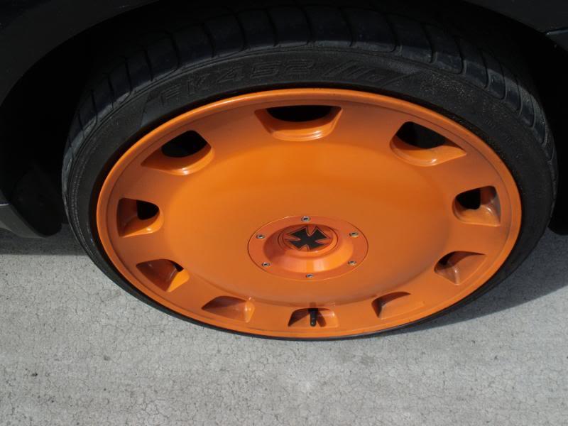

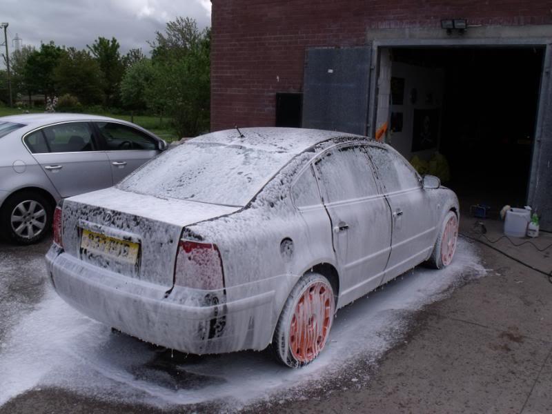

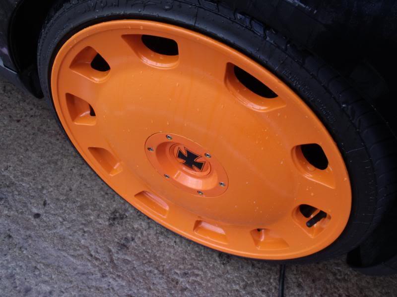

First up was the wheels, these were sprayed with Billberry through a foaming head at 10:1, this was worked in with a swissvax detail brush then power rinsed off leaving this
next up was the rest of the car, this was rinsed with the karcher then foamed with Megs shampoo plus, while this was working away i went round the window seal, grilles and badges etc.

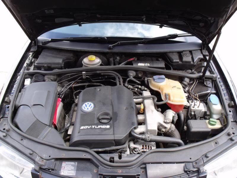

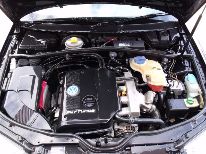

The engine bay was done with megs APC and De-greaser as was the door shuts etc...
Before
after

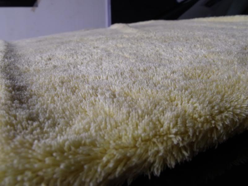

Car was then ried with a poorboys ultra plush drying towel

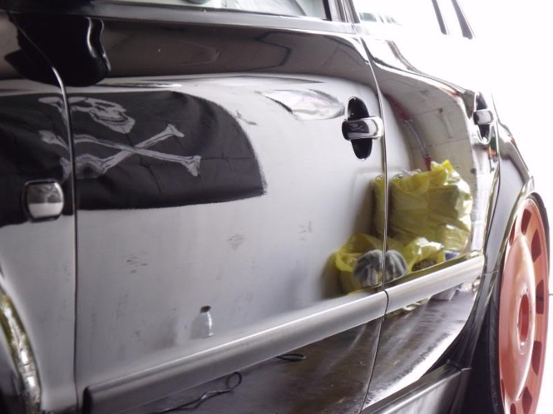

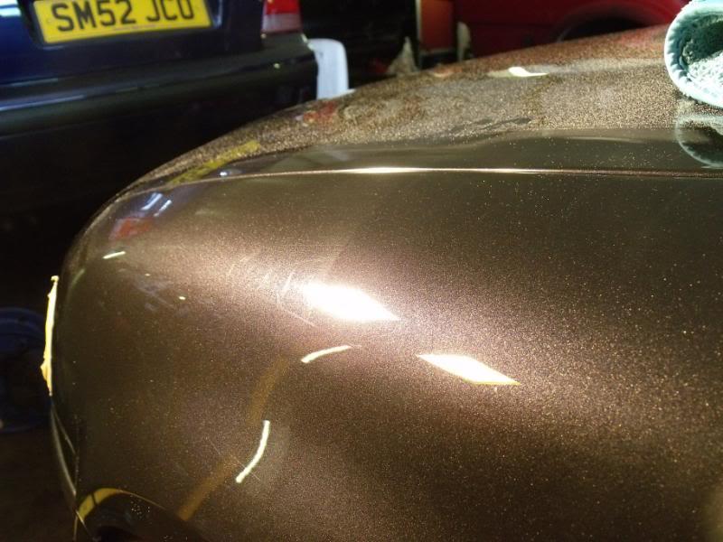

once the car was dried it was taped up read for the correction stage, this was carried out with a gloss it green pad and megs #105 and #205
The car was then done with Megs #80 on a 3M gloss enhancing pad.

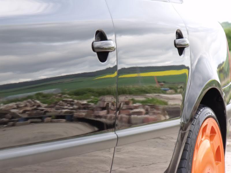

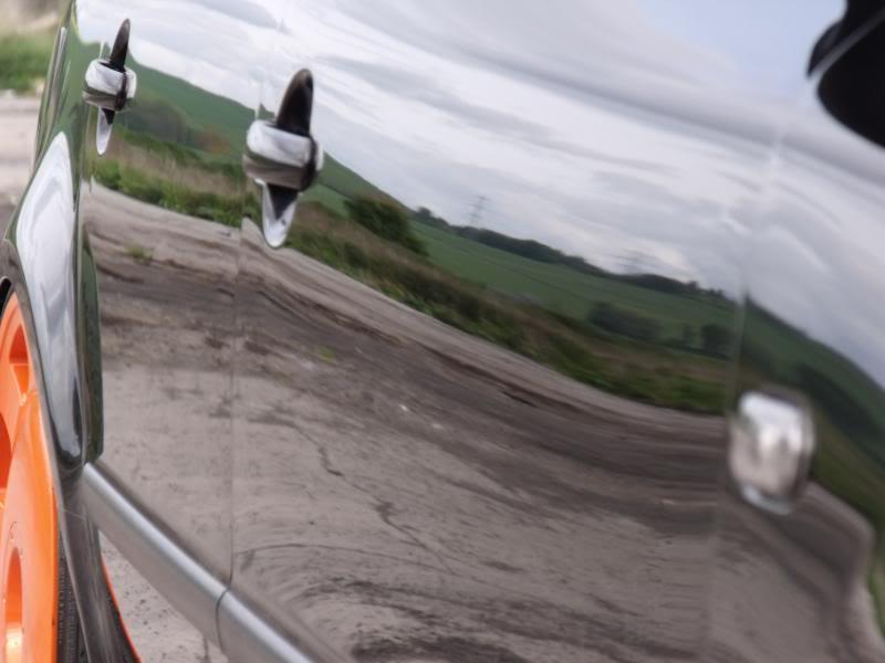

A few pics from the corection stage.....

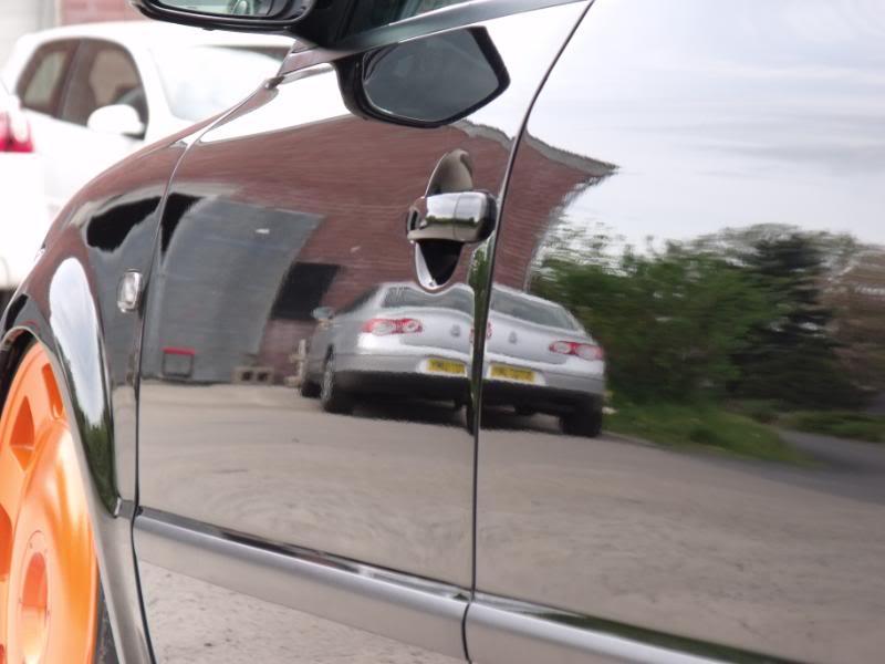

After this the car was then taken outside and given a foam and a rinse to get rid of polish dust etc and then dryed again. The paintwork was then treated with Victorias concours wax, whle this was curing, the plastic trims and tyres were dressed woth Megs trim gel and CG new look trim gel.
Wax was then buffed off with deep pile eurow towels and the glass done with AG fast glass.

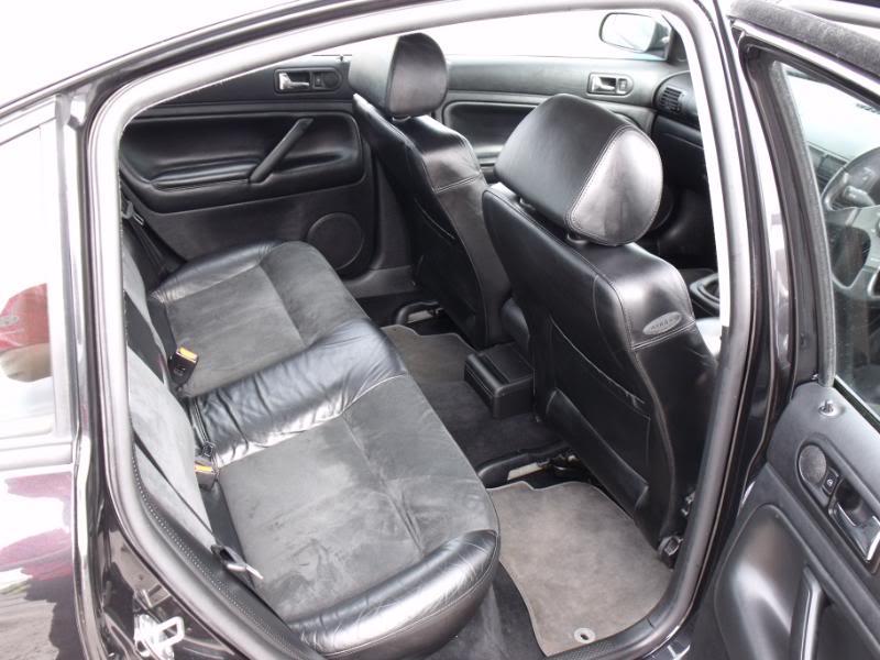

The interior was hovered out with henry the hover, all plastics etc were wiped down with megs APC and leather dressed with AG leather care.
Car was given a final wipe down with Zaino Z-8 to leave this.....
